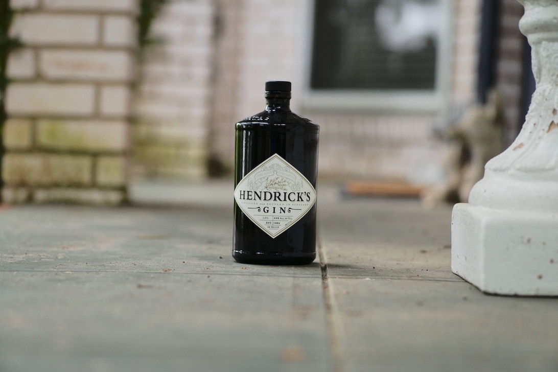

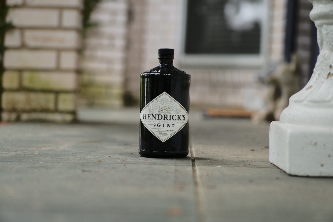

Sorry, hope I'm not hijacking the thread here.  My M10-P displays similar characteristics to the OP, where one shot is sharp and the next is not - I think it's simply me not being great with RF focussing.... so I've just tried this with my M10-P & Summicron 50mm f2.
Attached is a RF focus & Live view focus image.  No processing/sharpening etc done on the image, simply re-sized to 2000 long on PS.
I'd be interested to know if this is as one would expect from f2 Summicron wide open at 6' (checked the lens scale and it showed 6 feet).

Hi Erniethemilk,
Based on the shots above I would say that your camera and lens are spot on.
The trick with rangefinder focusing is don't go back and forth too much, your eye gets tired quickly and you start second guessing yourself. Simply bring the 2 images together and stop.

Thanks for the quick reply... that's great to hear! So, I definitely need to work harder on the manual focussing :)

I did essentially the same test this morning with the bottle 6 ft from the frame line on the camera.  First pic with lens "focused" via the rangefinder, 2nd pic with lens set at 6 ft and the third using live view/peak focusing.  In the originals (not downsized for the site), the live view is sharp enough to cut yourself on!  In these three posted images there is not much difference but at actual size from the camera there is a noticeable difference in each - rangefinder is a bit soft, 6 ft setting on lens is sharper, Live view is brutally sharp!

So the issue you were apparently missing, at least with LV, was careful execution. Good to know the sensor isn’t misaligned, or some other dramatic problem with body or lens.
