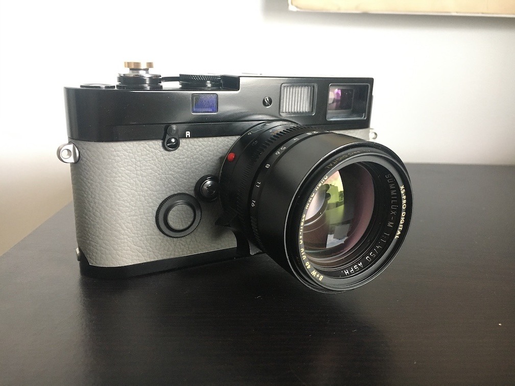

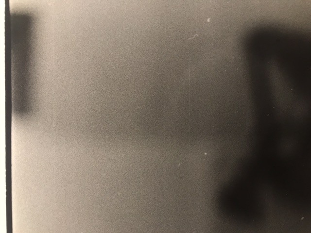

tjxism Posted February 9, 2020 Share #1 Posted February 9, 2020 Advertisement (gone after registration) So much for “Mechanism Perfection”… My brand new MP scratches the negatives… Scratches at the same locations on different stock rolls developed by different labs. I even winded a few slides and cut them out unprocessed, same marks. Also the rangefinder patch can’t align at infinity. The camera is the final batch of a la carte “no logo”, manufactures in mid 2019. I’ve owned Q, M240, SL, M10, all lived up to the name of Leica quality. Although the M10 back button was a bit sticky, I didn’t complain. I’m not a picky customer Maybe Leica is more focused on their digital bodies now? Yes it’s under warranty and I can get it serviced, but who knows how long will that take… Welcome, dear visitor! As registered member you'd see an image here… Simply register for free here – We are always happy to welcome new members! Quote Link to post Share on other sites Simply register for free here – We are always happy to welcome new members! ' data-webShareUrl='https://www.l-camera-forum.com/topic/306263-no-more-mechanism-perfection%E2%80%A6/?do=findComment&comment=3909064'>More sharing options...

tjxism Posted February 9, 2020 Author Share #4 Posted February 9, 2020 2 hours ago, shirubadanieru said: I’ve owned all Leica film bodies (minus M5), and gotta say that the only problems that i ever had were all with the new cameras...the MP I owned had a lot of dust entering the viewfinder even after only a week of using it after Leica cleaned it for me... another one had a sticky shutter...so in the end what I did was sell those two cameras and get back to the golden age of Leica cameras; I decided to get an M4, but both the M2 / M3 that I had never gave me any issues. Hope your camera gets better, but if it doesn’t you might consider doing the same Who would have known:) I chose brand new MP cuz I trust Leica QC more than a random second hand seller, but... probably Leica isn’t expecting people to really use their new MPs these days. Quote Link to post Share on other sites More sharing options...

delta100 Posted February 9, 2020 Share #6 Posted February 9, 2020 Some years ago now my brand new MP had the same problem of scratching. You have to find out if its the Lab or the camera. Load a film into the MP you don't even need a lens. Run the film through the camera a then rewind stopping just before the film goes all the way into the cassette. Pull the film out and look at the cell and emulsion sides of the film. It could be the cassette side of the camera it is well documented on this web site under MP film scratching. The scratching on my MP was due to the four screws on the back press plate. I now have a screw less plate fitted by Leica Germany - it fixed the problem! Good luck. 2 Quote Link to post Share on other sites More sharing options...

TomB_tx Posted February 9, 2020 Share #8 Posted February 9, 2020 In the 1960s it wasn't unheard of for a new camera to scratch film; nearly always from slight burrs on the pressure plate scratching the back of the film. We kept a flat 30,000 honing (polishing) store to buff the plate. A couple of wipes would cure it. 1 Quote Link to post Share on other sites More sharing options...

a.noctilux Posted February 10, 2020 Share #12 Posted February 10, 2020 (edited) When I had MPs, sometimes after hard use, I saw bits of "dust or sand" in the multiple holes of pressure plate, MP has new design (nice to look at 😉 ) pressure plate : Welcome, dear visitor! As registered member you'd see an image here… Simply register for free here – We are always happy to welcome new members! images from mir.com From M3 to M6, pressure plates are smooth, no screw holes to be "filled with bits" to scratch films image from this site Edited February 10, 2020 by a.noctilux 1 1 1 Quote Link to post Share on other sites Simply register for free here – We are always happy to welcome new members! images from mir.com From M3 to M6, pressure plates are smooth, no screw holes to be "filled with bits" to scratch films image from this site ' data-webShareUrl='https://www.l-camera-forum.com/topic/306263-no-more-mechanism-perfection%E2%80%A6/?do=findComment&comment=3910132'>More sharing options...

a.noctilux Posted February 10, 2020 Share #14 Posted February 10, 2020 33 minutes ago, tjxism said: This is interesting to know. Why did LEICA make the change? Per delta100 mentioned above, older screwless plates can be swapped on MP body. Exposed 4 screws aren’t that pretty ;) I don't know why Leica changed the pressure plate, here in MP. Long time ago, M3 nice glass pressure plate exchanged to metallic ones for electrostatic generated by the glass + moving film. For practical aspect, I've done simple and it took me less than one minute for MP, while changing film, just once in a while, toothbrushed the pressure plate. Even on my two 2014's M-A, the pressure plates changed, no more multiple "esthetic" holes, but remain the four screws holes. Quote Link to post Share on other sites More sharing options...
