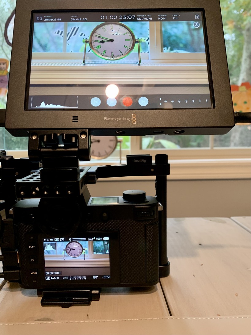

Mdol Posted August 15, 2020 Share #13 Posted August 15, 2020 I use a V-mount battery with a usb-c and D-tap output to power my SL2 together with a SmallHD 503 Monitor and a Tilta Nucleus follow focus on a LockCircle cage. 1 Quote Link to post Share on other sites More sharing options...

Mdol Posted August 17, 2020 Share #16 Posted August 17, 2020 On 8/15/2020 at 10:06 PM, Melampus said: Sounds cool - could you show us a picture of your setup? Thanks. Cheers, -Peter Welcome, dear visitor! As registered member you'd see an image here… Simply register for free here – We are always happy to welcome new members! 1 Quote Link to post Share on other sites Simply register for free here – We are always happy to welcome new members! ' data-webShareUrl='https://www.l-camera-forum.com/topic/306259-power-bank-for-sl2/?do=findComment&comment=4028590'>More sharing options...
Melampus Posted August 17, 2020 Share #17 Posted August 17, 2020 Thanks for posting those Mdol - very impressive rig. I'm curious, which V-mount battery are you using? Can you run the SL2 from it (as opposed to just charge the battery)? It was my understanding that in order to run the camera you need USB-C PD (Power delivery). I'm not aware of any V-mount batteries that does that, but could be wrong. Thanks again and cheers, -Peter Quote Link to post Share on other sites More sharing options...
Mdol Posted August 17, 2020 Share #18 Posted August 17, 2020 (edited) 1 hour ago, Melampus said: which V-mount battery are you using? Can you run the SL2 from it (as opposed to just charge the battery)? https://www.fxlion.net/product-detail/50wh-v-mount-battery-nano-one/ yes It’s possible to drag power. But that’s very unstable. Sometimes it works, sometimes not. I have to reset the camera and sometimes it helps. I have the same issue with a mophie powerbank. It’s more stable but not reliable. it seems that the SL2 has a too much sensitive voltage measure, or my SL2 copy has an issue. you can see the little plug icon near battery icon : Welcome, dear visitor! As registered member you'd see an image here… Simply register for free here – We are always happy to welcome new members! Edited August 17, 2020 by Mdol Quote Link to post Share on other sites Simply register for free here – We are always happy to welcome new members! ' data-webShareUrl='https://www.l-camera-forum.com/topic/306259-power-bank-for-sl2/?do=findComment&comment=4028773'>More sharing options...
Melampus Posted August 17, 2020 Share #19 Posted August 17, 2020 Thanks - I don't think it's your camera, see the post above from Scott (Feb 13th). Your LockCircle cage is very nice, I'm tempted to pull the trigger - any problems/issues with it? Cheers, -Peter Quote Link to post Share on other sites More sharing options...
Mdol Posted August 17, 2020 Share #20 Posted August 17, 2020 Hi, This cage is very good. Very light and it's tight with the Leica. You have to be careful when you mount the camera in it, because there is not a lot of space and you could damage the paint (if you care about that). Otherwise, I'm not a big fan of the coupling plate system (between the cage and the support of the rods), but it works well. The rods are fine and also very light. You can also support the L to PL-mount adapter on it, which is great. If you need a cage for your SL2, I think this is the one. If for photo only, the RRS L-plate is the solution, IMHO. Do you do video ? I think the SL2 is an underrated camera about video. Images are so smooth, sharp but soft and pleasant (lenses has their role in it...). Cheers, Marcello 2 1 Quote Link to post Share on other sites More sharing options...
