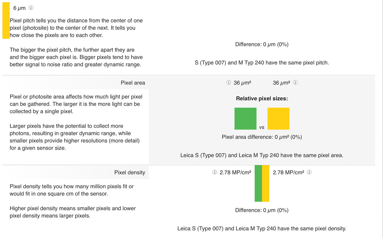

Am 18.1.2020 um 21:43 schrieb nicci78:
They are not different sensors. They are exactly the same, cut down into different size.
Leica has done this since the M 240. The Leica Max 24MP is a cut down version of Leica S (typ 007) 37.5MP sensor. Same tech, different cut size. But huge scale economy for Leica, because nobody made 37.5MP or 65MP 45x30 sensor. And Leica did not seem to sell tons of S cameras.
Son of a gun, you're right, S 007 and M 240 use the same per-pixel architecture.
https://www.digicamdb.com/compare/leica_s-type-007-vs-leica_m-typ-240/
