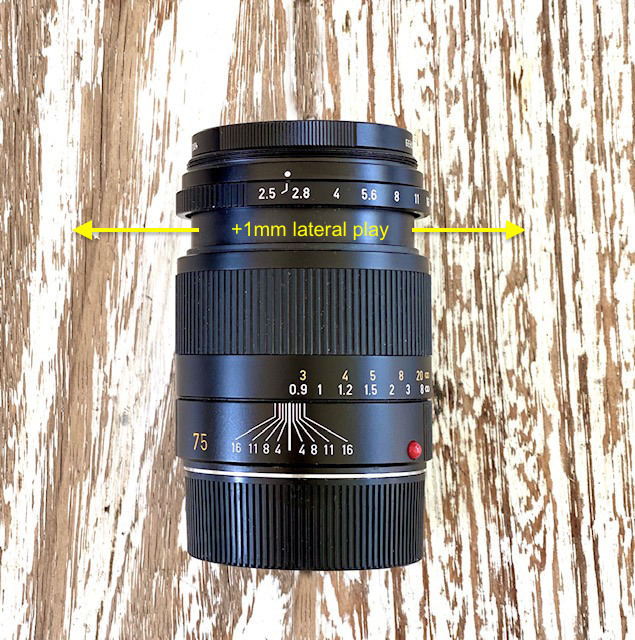

Amongst a collection of 11 M lenses, Summiluxes, Summicrons, Elmarits and vintage f1.5 Summarit, I have 2 modern Summarits, a 35mm f2.5 and a 75mm f2.5. I like their image rendering, especially on the Monochrom.
My issue with these 2 lenses is build quality, they both suffer from loose/rattling lens barrels. Don't know if this has been addressed in the newer f2.4 versions.

In a collection of  19  M, R, TL & SL lenses, the only 2 Leica lenses that I've had an issue with build quality are the 2 Summarits. It's a common complaint with the modern f2.5 Summarits, I have no experience with the f2.4 vers.
There's lateral movement of the focusing barrel, it doesn't affect IQ, fact is there shouldn't be that kind of movement and rattling.
+1:  exactly the same on my 75 2,5 : fixed with success 3 years ago (for free), now the play is quietly re-appearing… as above said, not a great issue… but I keep my opinion that is not such a smart design… :huh: and I'm mot an high workload photographer… why my Summilux 50 of 1963 (just an example) is still so rock solid ?   B)
