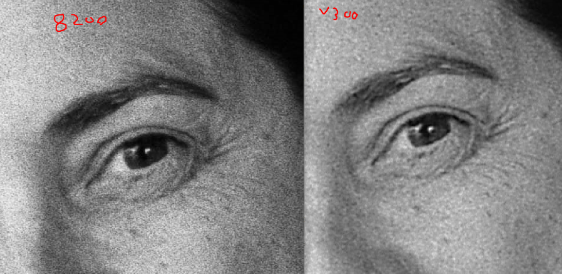

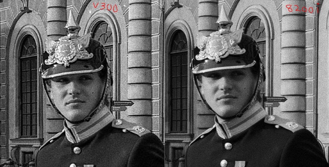

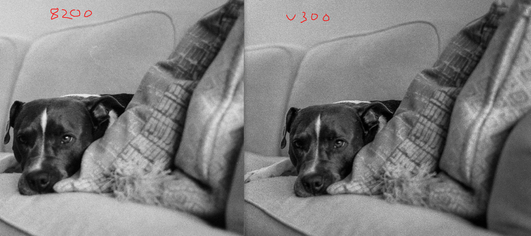

The 35mm scan quality from the inexpensive plustek units is extremely good. The downside is that the scanning process is much slower and laborious than with a DSLR/mirrorless camera. The opticfilm 120 should on paper be far better, automating the scanning to some extent. But it is expensive and early units had a reputation for unreliability. I have no idea if this has been fixed.
9 hours ago, Stealth3kpl said:
That was a great decision. I have the 8100 and I think it's a wonderful thing. I use it with Vuescan when scanning B+W.
