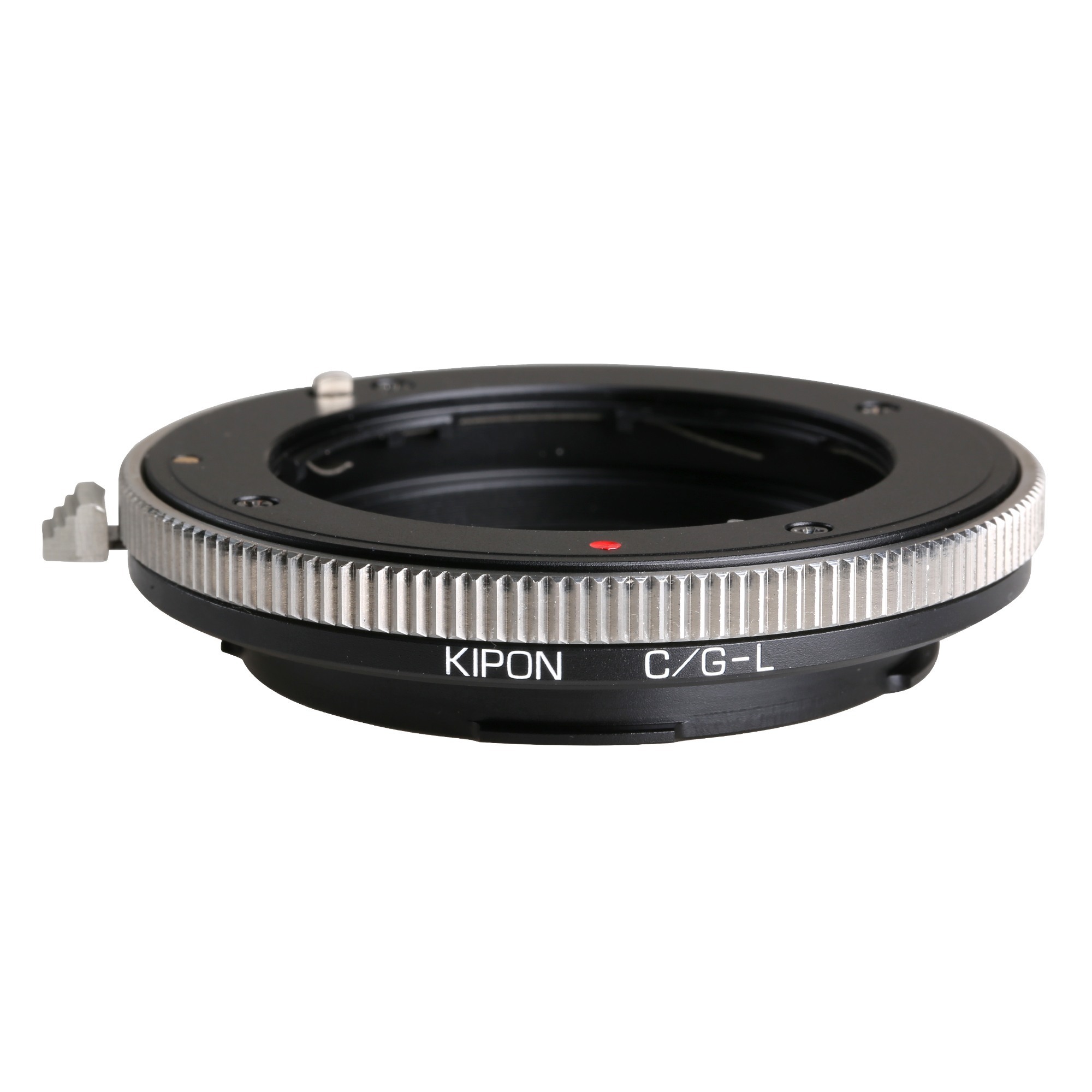

I received the adapter and very pleased with it. It works on both the SL2 as well as the CL.
I have 3 Contax G lenses: 90mm Sonnar, 45mm Planar & 28mm Biogon.
90mm f2.8 Sonnar & 45mm f2 Planar - Both of these lenses work seamlessly on the SL2 & CL. Focus is smooth and aperture clicks nicely into place. IQ is excellent- see next post.

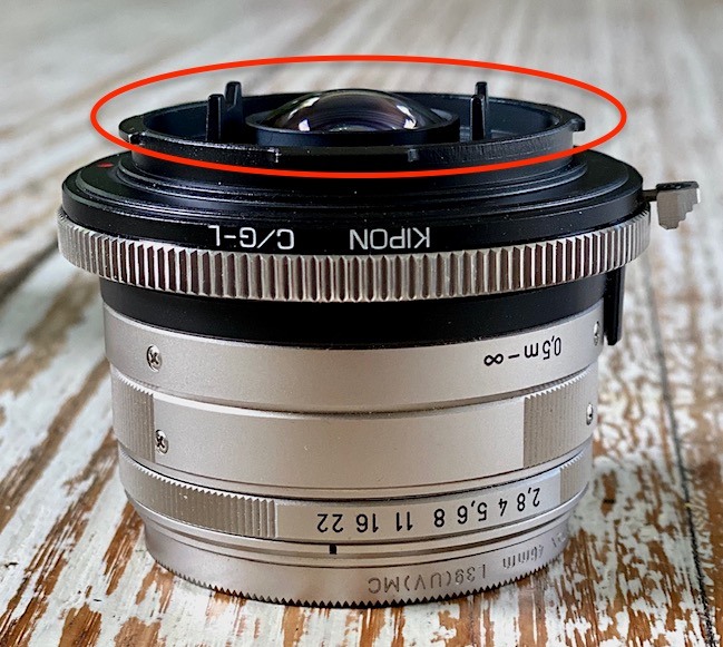

28mm f2.8 Biogon - doesn't fit on either camera. The tabs on the rear of the lens and the rear element of the lens, protrude past the adapter and bump up against the mount chamber.
In terms of removing the lens, I noticed that you have to set the aperture to between f8 & f11 in order to remove the lens from the adapter. You'll notice that f8 to f11 are the default setting on the lens when it's removed.

I am glad this has proved so useful. I have just tried the 45mm and 90mm on my CL again and they do indeed work so I have no idea why my first attempt failed, not careful enough probably,  I am just delighted to be proved wrong! It does seem to be the case that the 21m and 28mm can't work because the lens prongs are too long and knock up against the throat inside the CL. I wonder if they could be trimmed without damaging anything - I'm not the one to risk it.

........... It does seem to be the case that the 21m and 28mm can't work because the lens prongs are too long and knock up against the throat inside the CL. I wonder if they could be trimmed without damaging anything - I'm not the one to risk it......
Hi Nick, I was also thinking of trimming the tabs at the back of the lens.  However I suspect that's only 1/2  the problem, the rear lens element also seems to stick out past the rear of the adapter. I'm concerned about how close this element gets to the camera's sensor.
