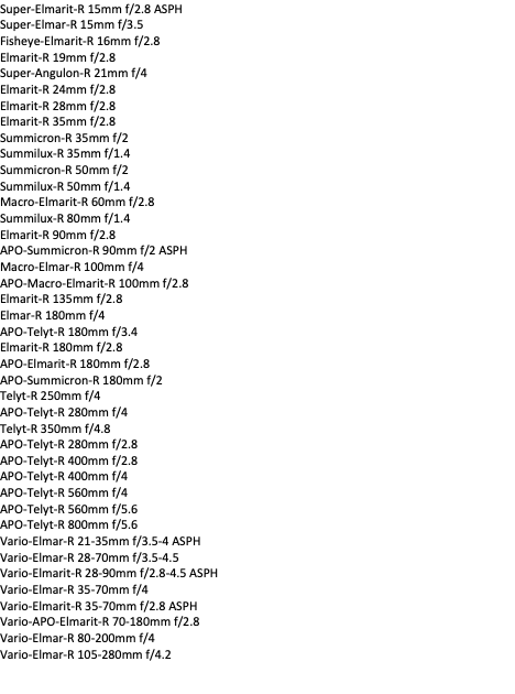

I've gathered that the Leica R-SL adapter works with these lenses:
Which of these would be desirable lenses for the SL2 especially in the medium-long telephoto range?
If you want to extend your lens, the very fine 2x APO extender usually sells on ebay for ~$500-600 in good condition.
