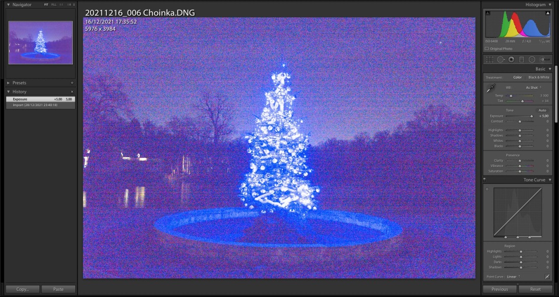

adan Posted January 24, 2020 Share #55 Posted January 24, 2020 (edited) Bottom line. I was able to reveal spots/blobs like Fallancer's, from an original underexposure about like his. With my original 3-year-old M10. See right side of adjusted (bluish) image. The picture was exposed at 1/1000 and f/16 (manually) - the meter called for 1/12 at f/16 (both at ISO set to 10000) Do you know what it took? An 6.5-stop underexposure. That is, trying to get an effective ISO of 500000 (from an actual ISO setting of 10000, plus post-processing corrections of 6.5 stops). Let's all go to our M10 manuals. Can anyone find a page anywhere that says the M10 can be used at, or pushed to, ISO 500 thousand? Fallancer, I'm sorry, but if you screw up the exposure by 6.5 stops, (especially from an already-high ISO) that is not Leica's responsibility, and you should count yourself lucky they already gave you one new camera. Learn to use the light meter correctly, and give the sensor enough light. Do not try to rescue the image in post-processing beyond a total ISO of 50000 (i.e. if you set 6400 on the camera, no more than 4 additional stops in LR or Photoshop). Welcome, dear visitor! As registered member you'd see an image here… Simply register for free here – We are always happy to welcome new members! BTW, here is the same scene - correctly metered and exposed for ISO 10000. Edited January 24, 2020 by adan 4 2 Quote Link to post Share on other sites Simply register for free here – We are always happy to welcome new members! BTW, here is the same scene - correctly metered and exposed for ISO 10000. ' data-webShareUrl='https://www.l-camera-forum.com/topic/304954-new-m10-p-mysterious-stains/?do=findComment&comment=3898194'>More sharing options...
BJohn Posted January 24, 2020 Share #56 Posted January 24, 2020 3 hours ago, adan said: ... Do not try to rescue the image in post-processing beyond a total ISO of 50000 (i.e. if you set 6400 on the camera, no more than 4 additional stops in LR or Photoshop). Wow thanks for your very detailed explanation! I think everybody should calm down. Nonetheless, my M10 showed these spots on lower ISO values sometimes without pushing them too hard in post. That was btw the case during which I identified these sports at first. I sent the camera in, they confirmed the issue, I got a new model back. This new model still shows "sometimes" those spots if I push too hard in the post. At least in my case this is now acceptable. Quote Link to post Share on other sites More sharing options...
