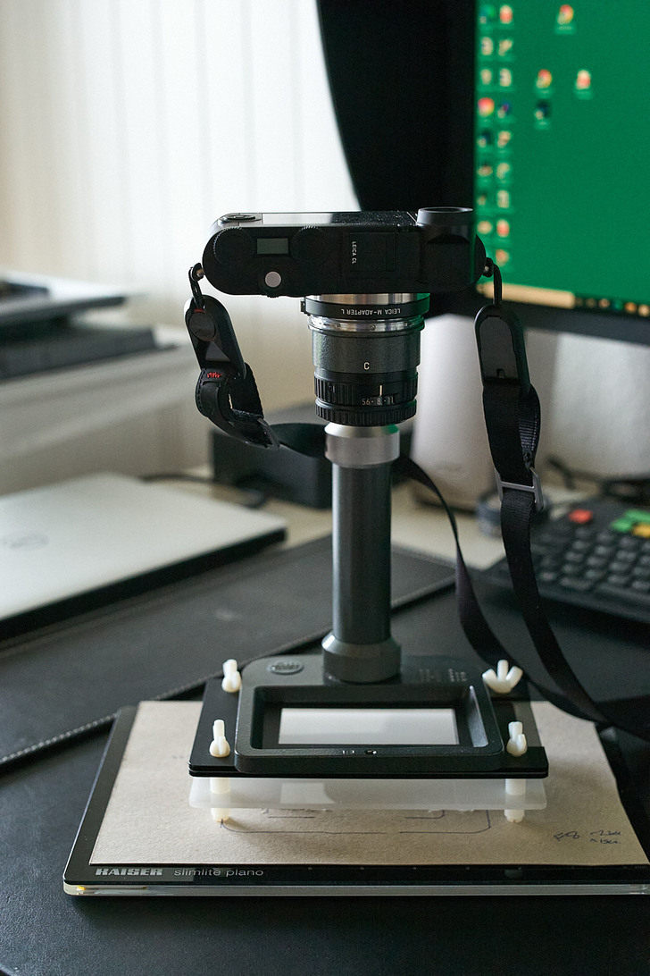

Phil_P Posted October 9, 2020 Share #71 Posted October 9, 2020 Having played around with trial and a lot of error am finally setup for 6*6 The advantage for me with the Beoon is it is tiny and easy to store and get out of a cupboard without fuss. Using a CL camera with just the C tube on a Leica Beoon with an El Nikkor 40mm lens. This just (very snugly!) sits on top of a 120 'Essential Film Holder' from Clifforth in the uk which seems very good. https://clifforth.co.uk/ This is placed on top of a Kaiser Slimlite Piano light panel. Wanted to run a first trial sample 6*6 film to quickly process and test ...sorry it's a cat photo! One tip for anyone using a CL and the self timer.... tape over the flashing light I didn't know existed on the front to signify timer in progress...spent hours thinking I had some sort of burn marks on the negative/stray light in camera! (Hasselblad with 80mm CFE & Ilford Delta 100) Welcome, dear visitor! As registered member you'd see an image here… Simply register for free here – We are always happy to welcome new members! 4 Quote Link to post Share on other sites Simply register for free here – We are always happy to welcome new members! ' data-webShareUrl='https://www.l-camera-forum.com/topic/304421-scanning-6x6-hasselblad/?do=findComment&comment=4059880'>More sharing options...
jonnyboy Posted October 9, 2020 Author Share #72 Posted October 9, 2020 1 hour ago, Phil_P said: Having played around with trial and a lot of error am finally setup for 6*6 The advantage for me with the Beoon is it is tiny and easy to store and get out of a cupboard without fuss. Using a CL camera with just the C tube on a Leica Beoon with an El Nikkor 40mm lens. This just (very snugly!) sits on top of a 120 'Essential Film Holder' from Clifforth in the uk which seems very good. https://clifforth.co.uk/ This is placed on top of a Kaiser Slimlite Piano light panel. Wanted to run a first trial sample 6*6 film to quickly process and test ...sorry it's a cat photo! One tip for anyone using a CL and the self timer.... tape over the flashing light I didn't know existed on the front to signify timer in progress...spent hours thinking I had some sort of burn marks on the negative/stray light in camera! (Hasselblad with 80mm CFE & Ilford Delta 100) Welcome, dear visitor! As registered member you'd see an image here… Simply register for free here – We are always happy to welcome new members! Nice setup and wow gorgeous scan!! so good! I like the idea to have something not too big but I'm using a Sony A7III with Canon 100MM Macro to scan and there may not be enough distance between the lens and the film. 1 Quote Link to post Share on other sites More sharing options...
