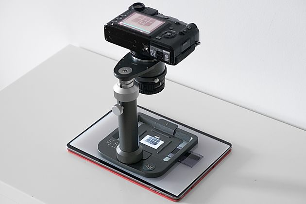

Leica Beoom! Im wondering if anyone in here ever used it - I would like to attach my Sony A7iii to it - will it work?
From google research it seems to have a Leica mount so it definitely need either a Leica body with conversion or a Leica lens with conversion?
I use a BEOON for all of my 35mm film scanning. To use it as designed it needs a full frame Leica (or compatible) body and a 50mm Leica (or compatible) camera lens. The A7iii will work fine with a Leica M adapter or with a Leica M adapter plus an M to LTM adapter. The body and lens must both be M mount or both be LTM mount. (There is a dedicated M to LTM adapter as part of the BEOON that attaches either above or below the arm supporting the camera and lens.)
The BEOON includes a dedicated loupe for focusing the camera, but a live view camera will make things a lot easier.
Some other arrangements can be made to work if everything is M mount or LTM mount, but there are no guaranties. (I use an APSC Fuji X-T20 with Fuji/M and M/LTM adapters with a 50mm Schneider Componon enlarging lens and a 40mm extension tube.)
