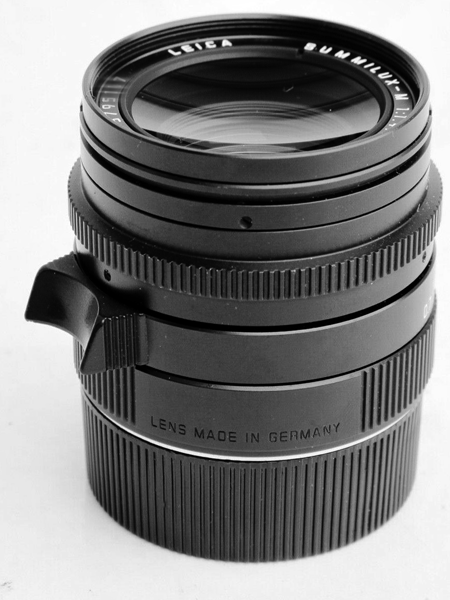

My Summilux 35 mm Asph is a previous version, the one before FLE, is it version 4?
No.
Among the 35 mm M lenses, yours is the first Summilux Asph version, the second aspherical Summilux version, or the third Summilux version.
The 35mm Summilux-M ASPH is a completely different lens from its predecessors. It cannot be called "v.3" - unless one would also call a 2020 Ford Focus a "Ford Model T - v.32"
You have v.1 of the 35mm Summilux-M ASPH.
You are correct that the focus tab is attached with internal screws. It requires significant disassembly of the lens to reach the screws and remove the tab. And to put it back on. Leica (or other competent technicians) can do both, for a price.
Not sure to follow here. If you have a 35/1.4 asph v1 (11874, 11883 or 11859), it doesn't have an indented focus ring. How do you plan to rotate that ring w/o tab then? Just curious.
Edited by lct
Yes it looked the same, it was in my hand in this post.
