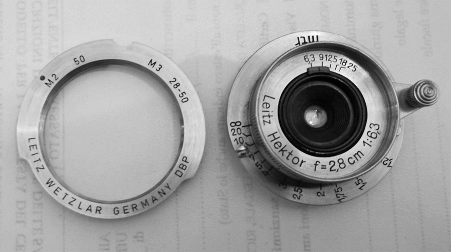

Erato Posted April 8, 2020 Share #7 Posted April 8, 2020 (edited) Advertisement (gone after registration) On 8/30/2019 at 1:36 AM, luigi bertolotti said: OK, all clear now… probably it was used on a M3 , with external viewfinder : with that Leitz adapter (28-50) the 35mm frame is not activated in the VF of the M Leica which provide it (M2 M4 and over) . Which adapter you used for the Hektor 28mm f6,3? Many thanks. Edited April 8, 2020 by Erato Quote Link to post Share on other sites More sharing options...
luigi bertolotti Posted April 8, 2020 Share #8 Posted April 8, 2020 (edited) 4 hours ago, Erato said: Which adapter you used for the Hektor 28mm f6,3? Many thanks. This one (old original, with cutout) proved to be well usable : focus knob moves smoothly and clicks at the infinity block : of course, no 6 bit codable Welcome, dear visitor! As registered member you'd see an image here… Simply register for free here – We are always happy to welcome new members! Edited April 8, 2020 by luigi bertolotti 1 Quote Link to post Share on other sites Simply register for free here – We are always happy to welcome new members! ' data-webShareUrl='https://www.l-camera-forum.com/topic/300777-rodenstock-heligon-35mm-f28-a-m-mount/?do=findComment&comment=3949839'>More sharing options...

Jul Posted April 9, 2020 Share #11 Posted April 9, 2020 (edited) 14 hours ago, luigi bertolotti said: This one (old original, with cutout) proved to be well usable : focus knob moves smoothly and clicks at the infinity block : of course, no 6 bit codable In case someone wants to use this lens (the Hektor 28mm f6,3) on a body with frame lines for 28mm. The old original adapter for a 90mm lens would trigger the right frame lines. Edited April 9, 2020 by Jul add lens name 1 Quote Link to post Share on other sites More sharing options...
wlaidlaw Posted April 9, 2020 Share #12 Posted April 9, 2020 If you want to use these older LTM lenses on modern Leica digitals with live view, like the M240, M10 etc, you will find that the Leica M3/M2 LTM to M adapter rings will give the "no lens detected" message. From experimentation I have found that the black version of the Voigtlander adapter type 2 without cut out works and the Rayqual also. Both of these are high quality and I have checked them with a micrometer. They are 100% parallel and exactly 1.00 mm thick. Wilson 2 Quote Link to post Share on other sites More sharing options...
luigi bertolotti Posted April 10, 2020 Share #13 Posted April 10, 2020 14 hours ago, wlaidlaw said: If you want to use these older LTM lenses on modern Leica digitals with live view, like the M240, M10 etc, you will find that the Leica M3/M2 LTM to M adapter rings will give the "no lens detected" message. From experimentation I have found that the black version of the Voigtlander adapter type 2 without cut out works and the Rayqual also. Both of these are high quality and I have checked them with a micrometer. They are 100% parallel and exactly 1.00 mm thick. Wilson Yes, me too have the Voigtlander, and it's really well done, : the only problem is that, having no cutout, with some old LTM lenses with focus knob, if you screw in the lens with knof engaged in the infinity lock, it cannot be de-engaged and so you cannot focus : with a lens like the hektor 28 this indeed is a no-issue... DOF is such that you can mount the lens not engaged in the infinity lock... you have free movement fron minimum focus to "next to infinity"... which in practice is infinity for a 28mm 6,3... 😉; not so true of course for a lens like the Xenon 1,5... Welcome, dear visitor! As registered member you'd see an image here… Simply register for free here – We are always happy to welcome new members! 2 Quote Link to post Share on other sites Simply register for free here – We are always happy to welcome new members! ' data-webShareUrl='https://www.l-camera-forum.com/topic/300777-rodenstock-heligon-35mm-f28-a-m-mount/?do=findComment&comment=3950721'>More sharing options...
TomB_tx Posted April 10, 2020 Share #14 Posted April 10, 2020 Rayqual makes good quality adapters that are cutout only on the "7:00" side where the infinity lock is located, with an area on the other side for paint marking a 6-bit code. Since Voigtlander quit making their adapters, CameraQuest now carries Rayqual. I assume all 28s have 7:00 infinity locks. I have an 11:00 50 Elmar and no adapter works with the lock. Welcome, dear visitor! As registered member you'd see an image here… Simply register for free here – We are always happy to welcome new members! 2 Quote Link to post Share on other sites Simply register for free here – We are always happy to welcome new members! ' data-webShareUrl='https://www.l-camera-forum.com/topic/300777-rodenstock-heligon-35mm-f28-a-m-mount/?do=findComment&comment=3950822'>More sharing options...
luigi bertolotti Posted April 10, 2020 Share #15 Posted April 10, 2020 (edited) Thanks ! That's a smart solution, indeed... the cutout is needed just to de-engage the knob pushing it a bit : once that is "free" from the lock, its pin comes back to the normal position and does not interfere with the normal-width ring, even if for just a fraction of mm. I didn't notice this variant in recent adapters. Well... only the "11 o' clock" LTM lenses still would have the issue... but I don't think many people uses them... 😎 they are all 90 years old around... (me too just have an Elmar 50 "5 digits" that is 11 o'clock...) Edited April 10, 2020 by luigi bertolotti Quote Link to post Share on other sites More sharing options...
wlaidlaw Posted April 10, 2020 Share #16 Posted April 10, 2020 (edited) Robert White carry the Rayqual adapters in the UK. Wilson PS: Like the Voigtlander rings used to come in before Voigtlander dropped them, I think the Rayqual rings also come in two flavours. With cut out and without. I have just checked and my 50/75 and 28/90 Rayqual rings both foul the infinity lock on my 1932 7 o'clock Hektor 50/2.5, as neither has a cut out. Wilson Edited April 10, 2020 by wlaidlaw Quote Link to post Share on other sites More sharing options...
