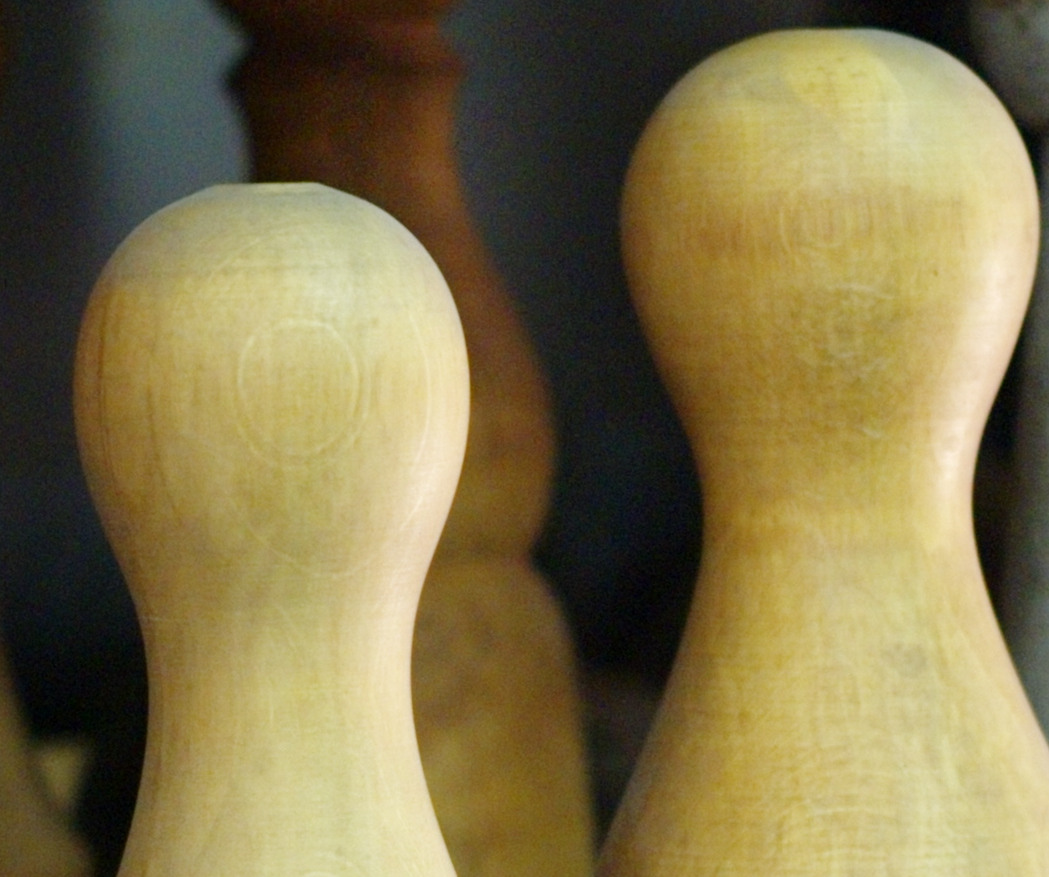

dau Posted August 24, 2019 Share #14 Posted August 24, 2019 (edited) Vorgängermodell (35mm Summarit-M 1:2.5), aus der Hand bei wenig Licht. Arbeitsblende nicht bekannt, aber offenbar ziemlich weit offen. M9, also offensichtlich nicht mit EVF. 1/4 Welcome, dear visitor! As registered member you'd see an image here… Simply register for free here – We are always happy to welcome new members! Edited August 24, 2019 by dau 1 Quote Link to post Share on other sites Simply register for free here – We are always happy to welcome new members! ' data-webShareUrl='https://www.l-camera-forum.com/topic/300629-summarit-35mm-f24-quali-bei-offenblende/?do=findComment&comment=3804824'>More sharing options...

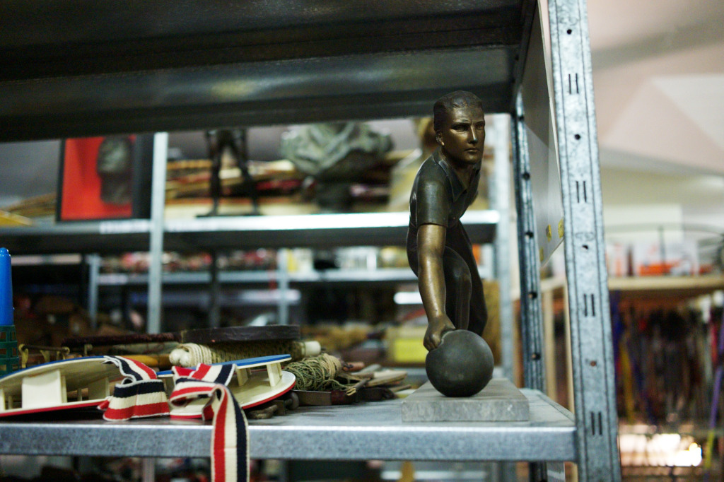

dau Posted August 24, 2019 Share #15 Posted August 24, 2019 2/4: 100% Crop Welcome, dear visitor! As registered member you'd see an image here… Simply register for free here – We are always happy to welcome new members! Quote Link to post Share on other sites Simply register for free here – We are always happy to welcome new members! ' data-webShareUrl='https://www.l-camera-forum.com/topic/300629-summarit-35mm-f24-quali-bei-offenblende/?do=findComment&comment=3804825'>More sharing options...

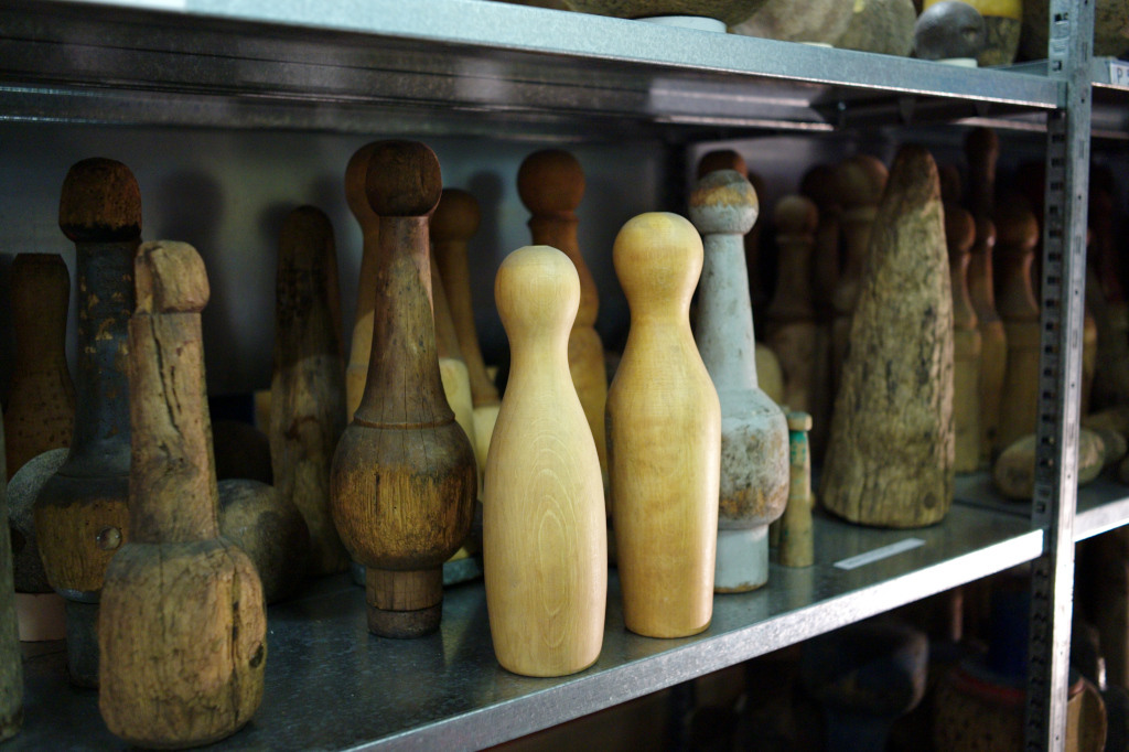

dau Posted August 24, 2019 Share #16 Posted August 24, 2019 3/4 Welcome, dear visitor! As registered member you'd see an image here… Simply register for free here – We are always happy to welcome new members! 1 Quote Link to post Share on other sites Simply register for free here – We are always happy to welcome new members! ' data-webShareUrl='https://www.l-camera-forum.com/topic/300629-summarit-35mm-f24-quali-bei-offenblende/?do=findComment&comment=3804826'>More sharing options...

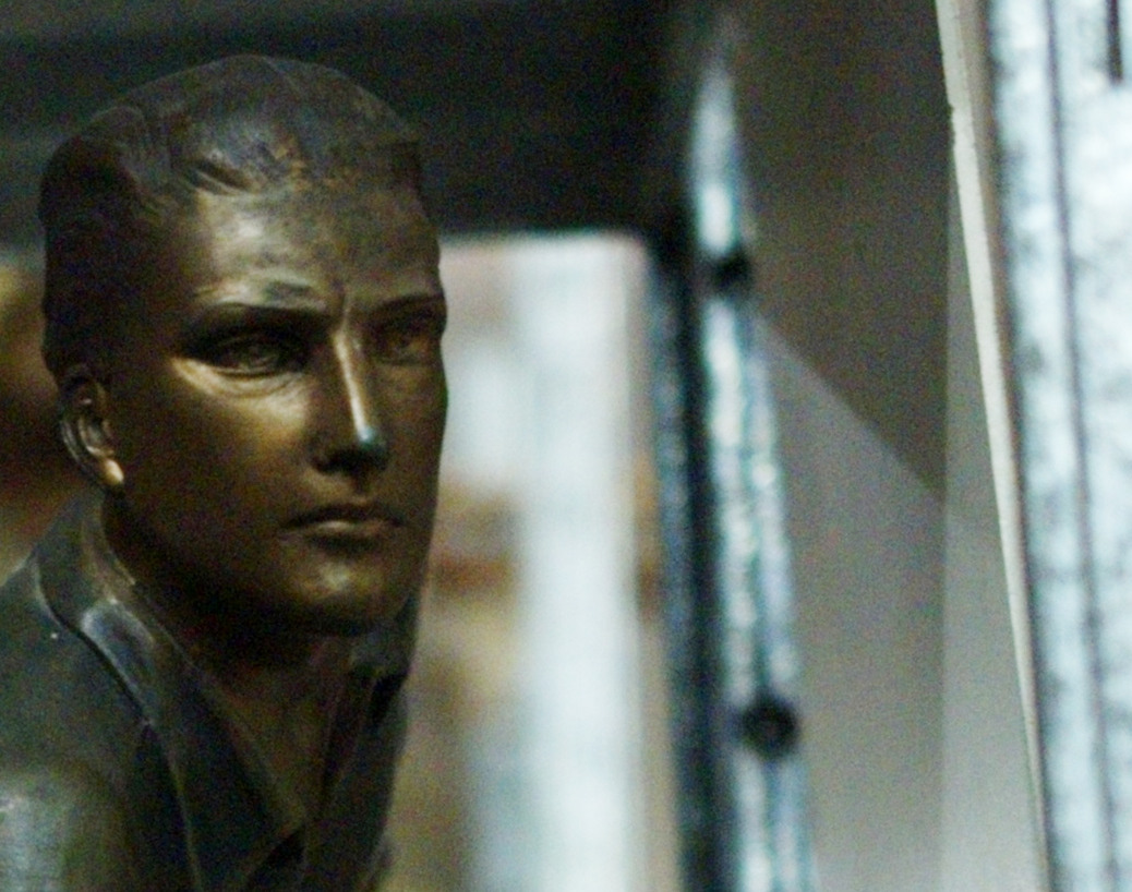

dau Posted August 24, 2019 Share #17 Posted August 24, 2019 4/4 Welcome, dear visitor! As registered member you'd see an image here… Simply register for free here – We are always happy to welcome new members! Quote Link to post Share on other sites Simply register for free here – We are always happy to welcome new members! ' data-webShareUrl='https://www.l-camera-forum.com/topic/300629-summarit-35mm-f24-quali-bei-offenblende/?do=findComment&comment=3804827'>More sharing options...
