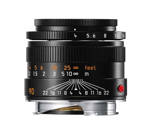

I like the visual finish of the old silver version the most. 🔴
Pic. Reference.

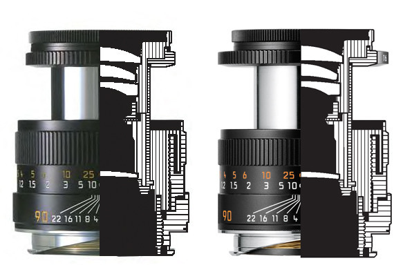

90/4 macro v1 & v2 and v2 in retracted position.
  • Thanks 2
1 hour ago, Nick_S said:
My understanding is that the optical design was unchanged between both versions. The black lens collapsed is so compact and light that it feels like having a 50mm lens in your pocket -- it is an ideal travel lens. I use mine with the short 12550 lens hood from the 50 Elmar which saves some weight and means that the lens is always ready to use without the need to reverse the large included lens hood.The chrome version is quite a bit heavier, being made of brass, though its  finish may be more robust.

No, there were no changes to the optical system. In this regard, v1 and v2 are completely identical. I bought a chrome v1 when it was still available, and love the lens.
