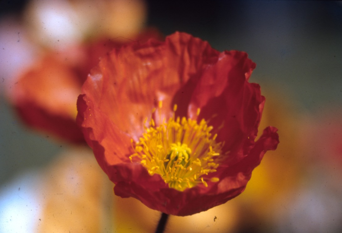

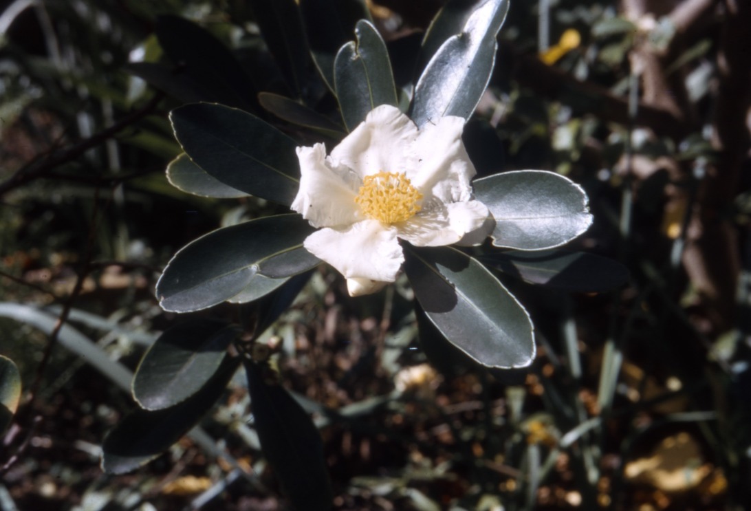

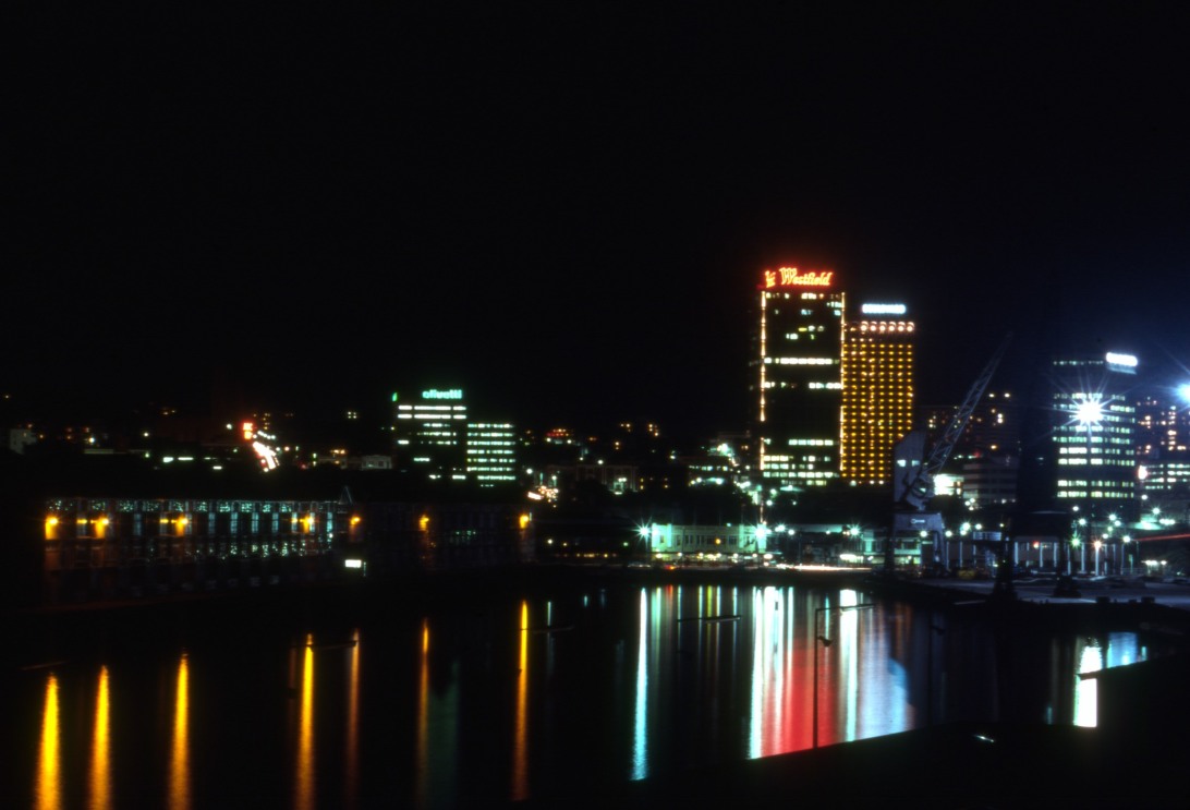

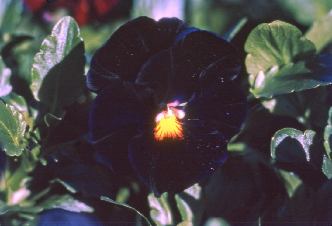

I scan my Kodachrome slides to turn them into books, diaries of trips I have been on. The idea is to have the emotional feel of the printed image that I get from the projected image. The result has to be a compromise because a projected image will have a larger gamut of tones than a printed image.Attached are some digitised image used to make the books and I feel they convey what I feel when looking at the projected slide, I also use Photoshop to clean up the image and make any changes necessary to achieve the end result. Something you could never do with a 35mm slide. Most of these were shot on an R3 around 1984 -1990. I have just found out I cannot load the other two examples.

Most were done with a Microtek ArtixScan 4000tf using Lasersoft software set to "Kodachrome" profile. Most Photoshop corrections were for Brightness of a selected area. Kodachrome's short tonal range was a real problem when you had black and white major portions in the picture. HDR is a great addition to digital imagery.
