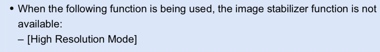

Thought this may be good to know, while attempting handheld shots in High Res mode:
I tried this and it did not go well at all even with normal shutter speeds in bright daylight. I think the camera needs to be absolutely still for it to work. The shutter speed might be high, but the lag time to take all the shots is upwards of 2 seconds, during which time the camera has to be pointing at the exact same scene....if there is any movement at all it creates severe ghosting.
Edited by Stuart Richardson
I thought it may be suitable for long exposure shots landscape shots .. but then the manual says that High Res is available for shutter speeds between 1s and 1/16000s and uses ONLY electronic shutter with min aperture of f16. Anyhow, shall try and see the results for exposures of 1s.
