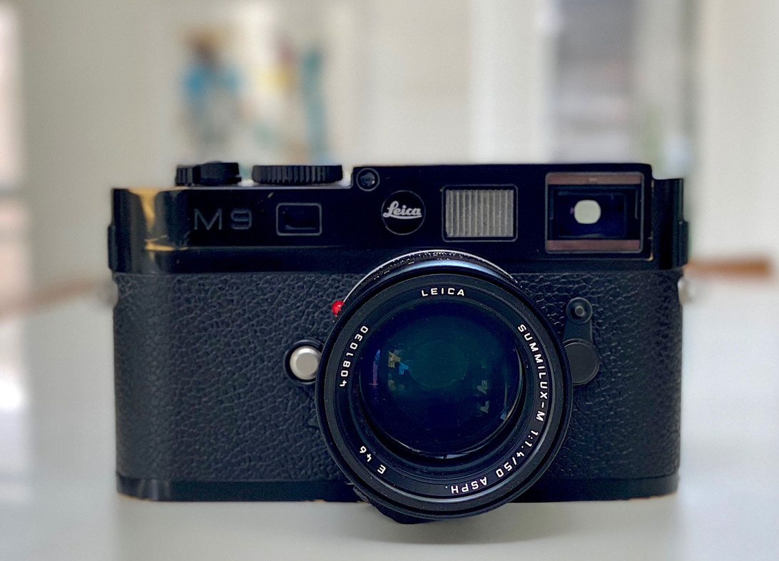

Jeff S Posted April 27, 2019 Share #7 Posted April 27, 2019 (edited) Advertisement (gone after registration) 8 hours ago, rramesh said: Once you remove it, you may have a hard time reusing it. Why not just cover it with some round tape? Tough to adjust the RF that way, as his initial post suggests. I haven’t had any issue removing or preserving red dot on two earlier models and replacing with a preferred black logo from DAG, although I decided to leave the red dot alone on my silver M10. Red dots are also easy and cheap to replace. Strictly personal aesthetic preference for me. Jeff Edited April 27, 2019 by Jeff S Quote Link to post Share on other sites More sharing options...
Rick in CO Posted April 27, 2019 Share #8 Posted April 27, 2019 Instead of a hair dryer, place the camera with the red dot centered under a lamp with a heat emitting bulb for about half an hour. Don't bake the camera by letting it get too hot, use some caution. This will evenly soften the glue allowing you to twist the dot free. Use a toothpick to get under the dot and lift it off - don't use anything metal! I have replaced the red dot on my M9, M240, M10 with the black dot using this method. Good luck! Quote Link to post Share on other sites More sharing options...
