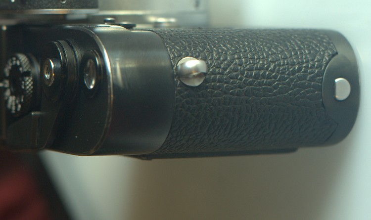

a.noctilux Posted April 6, 2019 Share #12 Posted April 6, 2019 (edited) I've seen this a while ago (14312 again ! ) but never applied the trick to one of my M. Edited April 6, 2019 by a.noctilux Quote Link to post Share on other sites More sharing options...
ckuwajima Posted April 6, 2019 Share #13 Posted April 6, 2019 (edited) 16 minutes ago, a.noctilux said: I've seen this a while ago (14312 again ! ) but never applied the trick to one of my M. I tried and did not succeed. It became too tight for the 14312 clips to go through the pen barrel. Edited April 6, 2019 by ckuwajima Quote Link to post Share on other sites More sharing options...
