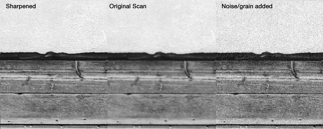

Acutance (one 'c') = "apparent or perceived sharpness." And there are a couple of mechanisms whereby increased grain equates to increased acutance, or apparent sharpness.
One is psychological and perceptual. We "think" something looks sharper, even if the actual image is fuzzy, if the grain itself is sharp-edged and clear. It gives us something to focus our eyes on.
This was observed in the completely pre-digital era - if one made a darkroom print with a superb enlarger lens, so that the grain of the negative was printed tack-sharp, even a picture made with a less-than-perfect camera lens (which included some Leica lenses, by today's standards) would be classified as a "sharp" picture, by most people. The crisp sandy grain was perceived as sharp detail and texture.
It is related to the Zeiss research in the 1960s that showed that people will think 40 lp/mm "looks" sharper than 80 lp/mm - so long as the image at 40 lp/mm has high edge contrast (what we now know as MTF).
In the digital era, this same perception is what allows "unsharp masking" or other digital sharpening to work. There is no way a computer can restore real detail to a picture (it wasn't at the scene) - but by enhancing the acutance or edge-sharpness of each individual detail, the picture "appears" sharper. Digital sharpening "adds acutance" by localized contrast increase (fewer "blurry" grays) between bright pixels and neighboring darker pixels, just as Zeiss discovered. As a side-effect, sharpening also often makes grain specks more obvious - just depends on one's USM settings.
The image below roughly simulates how digital sharpening (left) and more-intense grain (right) increase the apparent or perceived sharpness of a film scan, compared to the unmodified center version. Compared viewed from 1m, as well close to your computer screen.
The other mechanism is more limited and technical.
A general-purpose film developer formula (D-76, ID-11, etc.) usually contains a solvent that dissolves metallic silver. It literally eats away at the edges of silver grains slightly even as they are developing, making them smaller. But also reducing the acutance, since the solvent is eating away at the edges of real detail, as well as "grain" detail. In those GP developers, the solvent proportion is a careful compromise, so as to reduce grain a bit, without nibbling away at the real detail too much. And the manufacturers' notes will say exactly that - "for a good compromise between fine grain and clear detail."
Some "fine-grain" developers (e.g. Microdol-X or Ilford Perceptol) carry an higher load of solvent, to really reduce grain size. Coincidentally, they eat away so much silver that they usually require exposing the film at a lower ISO, to "gain back" the total density of the negative via more light.
Conversely, some developers (e.g. Rodinal) contain relatively little solvent. No softening of edges (highest possible acutance), but also no reduction or smoothing of grain.
So it just a fact-of-life of photo chemistry that - for a given emulsion - larger grain and higher acutance track together.
BTW - the most common silver solvent in developers is sodium sulphite, because it also acts as a preservative for the organic developer compounds, and thus does two jobs for the price of one chemical. Some people who use Rodinal but don't like the large grain allowed by the native formula, add their own sodium sulfite to "take the edge off the grain" a bit. At a ratio of something like 5g sulfite powder per 500ml of diluted Rodinal (everyone has their own preferred "mix").

That is the best explanation and graphic demonstration I have seen - Thank you, Andy!
