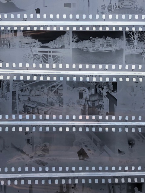

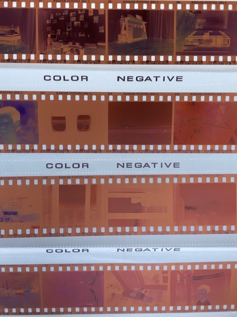

Paul, my negs look like Harmen's colour ones – a consistent but fairly narrow gap.
Are you saying that your replacement M-A negs are noticeably irregularly spaced? Is this using the same lens? (Might be useful to remove at least one potential variable and run a roll of film with just a single lens). Have you watched the film wind with the base plate off? If you haven't, I think it would be worth losing a roll of film and doing exactly that because you may see some slippage or other odd behaviour going on as you wind the film.
Regarding the comments about MP versus M-A reliability, there may be some truth to that but I doubt there is any difference between MPs and M-As of recent build because they are built in batches by the same people in the same factory and both cameras use mostly the same parts. I can't imagine there is any difference in the wind mechanism between the two cameras. As such, I doubt there is much point acquiring a new MP to get around the present problem.
Obviously, it is worth waiting to hear back from Germany before making any drastic decisions but my guess is they will simply ask for the camera to be sent to them for examination. Wetzlar's stock answer to 'marginal' problems like this is a CLA but it might be worth going that route because you will end up with a camera that has been put (back) together with greater care than might be the case with a camera on the usual production line. You also have the two year warranty. If the camera gets worse or you simply find, over time, that the frame spacing is unacceptable, Leica will deal with it. In my experience, they can be slow but they are also very good at taking care of problems that arise (even with products where the warranty has long elapsed).

The problem is not in the M-A having narrower spacings between the frames of the negatives,  which is far smaller in width compared to the M7, but more importantly it is the inconsistency of the spacings where the spacings vsry significantly in width. There does not appear to be a common pattern where this occurs. It can occur anywhere on the negatives.
I will continue to use the M-A and see if it “grows” out if this problem. But I doubt it, as I adopted the same approach with the first M-A and it continued with the same problem.

I have followed much of what you suggested to take out any variables when comparing my M7 with the M-As. I have used a 35mm lens on all cameras. I load the film in the same way and have checked the cameras with and without a film.
Yes, I can confirm that the replacement M-A exhibits noticeably irregular spacings between the frames which can occur anywhere throughout the 36 exposure negative(s). So there is a definite problem with this camera model. And I have researched others who have experienced similar problems. Some with even greater problems, which are well documented on youtube, due to problems with film advancement between frames 10-15, where the film didn’t  advance at all!
