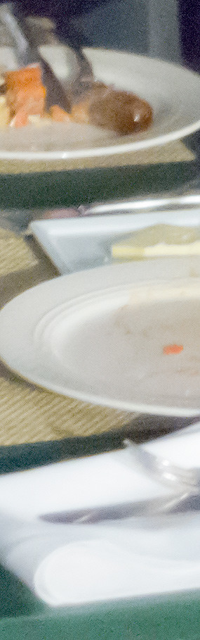

adan Posted January 17, 2019 Share #5 Posted January 17, 2019 Just for the record, and in no way meaning to belittle leoskkang's eyes (my own eyes are developing significant problems - like, Jeff, I get it). And to address his specific situation - focusing a 35mm Pre-ASPH. The 35 pre-asph Summilux itself suffers from - severe astigmatism. It is part of what creates its signature "glow" at f/1.4. As well as other major optical problems - spherical aberration and coma. The pictures below show a pre-ASPH Summilux picture made at f/1.4 - full-frame, and cropped for details. (Sorry about the noise - M9 CCD at ISO 2500). The astigmatism and coma are so severe they are visible even in the small whole image (area top right). The first crop shows that area in detail, and the streaks and blurs in the highlights that produce "wings" at 90° angles (—|— shapes) are classic astigmatism. With coma producing the bends in the longer wings. BTW - just about all Leica-M 35mms (even the Summicron ASPH) show some coma and astigmatism wide-open - the only one that is virtually completely free of it is the 35 Summilux ASPH. Welcome, dear visitor! As registered member you'd see an image here… Simply register for free here – We are always happy to welcome new members! Astigmatism and coma are always most severe the closer one gets to the corners, but in the center crop below, they are already starting to show just a few mms from the center of the image - see the triangular or "fanned out" highlight in the grape (or whatever it is) on the background plate. But the primary purpose of the center crop is to show the effect of the spherical aberration, as it affects the focus point. There really isn't one. Each part of the lens, as one moves out from the center of the glass, is focusing the table at a different place. Thus there is a layering of "sharp butter" onto "fuzzy butter" and "sharp knife" onto "fuzzy knife" and so on. In effect it creates "artificial" depth of field, as no one focus plane is perfectly sharp, but a wider range of distances are equally "sort of" sharp. The abberations all get stronger at close-focus distances. Which is why, in their wisdom, Leica never allowed the 35 Summilux pre-ASPH to focus closer than 1 meter. Net result - at f/1.4, focus is not much of an issue, because of the lens characteristics, and at smaller apertures (where the 35 Lux pre gets very sharp), focus is not much of an issue with a 35, because "real" depth of field kicks in. As I said, my eyes are weak. With my glasses off, I can't see anything critically sharp beyond about 26 inches /0.7 m. Nevertheless, I can often focus a 90mm f/2.8 or 75 f/2 at 3 meters, by sort of sensing the midpoint between where the (quite blurry) RF images start to merge, and where they start to separate again on the other side. 2 Quote Link to post Share on other sites Simply register for free here – We are always happy to welcome new members! Astigmatism and coma are always most severe the closer one gets to the corners, but in the center crop below, they are already starting to show just a few mms from the center of the image - see the triangular or "fanned out" highlight in the grape (or whatever it is) on the background plate. But the primary purpose of the center crop is to show the effect of the spherical aberration, as it affects the focus point. There really isn't one. Each part of the lens, as one moves out from the center of the glass, is focusing the table at a different place. Thus there is a layering of "sharp butter" onto "fuzzy butter" and "sharp knife" onto "fuzzy knife" and so on. In effect it creates "artificial" depth of field, as no one focus plane is perfectly sharp, but a wider range of distances are equally "sort of" sharp. The abberations all get stronger at close-focus distances. Which is why, in their wisdom, Leica never allowed the 35 Summilux pre-ASPH to focus closer than 1 meter. Net result - at f/1.4, focus is not much of an issue, because of the lens characteristics, and at smaller apertures (where the 35 Lux pre gets very sharp), focus is not much of an issue with a 35, because "real" depth of field kicks in. As I said, my eyes are weak. With my glasses off, I can't see anything critically sharp beyond about 26 inches /0.7 m. Nevertheless, I can often focus a 90mm f/2.8 or 75 f/2 at 3 meters, by sort of sensing the midpoint between where the (quite blurry) RF images start to merge, and where they start to separate again on the other side. ' data-webShareUrl='https://www.l-camera-forum.com/topic/293387-focusing-and-accuracy/?do=findComment&comment=3666478'>More sharing options...

jaapv Posted January 17, 2019 Share #7 Posted January 17, 2019 Advertisement (gone after registration) But Andy, what does lens astigmatism have to do with it ? Good examples, though. Quote Link to post Share on other sites More sharing options...
adan Posted January 17, 2019 Share #8 Posted January 17, 2019 Just an interesting coincidence - and that it, in part, makes worrying about "critical focus" with a 35 lux pre somewhat pointless. It is contributing to "fuzziness" over most of the image at f/1.4. Get the focus within about 10% of correct (1 foot at 10 feet) and that's as good as it gets. 1 Quote Link to post Share on other sites More sharing options...

redlensandgreenbody Posted January 18, 2019 Author Share #15 Posted January 18, 2019 14 hours ago, adan said: Just for the record, and in no way meaning to belittle leoskkang's eyes (my own eyes are developing significant problems - like, Jeff, I get it). And to address his specific situation - focusing a 35mm Pre-ASPH. The 35 pre-asph Summilux itself suffers from - severe astigmatism. It is part of what creates its signature "glow" at f/1.4. As well as other major optical problems - spherical aberration and coma. The pictures below show a pre-ASPH Summilux picture made at f/1.4 - full-frame, and cropped for details. (Sorry about the noise - M9 CCD at ISO 2500). The astigmatism and coma are so severe they are visible even in the small whole image (area top right). The first crop shows that area in detail, and the streaks and blurs in the highlights that produce "wings" at 90° angles (—|— shapes) are classic astigmatism. With coma producing the bends in the longer wings. BTW - just about all Leica-M 35mms (even the Summicron ASPH) show some coma and astigmatism wide-open - the only one that is virtually completely free of it is the 35 Summilux ASPH. Welcome, dear visitor! As registered member you'd see an image here… Simply register for free here – We are always happy to welcome new members! Astigmatism and coma are always most severe the closer one gets to the corners, but in the center crop below, they are already starting to show just a few mms from the center of the image - see the triangular or "fanned out" highlight in the grape (or whatever it is) on the background plate. But the primary purpose of the center crop is to show the effect of the spherical aberration, as it affects the focus point. There really isn't one. Each part of the lens, as one moves out from the center of the glass, is focusing the table at a different place. Thus there is a layering of "sharp butter" onto "fuzzy butter" and "sharp knife" onto "fuzzy knife" and so on. In effect it creates "artificial" depth of field, as no one focus plane is perfectly sharp, but a wider range of distances are equally "sort of" sharp. The abberations all get stronger at close-focus distances. Which is why, in their wisdom, Leica never allowed the 35 Summilux pre-ASPH to focus closer than 1 meter. Net result - at f/1.4, focus is not much of an issue, because of the lens characteristics, and at smaller apertures (where the 35 Lux pre gets very sharp), focus is not much of an issue with a 35, because "real" depth of field kicks in. As I said, my eyes are weak. With my glasses off, I can't see anything critically sharp beyond about 26 inches /0.7 m. Nevertheless, I can often focus a 90mm f/2.8 or 75 f/2 at 3 meters, by sort of sensing the midpoint between where the (quite blurry) RF images start to merge, and where they start to separate again on the other side. Adan, Wow. Thanks for your explanation with the examples! Quote Link to post Share on other sites More sharing options...

redlensandgreenbody Posted January 18, 2019 Author Share #20 Posted January 18, 2019 21 hours ago, adan said: Just for the record, and in no way meaning to belittle leoskkang's eyes (my own eyes are developing significant problems - like, Jeff, I get it). And to address his specific situation - focusing a 35mm Pre-ASPH. The 35 pre-asph Summilux itself suffers from - severe astigmatism. It is part of what creates its signature "glow" at f/1.4. As well as other major optical problems - spherical aberration and coma. The pictures below show a pre-ASPH Summilux picture made at f/1.4 - full-frame, and cropped for details. (Sorry about the noise - M9 CCD at ISO 2500). The astigmatism and coma are so severe they are visible even in the small whole image (area top right). The first crop shows that area in detail, and the streaks and blurs in the highlights that produce "wings" at 90° angles (—|— shapes) are classic astigmatism. With coma producing the bends in the longer wings. BTW - just about all Leica-M 35mms (even the Summicron ASPH) show some coma and astigmatism wide-open - the only one that is virtually completely free of it is the 35 Summilux ASPH. Welcome, dear visitor! As registered member you'd see an image here… Simply register for free here – We are always happy to welcome new members! Astigmatism and coma are always most severe the closer one gets to the corners, but in the center crop below, they are already starting to show just a few mms from the center of the image - see the triangular or "fanned out" highlight in the grape (or whatever it is) on the background plate. But the primary purpose of the center crop is to show the effect of the spherical aberration, as it affects the focus point. There really isn't one. Each part of the lens, as one moves out from the center of the glass, is focusing the table at a different place. Thus there is a layering of "sharp butter" onto "fuzzy butter" and "sharp knife" onto "fuzzy knife" and so on. In effect it creates "artificial" depth of field, as no one focus plane is perfectly sharp, but a wider range of distances are equally "sort of" sharp. The abberations all get stronger at close-focus distances. Which is why, in their wisdom, Leica never allowed the 35 Summilux pre-ASPH to focus closer than 1 meter. Net result - at f/1.4, focus is not much of an issue, because of the lens characteristics, and at smaller apertures (where the 35 Lux pre gets very sharp), focus is not much of an issue with a 35, because "real" depth of field kicks in. As I said, my eyes are weak. With my glasses off, I can't see anything critically sharp beyond about 26 inches /0.7 m. Nevertheless, I can often focus a 90mm f/2.8 or 75 f/2 at 3 meters, by sort of sensing the midpoint between where the (quite blurry) RF images start to merge, and where they start to separate again on the other side. You said: 'I can often focus a 90mm f/2.8 or 75 f/2 at 3 meters, by sort of sensing the midpoint between where the (quite blurry) RF images start to merge, and where they start to separate again on the other side' The way I focus with my cron35asph and lux35pre-asph is similar to yours. I focus my looking at the clarity of an image shown in the RF patch. But what I worried is when using this method when shooting wide open with cron35asph or elmar-M 50 (which I want to buy later). For example, if I am shooting a coca-cola bottle at about 3-4m I cannot clearly see the logo but I can see the clearest point while matching two images in the RF patch. Is is ok to focus like this with cron35asph and 50mm lens? I want to shoot 50mm without glasses (if possible). With 50mm wide open at f2 or f1.4, would a slight misalignment in the RF patch make any difference with regards to focus? Quote Link to post Share on other sites More sharing options...
