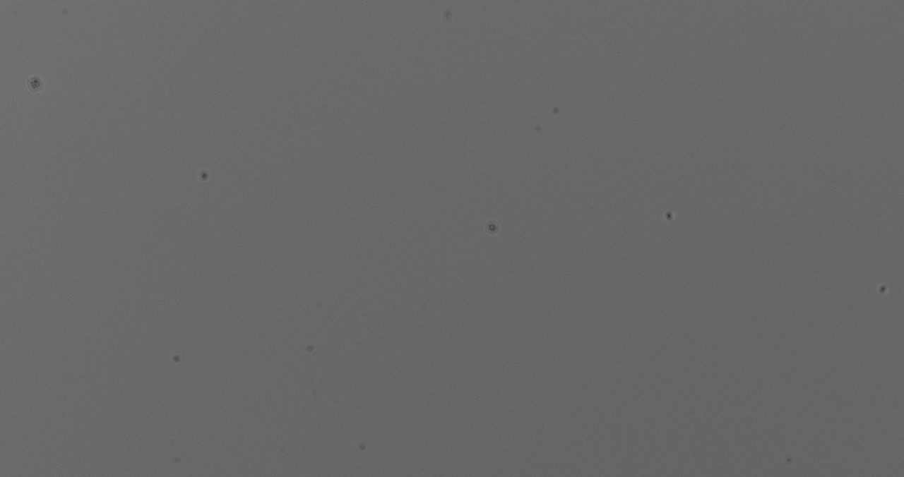

michali Posted July 28, 2019 Share #30 Posted July 28, 2019 30 minutes ago, jaapv said: Umm....There was and is a five year warranty on the sensor. So yes a 2013 one has no warranty. In 2015 the sensors on both of my M9s as well as the sensor on my Monochrom were replaced due to sensor corrosion. I subsequently sold the one M9. This morning I ran a check on my remaining M9 and the Monochrom, both cameras are displaying sensor corrosion again.... The question I have is whether Leica will charge for these sensors to be replaced, or is the work undertaken in 2015 still under warranty? Best, Mike Quote Link to post Share on other sites More sharing options...

michali Posted July 28, 2019 Share #32 Posted July 28, 2019 (edited) Here's a pic taken this morning with my Monochrom: Welcome, dear visitor! As registered member you'd see an image here… Simply register for free here – We are always happy to welcome new members! Edited July 28, 2019 by michali Quote Link to post Share on other sites Simply register for free here – We are always happy to welcome new members! ' data-webShareUrl='https://www.l-camera-forum.com/topic/293305-leica-m9-corrosion-with-new-sensor/?do=findComment&comment=3786528'>More sharing options...

Guest Posted July 28, 2019 Share #34 Posted July 28, 2019 well yes....that does look like M9's sensor corrosion. I had two of my "original" sensors replaced on my MM1 before having the new sensor fitted on the camera's third trip to Wetzlar so I am quite familiar with the symptoms. Are you sure you have the second generation sensor? Quote Link to post Share on other sites More sharing options...
pedaes Posted July 28, 2019 Share #35 Posted July 28, 2019 6 minutes ago, michali said: Here's a pic taken this morning with my Monochrom: Welcome, dear visitor! As registered member you'd see an image here… Simply register for free here – We are always happy to welcome new members! Thats a shame, but the key question for me is was the replacement an original or revised sensor. 1 Quote Link to post Share on other sites More sharing options...

ianman Posted July 28, 2019 Share #37 Posted July 28, 2019 10 minutes ago, pedaes said: Thats a shame, but the key question for me is was the replacement an original or revised sensor. Unless they were replaced in very late 2015, they are probably not the revised sensors. 2 Quote Link to post Share on other sites More sharing options...
ianman Posted July 28, 2019 Share #38 Posted July 28, 2019 2 minutes ago, marco febbrari said: Exactly, so from your experiences, is a 2013/2014 first generation sensor likely to have new corrosion problems? Yes... the corrosion-free sensor were not installed before late 2015 (October IIRC) 2 Quote Link to post Share on other sites More sharing options...
