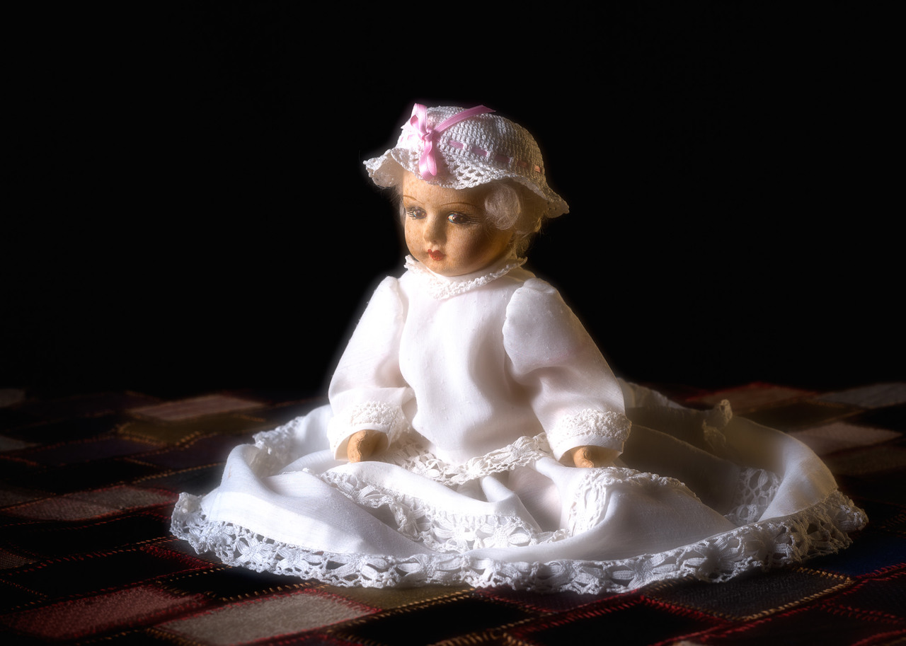

Michael Naylor Posted November 22, 2018 Author Share #8 Posted November 22, 2018 Thanks to all. I managed this in Color Efex Pro 4, using the Classical Soft Focus filter. I'm happy with this, but I guess its quite different to a Thamber. Comments please... Welcome, dear visitor! As registered member you'd see an image here… Simply register for free here – We are always happy to welcome new members! Quote Link to post Share on other sites Simply register for free here – We are always happy to welcome new members! ' data-webShareUrl='https://www.l-camera-forum.com/topic/291450-leica-thambar-m-90mm-f22-lens/?do=findComment&comment=3635368'>More sharing options...
Guest Posted November 22, 2018 Share #9 Posted November 22, 2018 4 hours ago, MikeNaylor said: Thanks to all. I managed this in Color Efex Pro 4, using the Classical Soft Focus filter. I'm happy with this, but I guess its quite different to a Thamber. Comments please... Welcome, dear visitor! As registered member you'd see an image here… Simply register for free here – We are always happy to welcome new members! You are right, its a lot different to a Thambar. Quote Link to post Share on other sites More sharing options...

adan Posted November 23, 2018 Share #12 Posted November 23, 2018 (edited) Here's a starting place with Photoshop - I'll tell you the settings I used: you can vary those ("Undo" is your friend ). - Open the image, and duplicate it as a new layer - Set the new layer Opacity to 60% or so (that can be changed and adjusted freely later on - this is with 70%). Set the Opacity style to "Normal" to begin with - you can fiddle with that as much as you like later, also). - Run a Gaussian Blur on the new layer (my sample is a 62-pixel Gaublur on a full 24Mp M10 image). - Play with Levels or Curves to adjust how bright or dark the fuzzy overlay is (I just ran an auto-Levels to get the brightest blurs back to white, in that layer only). That basically replicates the Thambar's extreme Spherical Aberration - a blurry image from the aperture's edges overlaid transparently on a sharp image from the center of the lens. (It is also how Zeiss Softar filters render - sharp image through the flat glass, overlaid with blur from the "dimples" on the surface: Welcome, dear visitor! As registered member you'd see an image here… Simply register for free here – We are always happy to welcome new members! What I haven't tried yet - adding chromatic aberration (color fringes), and doing something to replicate the ring-bokeh when using the Thambar's center-stop filter (although I have an idea about that). Edited November 23, 2018 by adan 1 Quote Link to post Share on other sites Simply register for free here – We are always happy to welcome new members! What I haven't tried yet - adding chromatic aberration (color fringes), and doing something to replicate the ring-bokeh when using the Thambar's center-stop filter (although I have an idea about that). ' data-webShareUrl='https://www.l-camera-forum.com/topic/291450-leica-thambar-m-90mm-f22-lens/?do=findComment&comment=3635690'>More sharing options...
Michael Naylor Posted November 23, 2018 Author Share #13 Posted November 23, 2018 35 minutes ago, adan said: Here's a starting place with Photoshop - I'll tell you the settings I used: you can vary those ("Undo" is your friend ). I've experimented with this technique many times. I suppose what I'm really looking for (and it may not be a Thambar effect at all) is a way to create halation - to make the highlights glow and spread out outwards. I'm aware of the many Tiffen filters and have watched the videos, etc. The Softar is not available in 46mm. Besides, I'd prefer to do it post. Maybe its just not possible. Quote Link to post Share on other sites More sharing options...
