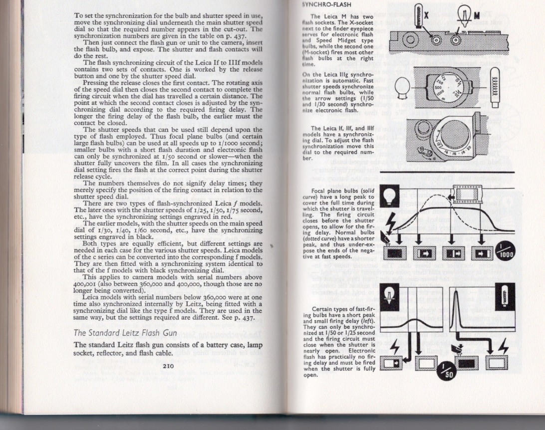

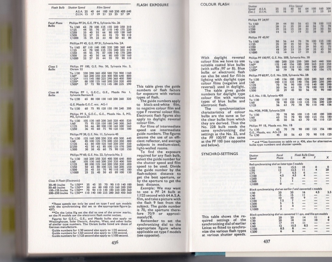

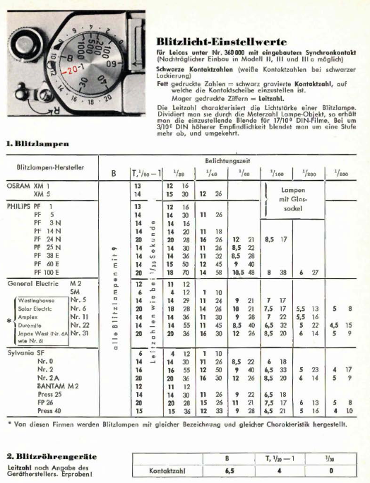

mondo79 Posted July 29, 2023 Share #12 Posted July 29, 2023 Leica IIIc conversion to IIIf I throw my Leica into the ring. According to the serial number it is a IIIc from 1949. The contact numbers are black and not engraved on the body but attached with a small plate which was screwed on. The shutter speed dial has a red1/30 instead of a 1/25 like on a IIIf. Maybe someone of you knows what happened to my IIIc and what was rebuilt. Welcome, dear visitor! As registered member you'd see an image here… Simply register for free here – We are always happy to welcome new members! Quote Link to post Share on other sites Simply register for free here – We are always happy to welcome new members! ' data-webShareUrl='https://www.l-camera-forum.com/topic/290185-leica-conversions-who-has-one/?do=findComment&comment=4824366'>More sharing options...
