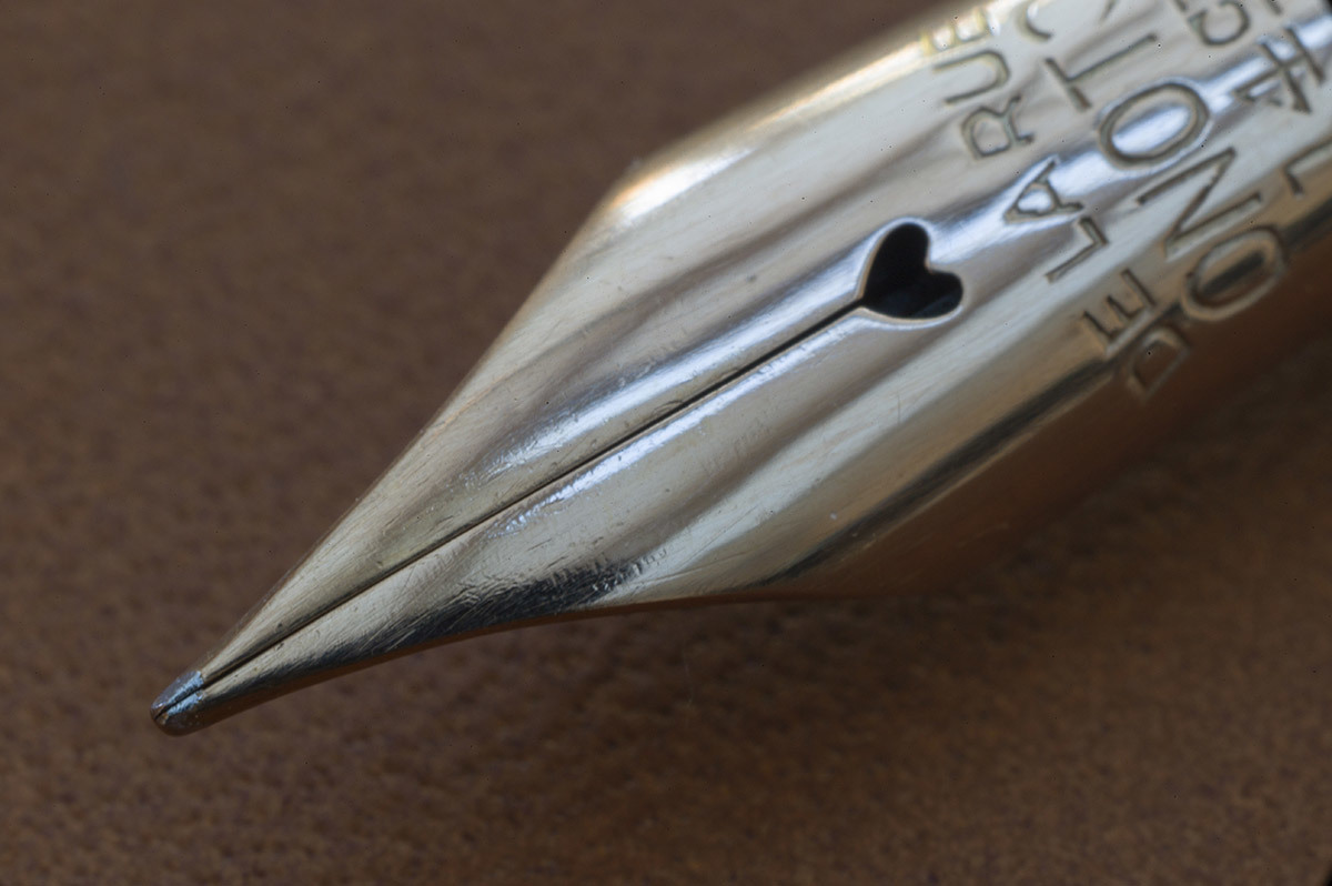

a.noctilux Posted September 26, 2018 Share #17 Posted September 26, 2018 I use Visoflex for decades now. Today, I wanted to "be in your place" (for pen photos, I never took pictures of pens seriously). So with 135mm lens (Tele-Elmar that I own also), it is not necessary to be at long distance from the subject. In natural habit and shy creatures, this is THE lens for comfortable use. I mounted on Visoflex III some trials for "pen photos". My best "comfortable set" is M + Visoflex III + 16464 variable "ring" + Elmarit 2.8/90mm optical cell. With this I can frame the whole pen and when full extended a bit more than "half-pen" ( Duofold ! ) I'll post some photos later. Quote Link to post Share on other sites More sharing options...
J-T Posted September 27, 2018 Author Share #18 Posted September 27, 2018 I look forward to seeing your posted results of the Duofold :-) Quote Link to post Share on other sites More sharing options...
a.noctilux Posted September 27, 2018 Share #19 Posted September 27, 2018 Here some "results from the set-up" Please forgive lack of d.o.f. (quick hand held) . Welcome, dear visitor! As registered member you'd see an image here… Simply register for free here – We are always happy to welcome new members! .. ... At back for "fun" balinese calendar on Lontar 4 Quote Link to post Share on other sites Simply register for free here – We are always happy to welcome new members! .. ... At back for "fun" balinese calendar on Lontar ' data-webShareUrl='https://www.l-camera-forum.com/topic/289825-macro-for-visoflex-and-m9/?do=findComment&comment=3601659'>More sharing options...
a.noctilux Posted September 27, 2018 Share #20 Posted September 27, 2018 Hardware used for above . Welcome, dear visitor! As registered member you'd see an image here… Simply register for free here – We are always happy to welcome new members! Hard (older) way Visoflex III + prism + OTZFO+ Elmarit 2.8/90mm lens head .. Simpler (new way) with Visoflex (typ 020) plus old Visoflex III as 41mm spacer ring right Tele-Elmar 4/135 lens head 3 Quote Link to post Share on other sites Simply register for free here – We are always happy to welcome new members! Hard (older) way Visoflex III + prism + OTZFO+ Elmarit 2.8/90mm lens head .. Simpler (new way) with Visoflex (typ 020) plus old Visoflex III as 41mm spacer ring right Tele-Elmar 4/135 lens head ' data-webShareUrl='https://www.l-camera-forum.com/topic/289825-macro-for-visoflex-and-m9/?do=findComment&comment=3601662'>More sharing options...
