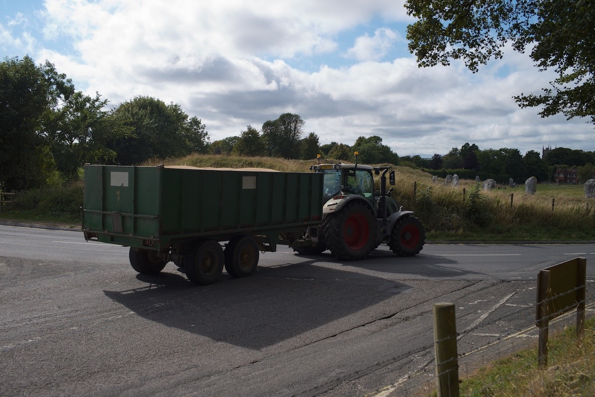

lincoln_m Posted September 16, 2018 Share #50 Posted September 16, 2018 Welcome, dear visitor! As registered member you'd see an image here… Simply register for free here – We are always happy to welcome new members! A tractor in Avebury, England. I only had a few seconds to grab the shot so M10 did the exposure. Here is the DNG converted to JPEG in Aperture as is with no manual adjustments. Quote Link to post Share on other sites Simply register for free here – We are always happy to welcome new members! A tractor in Avebury, England. I only had a few seconds to grab the shot so M10 did the exposure. Here is the DNG converted to JPEG in Aperture as is with no manual adjustments. ' data-webShareUrl='https://www.l-camera-forum.com/topic/289494-m10-underexposing-and-metering-question/?do=findComment&comment=3594053'>More sharing options...

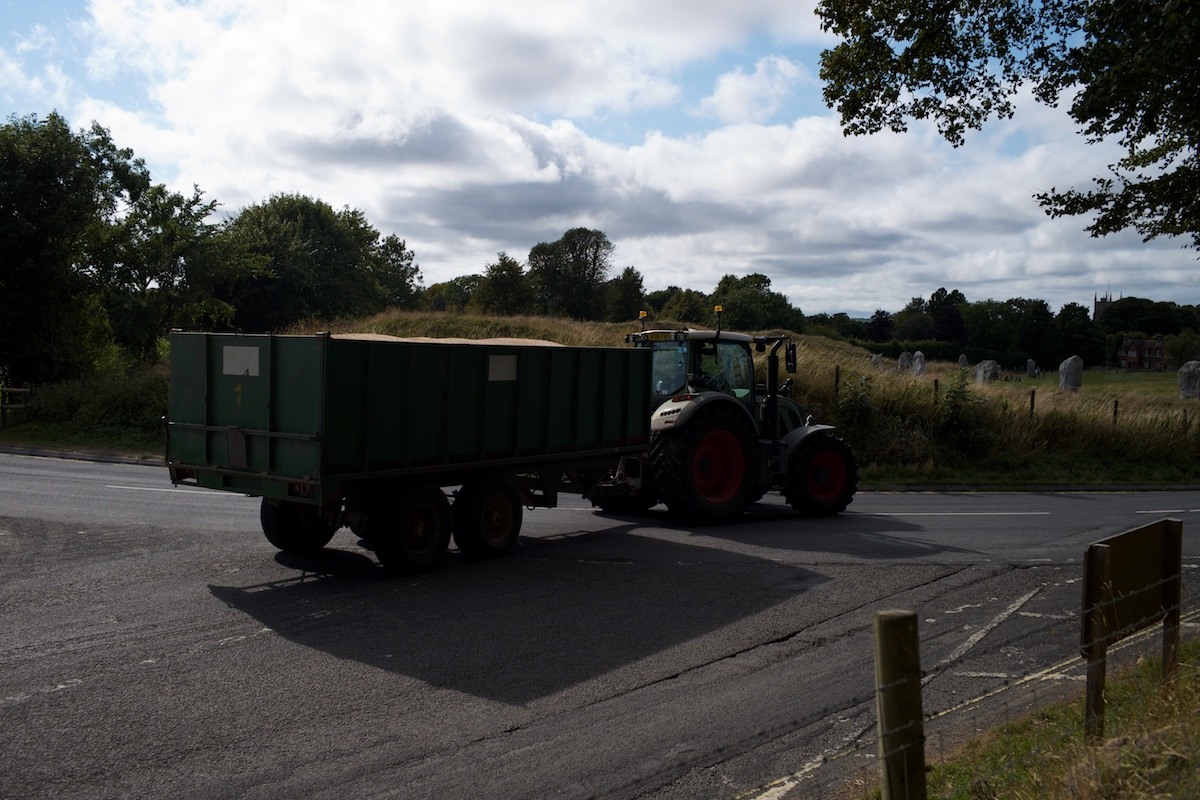

lincoln_m Posted September 16, 2018 Share #51 Posted September 16, 2018 Now with the shadows raised in Aperture by 40%. Welcome, dear visitor! As registered member you'd see an image here… Simply register for free here – We are always happy to welcome new members! Quote Link to post Share on other sites Simply register for free here – We are always happy to welcome new members! ' data-webShareUrl='https://www.l-camera-forum.com/topic/289494-m10-underexposing-and-metering-question/?do=findComment&comment=3594054'>More sharing options...
lincoln_m Posted September 16, 2018 Share #52 Posted September 16, 2018 You would think that the bright clouds in the top of the frame wouldn't have an effect on the centre weighted exposure meter but it certainly seems to. Unless the M10 exposure algorithm purposely underexposes to preserve highlights? The good news is that the detail is available in the DNG file shadows so they can be pulled up without causing posterisation. I wonder if using the wider apertures like f4 (above) instead of f8 changes the exposures metering? I'll have to experiment. Cheers, Lincoln Quote Link to post Share on other sites More sharing options...

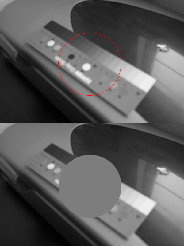

adan Posted September 16, 2018 Share #54 Posted September 16, 2018 As I've said elsewhere (to the point of boring some people, no doubt) - the M10 metering algorithm will meter an 18% gray just about exactly correctly - within 1-2 points of 120 on the digital 0-255 brightness scale. Welcome, dear visitor! As registered member you'd see an image here… Simply register for free here – We are always happy to welcome new members! The M10 issue specifically is that all the grays darker than 18% gray are dragged down by a processing algorithm - an applied contrast curve unique to the M10 - to add visible punch and saturation, compared to the previous CMOS M cameras (M240 family). There is another factor that has to be remembered with all Leica M metering, from the M5 on (and this gets to the "wide-angle" issue). The meter system measures a fixed area within the picture - It does NOT measure a fixed area within the glass viewfinder. Because the M viewfinder always shows a fixed "28mm" view of the world, cropped by framelines. Put a 21, 18, 16 or 15mm lens on an M - and the metering area becomes as big as the entire area of the built-in viewfinder. Because the built-in finder does not show you the full area that a super-wide lens sees. Coming from virtually any other camera type (except other RFs, or perhaps the Fuji X-Pro) it is easy to, out of habit, think "metering area is 40% of the height between the black edges of the screen." Not in an M - it is 40% of the area inside the framelines for the actual lens in use. And of course, for any lens wider than 28mm, there are no framelines at all. It is easy for the sky to be way up at the top of the built-in finder (28mm field of view) - yet well within what the meter sees with a 21 or 18mm lens. https://www.l-camera-forum.com/topic/224881-shooting-black-and-white-m7-camera-settings/?p=2567197 Ideally, for the super-wide lenses, Leica might add a little silvery circle in the accessory viewfinders, to show "metering area for this lens specifically." But many would find it distracting, and not all that helpful, since to read the meter, we'd still have to look through the built-in ("wrong") viewfinder to see the > o < indicators. Historically, of course, it took Leica years to figure out how to add ttl metering to their rangefinders, which have none of the normal "light-diversion" mechanisms already built into larger and more complex SLRs, that can be "tapped" to divert light to a meter sensor (Mirror, ground-glass, eye-level prism). 9 Quote Link to post Share on other sites Simply register for free here – We are always happy to welcome new members! The M10 issue specifically is that all the grays darker than 18% gray are dragged down by a processing algorithm - an applied contrast curve unique to the M10 - to add visible punch and saturation, compared to the previous CMOS M cameras (M240 family). There is another factor that has to be remembered with all Leica M metering, from the M5 on (and this gets to the "wide-angle" issue). The meter system measures a fixed area within the picture - It does NOT measure a fixed area within the glass viewfinder. Because the M viewfinder always shows a fixed "28mm" view of the world, cropped by framelines. Put a 21, 18, 16 or 15mm lens on an M - and the metering area becomes as big as the entire area of the built-in viewfinder. Because the built-in finder does not show you the full area that a super-wide lens sees. Coming from virtually any other camera type (except other RFs, or perhaps the Fuji X-Pro) it is easy to, out of habit, think "metering area is 40% of the height between the black edges of the screen." Not in an M - it is 40% of the area inside the framelines for the actual lens in use. And of course, for any lens wider than 28mm, there are no framelines at all. It is easy for the sky to be way up at the top of the built-in finder (28mm field of view) - yet well within what the meter sees with a 21 or 18mm lens. https://www.l-camera-forum.com/topic/224881-shooting-black-and-white-m7-camera-settings/?p=2567197 Ideally, for the super-wide lenses, Leica might add a little silvery circle in the accessory viewfinders, to show "metering area for this lens specifically." But many would find it distracting, and not all that helpful, since to read the meter, we'd still have to look through the built-in ("wrong") viewfinder to see the > o < indicators. Historically, of course, it took Leica years to figure out how to add ttl metering to their rangefinders, which have none of the normal "light-diversion" mechanisms already built into larger and more complex SLRs, that can be "tapped" to divert light to a meter sensor (Mirror, ground-glass, eye-level prism). ' data-webShareUrl='https://www.l-camera-forum.com/topic/289494-m10-underexposing-and-metering-question/?do=findComment&comment=3594110'>More sharing options...
