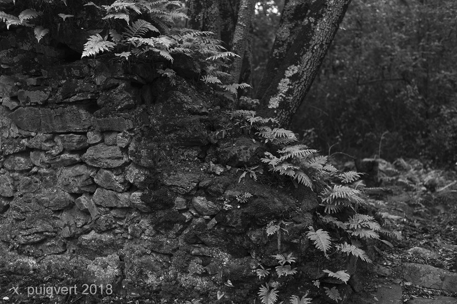

Currently for monochrome photo I use the M9 + yellow filter.
I convert the DNG files into Monochrome with the program DNGMonochrome 0.9.83 beta (undoes the Bayer RGB filter algorithm).
Then the processed with Lightroom.
The result is that you can recover the shadows without noise.
The difference with the MM1 is the ISO 160 sensitivity against the 320 of the MM1.
Conclusion: the noise is in de Bayer Filter.
Example: Leica M9 + summicron 35 asph + yelow filter
Edited by pibitller
In general it improves the contrast and illuminates the green tones
