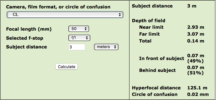

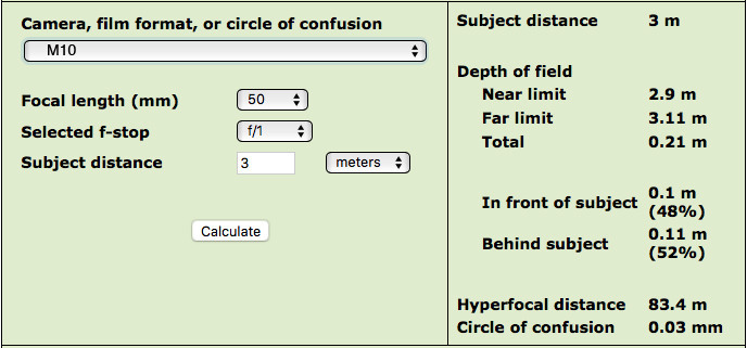

While dof and angle of view will change because of the magnification and focal length changes, as far as exp6isure is concerned f/4 is f/4 and is not one wit affected by the crop factor, unless you use a focal reducer to concentrate the image.
When I use my lightmeter to set an M3 or a Hasselblad it doesnt make any difference if the 50mm lens is covering 35mm or 6x6.

And remember too that depth of field is only an attempt to quantify the effect of failures in human eyesight on perceiving 'sharpness', a bit of a confidence trick, similar to paper money :-)

There's nothing new in shorter focal length lenses giving more depth of field (so less 'separation') or that field of view depends on both focal length and format.
The rest is baloney, internet forums are full of hare-brained theories from people who could well spend some time with some basic text books on photography and optics.
