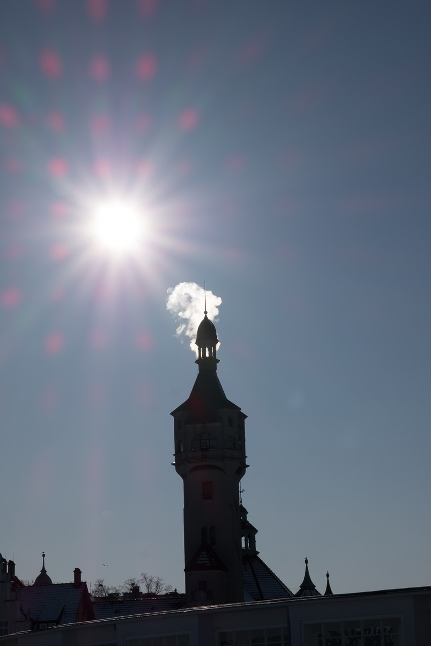

Too many clouds here but i've done a couple of tests with a halogen lamp on 12 M lenses at f/16. Got the flare above, to a lesser extent, with 2 lenses only so far, the worst case being that of the CV 15/4.5 v2 ( https://tinyurl.com/y8nkyus5 ). So not a CL problem apparently but i will test other M lenses when i have some time to be sure.
Affected lenses:
- CV 15/4.5 v2
- CV 21/4
Unaffected lenses:
- Leica 35/2 asph v1, 40/2, 50/2.8 v2, 90/2.8 "thin" T-E, 90/4 C, 135/3.4
- Rokkor 40/2, 90/4
- CZ 35/3.5
- ZM 35/2.8

Same test as above on the CL with 12 more M lenses at f/16. 4 out of them are affected by ghost images of the light source to various extents ("Affected"). 7 show some flare w/o those ghost images ("Unaffected"). 1 shows no flare at all ("No flare"). I won't bore you with my snaps here but i keep them for those interested.
Affected:
- 21/3.4 asph
- 28/2.8 asph v1
- 35/1.4 v2
- 28-35-50 v1 at 28mm
Unaffected:
- 28/2 v2
- 35/2.5
- 50/1.4 asph
- 50/2.5
- 75/1.4
- 90/2 apo
- 90/4 macro
- 28-35-50 v1 at 35mm
- 28-35-50 v1 at 50mm
No flare:
- ZM 50/1.5 coded as 50/1.4 pre-asph
