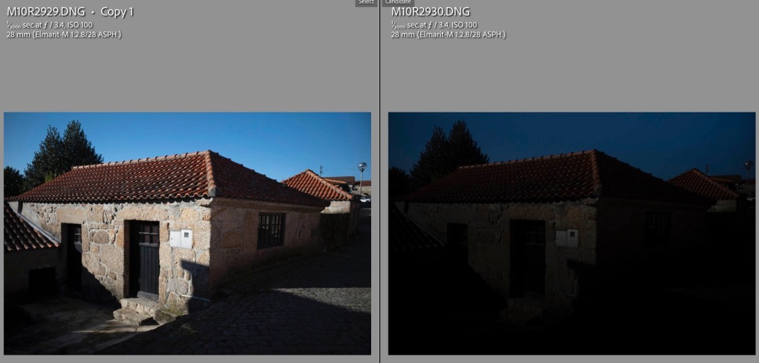

jjesp Posted December 22, 2022 Share #48 Posted December 22, 2022 (edited) Old thread. But found it since my M10-P has the same. I am not talking metering. If I shoot manually in sunlight as I often prefer, on iso 200, 1/500 and f/8 (both on Voigtlander and Summicron lenses), the images is about 1,5 stops darker. This is compared to Leica Q, Ricoh GRIII and all Fujis. So when going out in the streets with the M10, I have to put the ISO on 400 or 640, to have the same exposure. Maybe not a defect, but strange - and a little annoying. I can of course just raise the exposure in post with one or two stops. But why? Isn't Leica just cheating a little here, to brag about the better lowlight on high iso settings in marketing? ISO 6400 on the M10 is clearly not ISO 6400 on any other camera. Has anyone compared it to the M11? Edited December 22, 2022 by jjesp Quote Link to post Share on other sites More sharing options...
jjesp Posted December 22, 2022 Share #49 Posted December 22, 2022 22 minutes ago, Musky said: It’s tough to compare because the M10 is always on Center Weighted meter and it measures the light bouncing off the shutter blades. The other cameras you mentioned meter off the sensor. You can try taking it in live view and use average meter? See what it does. Again, I am not talking metering. I am just looking at two images, shot manual - no metering. And the exact same "values" in ISO, shutter speed and aperture. The M10 image is at least one step darker. But of course, I can live with it, knowing it. But just wondering why the M10 is that much different than any other digital camera I used. Including Leica Q... Quote Link to post Share on other sites More sharing options...
Adam Bonn Posted December 22, 2022 Share #50 Posted December 22, 2022 The M10 has quite an aggressive native tone curve that crushes shadows and mid tones Things such as the differences in various digital ISO standards, lens T-stop and what the camera pre-bakes into the RAW file mean that sharing exposure settings between cameras won’t always produce an identical exposure. If I set my M9 to ISO 160 and my M10 to ISO 200 and use the same lens to shoot the same thing at the same time with the same aperture and SS settings the M10 is appreciably darker (despite a ‘brighter’ ISO) iirc (….) the hunch is that seeing as the M10 doesn’t exactly have class leading exposure latitude in the highlights and that the M10 arrived after the 240, that was often criticised for flat images, the M10 is intentionally configured to produce a darker frame to add contrast and protect the highlights FWIW I generally tended to adjust the global brightness in post for scenes where I’ve protected the highlights, used ISO100 to maximise the contrast on flat light days and set either +1/3 or +1/2 EV in scenes where the mid/dark tones where more important to me than the highlights. But most often my ‘set and forget’ way of working with the M10 was ISO200 zero EV comp and meter of the part of the scene that would give me what I wanted. Of course OMWV 1 1 Quote Link to post Share on other sites More sharing options...
shanefking Posted December 22, 2022 Share #51 Posted December 22, 2022 4 hours ago, jjesp said: Again, I am not talking metering. I am just looking at two images, shot manual - no metering. And the exact same "values" in ISO, shutter speed and aperture. The M10 image is at least one step darker. But of course, I can live with it, knowing it. But just wondering why the M10 is that much different than any other digital camera I used. Including Leica Q... Yup, this is known. “ISO” was an international standard for film sensitivity rating, now its more of an abstract concept, simply to give an idea of the sensitivity settings. Kodak Tri-x 400 was the same in a leica or a nikon, but now a sensor in a leica or a nikon will have entirely different manufacturing, and teams of engineers with different priorities. Personally I shoot by the histogram, and adjust the ISO appropriately. Often what appears like crushed black in the preview has plenty of latitude in the actual file. 1 Quote Link to post Share on other sites More sharing options...
