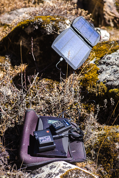

I don’t have any association with Goal Zero products and I’m not an engineer, so take this for what it’s worth. To answer your question, any unit from the Sherpa 100 on up will charge a Leica camera battery as fast as an AC outlet if you use the 12V output or the add-on 110V inverter into your Leica charger. The real question is “how many times” it will charge you camera battery before the unit itself needs to be recharged. I would suggest a call to Goal Zero’s customer service to discuss your size requirements.
NOTE: And this is important. You can’t take the larger Yeti units on an airplane. FAA regulations limit battery sizes to 100Wh. The Sherpa 50 and 100 are good to go on airplanes.
That said the thing I like about Goal Zero units is the flexibility, both on their output (110V, 12V and USB) and with recharging the unit (solar, 110V/220V, and 12V car plug). I’ve used the Yeti 400 units on multi-day shoots but never with solar recharging so I can’t really comment on that. My typical scenario is recharging batteries for a couple cameras, sometimes strobe batteries and cell phones and iPads for the entire crew. I’ve never had to go more that a couple days without access to 110V power to recharge the unit so the smaller unit fulfilled my needs.
My #1 Tip: take more than one charger! This speeds up your charging time and provides a backup if one charger goes down.
Best of luck on your adventure. Let us know how everything worked out. jc
Thanks for the advice. I think what I’ll do is but an extra pair of chargers for the M10 and SL, buy two more batteries for each camera (total of 4 per camera). Then I’ll get the largest portable battery from Goal Zero that I can fly with. Film is not an option... my clients don’t want it, and even if I could develop it easily in the field, I have no way of scanning it.
