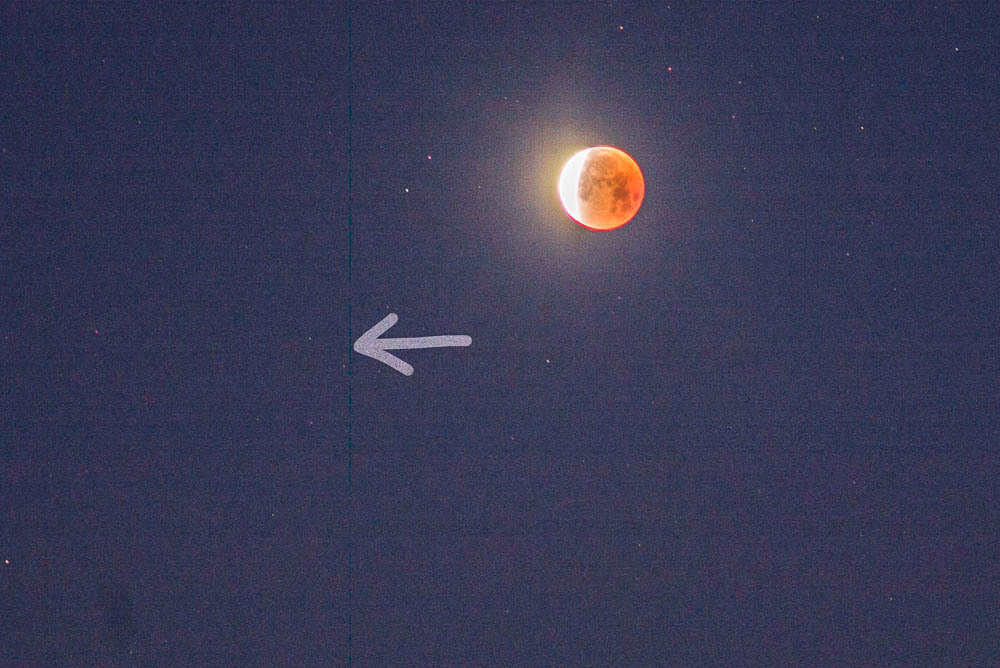

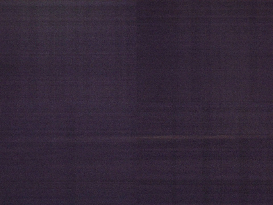

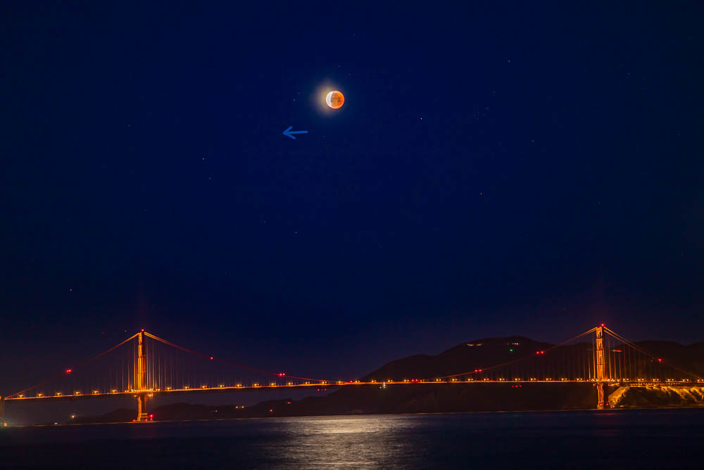

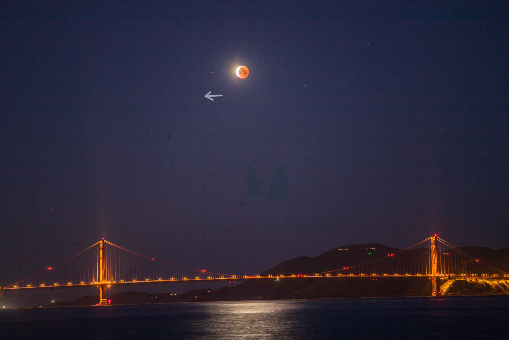

McMax Posted February 2, 2018 Share #1 Posted February 2, 2018 Advertisement (gone after registration) I post this to see if anyone else have/had the same sensor issues with their M240 (M-P). I was playing around in Lightroom in November 2017, mainly testing different extreme values with the haze control, and other stuff to experiment with my photography. To my astonishment I saw a vertical line running exactly in the middle of the uncropped image. I then tested a photo from April 2015 that was taken with another M240 M-P body I had at that time. And the same vertical line appeared. I then randomly tested several other photos, and the same line appears, in virtually all photos, from both M-P bodies! I have a total of more than 20000 photos with M-P:s that in some or another way are affected by this problem. Attached here is an example of a jpg from M-P body 1, and one of M-P body 2, after tweakning the dng:s. Welcome, dear visitor! As registered member you'd see an image here… Simply register for free here – We are always happy to welcome new members! The dng:s and full JPG:s can be downloaded to view through the links provided here: Link to DNG (M-P body 1): https://we.tl/FQQkFgKo7U Link to JPG (M-P body 1): https://we.tl/4BpPecbwmR Link to DNG (M-P body 2): https://we.tl/O2Kb9XKab7 Link to JPG (M-P body 2): https://we.tl/a3Vw2FUBYQ These images do not represent my photography (www.m9x.se), but they show the problem very clearly. So I went to my local Leica center in Stockholm who sent it to Leica in Germany. My lokal Leica dealer is fantastic by the way. I instructed Leica to test the way I had done in Lightroom doing the following: - adjust ”haze” to a the right - lower the value of vibrance - lower the value of saturation - set exposure to show a standard good histogram curve Leica concluded that the sensor ”function within tolerances”. They said: Dear Leica Customer,Your Leica M-P 240 was tested extensively by our experts in the quality management department. The performance meets our testing and acceptance requirement and is well within tolerance. An exchange of the image board will not eliminate the effect since it is caused by extreme post processing of the images.With kind regards,XXX XXXXXXLeica Customer Care Both I and my lokal Leica dealer where astonished and very surprised. Separately we wrote to Leica. My dealer wrote this to Leica: Hi XXX XXXXXX. I have a sad case regarding service on a Leica M-P (240) camera of our customer, our service number 2001712080005 / Leica 964698 The customer has announced that the sensor in the camera gives a vertical line in the middle of the car's top. Become extra visible when the images are processed in Photoshop. The camera sold by us to the customer on 12 May 2015 To the point, the camera has been on Leica service with the same note in March 2016 and then the sensor is replaced. When the customer reviews images from the camera, the same problem occurs. Leica's current response is that the camera after examination is within tolerances and errors caused by customer image processing? Attach documents in the form of Leica service orders as well as link with customer test images for download here. Leica's current response is that the camera after examination is within tolerances and errors caused by customer image processing? Customer Max Dahlstrand has been a faithful Leica customer for many years and to our store. He has bought or a plurality of cameras and lenses and is unbelievably boring that we and Leica loose his confidence. We would be grateful if you in any way together with Leica can find a solution to our and our customers Sincerely XXX XXXXXX To add to this, I told Leica that I would most likely post something on a forum to see if others have the same problem. To this Leica sent out a in-house alert message (that I mistakenly received a copy of) saying: Hallo zusammen, der Kunde wird demnächst was ins Forum posten. S.unten. ich habe ihm die von XXX XXXXXX übersetzte Antwort von der QS gemailt. Mit freundlichen Grüßen / Best regards XXX XXXXXX In English that means: Hello everybody, the customer will soon post something in the forum. See below. I emailed him the reply translated by XXX XXXXXX QS. Sincerely / Best regards Have I found an inherent problem with the sensor construction on the M240? To sum up: The vertical line appears in the exact same position in both bodys. This probably means it is an inherent problem in the construction of the sensor, or? My guess is that the sensor consists of two halves fused together, and that this fuse is not seamless (no, I do not know this, I am not a technician). The line appears in Lightroom (but also in C1Pro, Silver Efex Pro, ON1 Photo Raw). So it is not a matter of software. Although, in Lightroom (Leica´s preferred software) it appears much stronger than in C1P11. I have tested other cameras, and I cannot get a vertical line to appear in any images from them. I tested a GH4 heavily during the period my M-P was in Germany, as well as Ricoh GRii. And my old M9 did not have this problem, nor the even older Canon 5D. It is not a dead pixel problem. It is not banding. A camera that costs around 7000 Euro should not have this kind of sensor issue. A photographer/artist should be able to tweak a photo without a vertical line separating the image in two halves. There are many other competing camera makers nowadays. A camera company in 2018 should not act this way to faithful consumers. My Leica garage includes/included: R4, M9, M-P, 18/3.4, 28/2.8 Asph, 35/2 vers 4, two 50/1.4 Asph, 50/1.4, two 75/2 APO, 90/2.8, Digital flash SD20, etc… I am a devoted hobby photographer. I am not rich (not even close) and the expenses from Leica equipment means less of other things in my life. But I have spent 25000 Euro on Leica products through the years. I do not make any money on photography. I have used Leica for the love of their products. But maybe not som much anymore, to which I am very sad. Any one out there that has had the same problem? Quote Link to post Share on other sites Simply register for free here – We are always happy to welcome new members! The dng:s and full JPG:s can be downloaded to view through the links provided here: Link to DNG (M-P body 1): https://we.tl/FQQkFgKo7U Link to JPG (M-P body 1): https://we.tl/4BpPecbwmR Link to DNG (M-P body 2): https://we.tl/O2Kb9XKab7 Link to JPG (M-P body 2): https://we.tl/a3Vw2FUBYQ These images do not represent my photography (www.m9x.se), but they show the problem very clearly. So I went to my local Leica center in Stockholm who sent it to Leica in Germany. My lokal Leica dealer is fantastic by the way. I instructed Leica to test the way I had done in Lightroom doing the following: - adjust ”haze” to a the right - lower the value of vibrance - lower the value of saturation - set exposure to show a standard good histogram curve Leica concluded that the sensor ”function within tolerances”. They said: Both I and my lokal Leica dealer where astonished and very surprised. Separately we wrote to Leica. My dealer wrote this to Leica: To add to this, I told Leica that I would most likely post something on a forum to see if others have the same problem. To this Leica sent out a in-house alert message (that I mistakenly received a copy of) saying: Have I found an inherent problem with the sensor construction on the M240? To sum up: The vertical line appears in the exact same position in both bodys. This probably means it is an inherent problem in the construction of the sensor, or? My guess is that the sensor consists of two halves fused together, and that this fuse is not seamless (no, I do not know this, I am not a technician). The line appears in Lightroom (but also in C1Pro, Silver Efex Pro, ON1 Photo Raw). So it is not a matter of software. Although, in Lightroom (Leica´s preferred software) it appears much stronger than in C1P11. I have tested other cameras, and I cannot get a vertical line to appear in any images from them. I tested a GH4 heavily during the period my M-P was in Germany, as well as Ricoh GRii. And my old M9 did not have this problem, nor the even older Canon 5D. It is not a dead pixel problem. It is not banding. A camera that costs around 7000 Euro should not have this kind of sensor issue. A photographer/artist should be able to tweak a photo without a vertical line separating the image in two halves. There are many other competing camera makers nowadays. A camera company in 2018 should not act this way to faithful consumers. My Leica garage includes/included: R4, M9, M-P, 18/3.4, 28/2.8 Asph, 35/2 vers 4, two 50/1.4 Asph, 50/1.4, two 75/2 APO, 90/2.8, Digital flash SD20, etc… I am a devoted hobby photographer. I am not rich (not even close) and the expenses from Leica equipment means less of other things in my life. But I have spent 25000 Euro on Leica products through the years. I do not make any money on photography. I have used Leica for the love of their products. But maybe not som much anymore, to which I am very sad. Any one out there that has had the same problem? ' data-webShareUrl='https://www.l-camera-forum.com/topic/281467-m240-sensor-defect-that-leica-says-is-within-tolerances/?do=findComment&comment=3453884'>More sharing options...

thighslapper Posted February 2, 2018 Share #3 Posted February 2, 2018 (edited) The same 'problem' was present in the M9 and reflects the fact the sensor is read in two halves ...... not completely from one side or the other. The sensor is calibrated so all the pixel sites read out the same signal when exposed to the same illumination .... but that is only within certain limits and the most obvious mismatch is likely to be where the two halves of the readout process meet, and as the calibration process can only be an average for average circumstances there will be times where discrepancies may be more apparent. Due to product variation this may be more apparent is some cameras than others. If Leica says it is within their tolerances and you process to the point where these issues are apparent then I doubt if they will change their response. If you take well exposed photos and don't try to resurrect them by extreme processing there will be no problem ....... Having said that ...... I have tried to replicate your instructions on some old M240 files and cannot create any central vertical line ..... Edited February 2, 2018 by thighslapper 2 Quote Link to post Share on other sites More sharing options...

hoppyman Posted February 2, 2018 Share #5 Posted February 2, 2018 (edited) I don't think that the sensor is constructed by joining two halves. I think that the raw information may be received and processed in sections by the way the pixel values are collected in lines/columns. It's possible that the values calculated may be subtly different but perhaps not noticeable in usual image processing? Were the difference very striking in normal photography, it might indicate an error by the processor in the camera? I downloaded your first DNG and processed in Lightroom including adding some capture sharpening and suggested rendering by LR (more contrast, colour saturation etc). You have a spotless sensor by the way.It looks to be a flat average exposure with no clipping. That both from the hazy light and default conservative values in the DNGI just don't see any artefact issues in the copy that I developed including viewing the original at 1:1. Any artefact (for example noise) will be more visible in areas of continuous tone like sky.I don't know what processing steps you used . I presume that you have used extreme adjustments of some values to make visible the 'halve's artefact? Welcome, dear visitor! As registered member you'd see an image here… Simply register for free here – We are always happy to welcome new members! Edited February 2, 2018 by hoppyman Quote Link to post Share on other sites Simply register for free here – We are always happy to welcome new members! ' data-webShareUrl='https://www.l-camera-forum.com/topic/281467-m240-sensor-defect-that-leica-says-is-within-tolerances/?do=findComment&comment=3453933'>More sharing options...

lct Posted February 3, 2018 Share #7 Posted February 3, 2018 Advertisement (gone after registration) I can't seem to perceive any flaw in your DNG files. Camera makers cannot be held responsible for artefacts caused by extreme adjustments IMHO. 1 Quote Link to post Share on other sites More sharing options...

m9x Posted February 3, 2018 Share #9 Posted February 3, 2018 I did the following: Lightroom doing the following: - adjust ”haze” to a the right - lower the value of vibrance - lower the value of saturation - set exposure to show a standard good histogram curve The line appears very clear on most photos when doing this. It does not occur on photos shot with other cameras including M9. Skickat från min iPhone med Tapatalk Pro Quote Link to post Share on other sites More sharing options...
