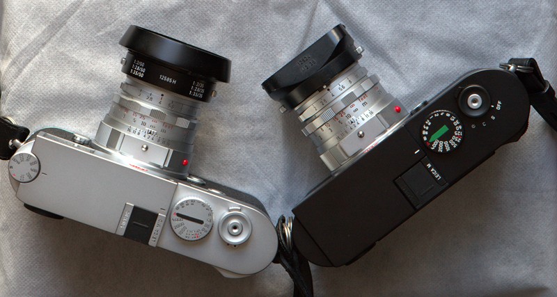

a.noctilux Posted October 26, 2017 Share #7 Posted October 26, 2017 Advertisement (gone after registration) Here MP 0.85 with Summicron DR with Close Range adapter mounted: Even the plastic "anti-misuse" is there (near serial #), just like M3 Quote Link to post Share on other sites More sharing options...
