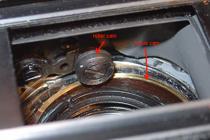

Dao De Leitz Posted March 18, 2018 Share #42 Posted March 18, 2018 Hello Alex, as supplementary remarks: When used with the Macro-Adapter-M (14409), the original Macro-Elmar-M 90mm (M-E-M) is rotated by 180 degrees.The lens then has its own control cam for the macro range. The given helical motion must be mapped to the range 0.55m... 0,76m.The gradient of the control curve is noticeably flatter/finer with macros than in the far range.The original M-E-M has two different control curves! The demands on the accuracy of coordination for the function of the overall system* for near and far are therefore very high.(* two control curve sections, adapter'with optics', rangefinder) With range finder coupling, the Macro-Adapter-M (14409) is intended for use with the 1st M-E-M (11633) only. The goggles were saved with the new 2nd Macro Set. Whether the second special control curve is still available I do not know. Greeting Thorsten ... with #60 & #61 Quote Link to post Share on other sites More sharing options...

lct Posted March 18, 2018 Share #44 Posted March 18, 2018 [...] When used with the Macro-Adapter-M (14409), the original Macro-Elmar-M 90mm (M-E-M) is rotated by 180 degrees. The lens then has its own control cam for the macro range. The given helical motion must be mapped to the range 0.55m... 0,76m. The gradient of the control curve is noticeably flatter/finer with macros than in the far range. The original M-E-M has two different control curves! The demands on the accuracy of coordination for the function of the overall system* for near and far are therefore very high. (* two control curve sections, adapter'with optics', rangefinder) [...] Would you mind to elaborate? I happen to have the old lens and both old (goggled) and new adapters. My feeling is the lens works the same way in normal position on the new adapter as upside down on the old one but i may be wrong. Quote Link to post Share on other sites More sharing options...
Dao De Leitz Posted March 18, 2018 Share #45 Posted March 18, 2018 (edited) Of course, as it does not use the rangefinder function. Decisive is the reverse question: ... Does the new lens (11670) work rangefinder coupled with the earlier original Macro-Adapter-M (14409) ? Thorsten Edited March 18, 2018 by Dao De Leitz Quote Link to post Share on other sites More sharing options...
lct Posted March 18, 2018 Share #46 Posted March 18, 2018 Of course as it does not use the rangefinder function. Decisive is the reverse question: Sure the new adapter is made for live view but i did not understand what you said about different control curves. Do you mean they have different helicoids or something like that? Quote Link to post Share on other sites More sharing options...
Dao De Leitz Posted March 18, 2018 Share #47 Posted March 18, 2018 (edited) Advertisement (gone after registration) ... When used with the Macro-Adapter-M (14409), the original Macro-Elmar-M 90mm (M-E-M) is rotated by 180 degrees.The opposite side of the 'normal' focus cam is used. This part (segment) is adapted to the macro range. Therefore, other lenses are not suitable for the original Macro-Adapter-M (14409) with viewfinder coupling. Thorsten Edited March 18, 2018 by Dao De Leitz 1 Quote Link to post Share on other sites More sharing options...
a.noctilux Posted March 18, 2018 Share #48 Posted March 18, 2018 Yes, the other half-side of the focus cam of the T.E.M. 11633 is used when in near focus with 14409. Just as clever as the unique Summicron DR when used with the near adapter goggle. 2 Quote Link to post Share on other sites More sharing options...
