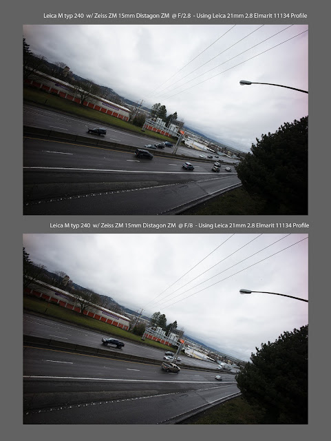

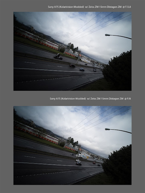

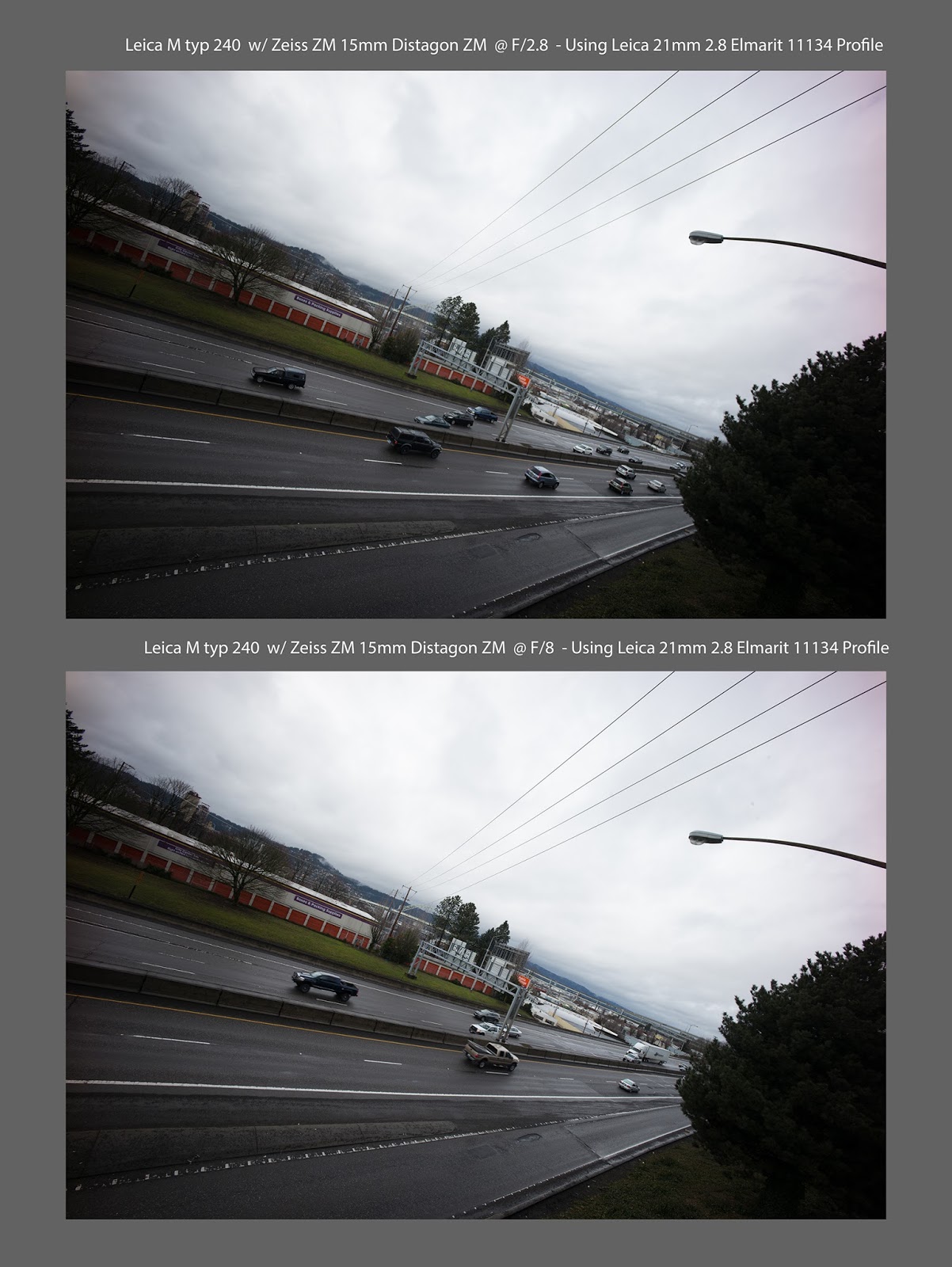

cookedart Posted February 4, 2017 Author Share #44 Posted February 4, 2017 (edited) Here's my own question answered. I've presented the info on a neutral grey background to accentuate the color drift. Sorry, I could have done this more scientific but I don't have the time. I think this is good enough to show the differences in these cameras however. Leica M10 w/ Zeiss 15mm Distagon ZM using Leica 21mm 2.8 (11134) Profile: Higher Res Here Leica M typ 240 with Zeiss 15mm Distagon ZM using Leica 21mm 2.8 (11134) Profile: Higher Res Here Sony A7S (Kolarivision Modded) with Zeiss 15mm Distagon ZM: Higher Res Here Thoughts on the Zeiss 15mm ZM: On M10 - Corner drift looks very well controlled at both F/2.8 and F/8. Some very slight magenta drift but not really field relevant. 9/10. On M typ 240 - Corner drift is definitely noticeable at the vertical edges of the frame. 6/10. On A7SK - Looks like some cyan drift is present but not overly field relevant in this particular case. 8/10. Edited February 4, 2017 by cookedart 2 Quote Link to post Share on other sites More sharing options...

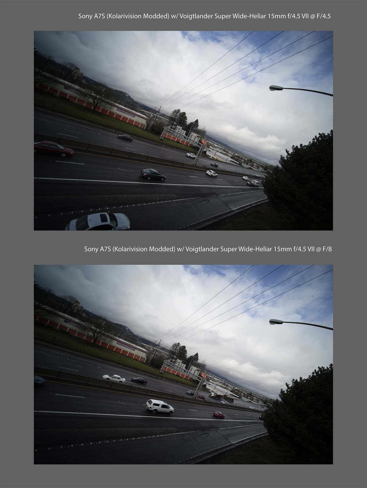

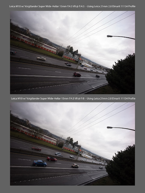

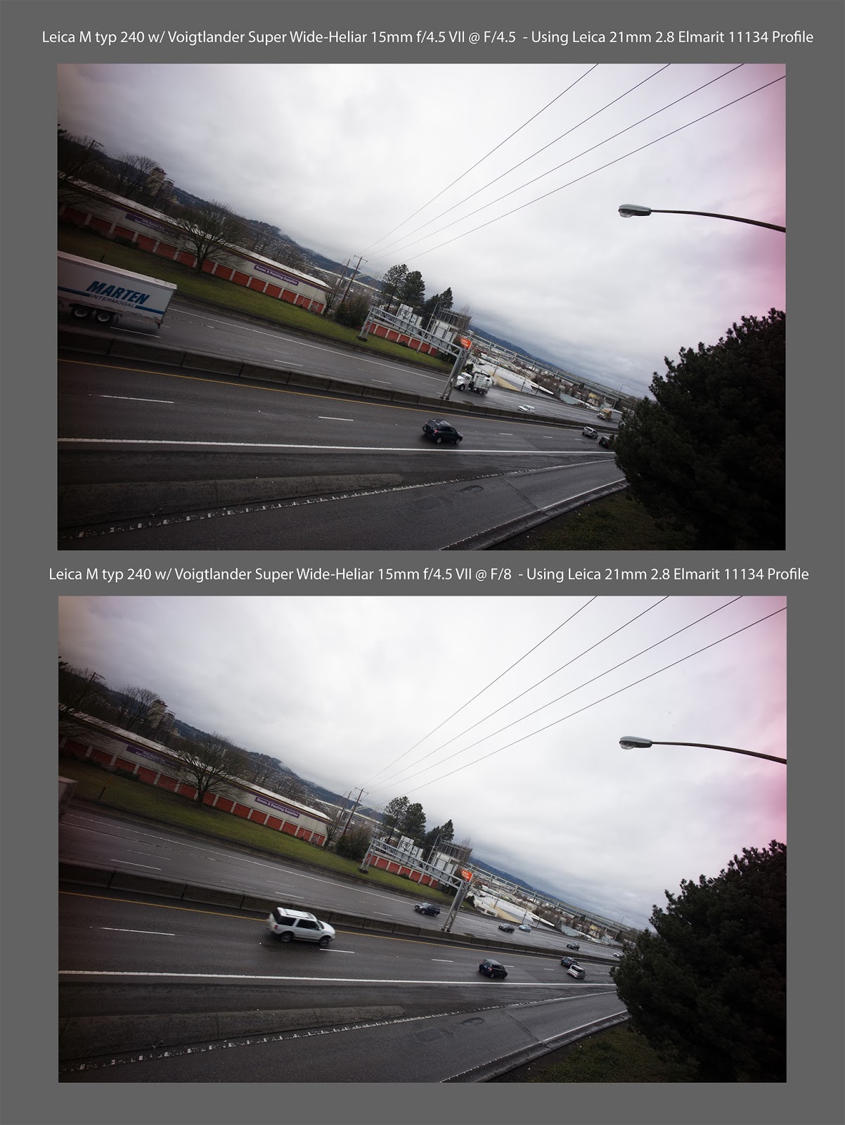

cookedart Posted February 4, 2017 Author Share #45 Posted February 4, 2017 Leica M10 w/ Voigtlander Super Wide-Heliar 15mm f/4.5 VII using Leica 21mm 2.8 (11134) Profile: Higher Res Here Leica M typ 240 w/ Voigtlander Super Wide-Heliar 15mm f/4.5 VII using Leica 21mm 2.8 (11134) Profile: Higher Res Here Sony A7S (Kolarivision Modded) w/ Voigtlander Super Wide-Heliar 15mm f/4.5 VII: Higher Res Here Thoughts on the Voigtlander 15mm: On M10 - Magenta corner drift is noticeable on vertical edges of frame. 6/10. On M typ 240 - Corner drift is pretty extreme here. 3/10. On A7SK - Looks like some cyan drift is present but not overly field relevant in this particular case. 8/10. 4 Quote Link to post Share on other sites More sharing options...
cookedart Posted February 4, 2017 Author Share #46 Posted February 4, 2017 Some conclusions I can make so far: The M10 definitely has more controlled magenta color drift than the M typ 240. I tried other profiles like the Wide Angle Tri Elmar 16mm, but the 21mm coding seemed to have the best results. Unfortunately these are the only drift-prone lenses I own currently. Unfortunately I made a focusing error with the 15mm ZM so comparing across the frame sharpness is difficult with these tests. Comparing the Voigtlander at F/4.5 at full screen on my monitor made the M240 and M10 look almost identical in terms of edge to edge corner sharpness. The A7S clearly had some corner smearing at the very edges of the frame and seems to expose very differently than the Leicas. So while the Sony's cyan drift seems to not be an issue with this kind of photography (for me anyways), the lack of edge to edge sharpness is definitely an issue. The M10 in my mind is definitely the most stable digital shooting platform for M lenses created so far. 3 Quote Link to post Share on other sites More sharing options...

edwardkaraa Posted February 5, 2017 Share #49 Posted February 5, 2017 Thank you for the comparisons! These clearly show that Leica has improved or modified the microlens design from the M240. Very interesting. Quote Link to post Share on other sites More sharing options...
