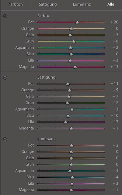

I had the same problem. Try this preset. I can send it to You, if You send me Your Mailadress.

But I do not agree with him that using IR cut filters is useful. I tried but could not see a difference. The use of the Colorchecker wasn´t useful to me too. My profile above is a good starting point, similar to the Colors of C1. If You then play with the Hue-Slider (in German "Farbton") of red You will get good results.
Elmar

I use Lightroom as shown in the post by Elmars.  First I adjust white balance if needed.  Then I adjust red, orange and yellow to get the result that looks most natural to me, and this is confirmed in prints.  Using the colors and luminance sliders, you can find the settings you like and save them, then adjust further if needed.  It does not take long.  Thorsten Overgaard discusses this in his LR tutorial.

When I made a Profile with the colorchecker (same with SpyderCheckr) the skintones stayed as bad as before. The improvement started, when I corrected the Red-Hue Slider by Hand.
I quite agree with this.
These days I can almost always get it right simply by moving the red-hue slider to the right - the amount varies, so it's hard to make a profile, on the other hand, if it works for you it's pretty simple.
