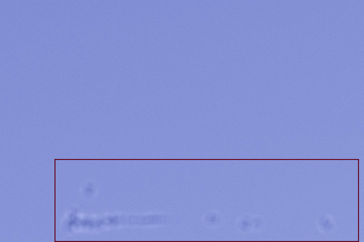

relms Posted July 30, 2016 Share #35 Posted July 30, 2016 (edited) David, Here is a 100% crop of a small section of the DNG file that my dealer used to confirm corrosion. This crop was taken from the bottom edge of the image. There are a couple of similar spots elsewhere on the sensor, but this crop depicts the largest concentration of them. Welcome, dear visitor! As registered member you'd see an image here… Simply register for free here – We are always happy to welcome new members! Edited July 30, 2016 by relms 1 Quote Link to post Share on other sites Simply register for free here – We are always happy to welcome new members! ' data-webShareUrl='https://www.l-camera-forum.com/topic/250548-s2-sensor-corrosion/?do=findComment&comment=3087852'>More sharing options...

Deliberate1 Posted July 30, 2016 Share #40 Posted July 30, 2016 (edited) David, Here is a 100% crop of a small section of the DNG file that my dealer used to confirm corrosion. This crop was taken from the bottom edge of the image. There are a couple of similar spots elsewhere on the sensor, but this crop depicts the largest concentration of them. Many thanks. While my test images do not show the interconnected string of artifacts, there are several specks in a concentrated area that have a dark center with a lighter halo - like a fuzzy ring around a black moon. I tried to post the image which was rejected. I will try again, perhaps in a different format. Sorry to hear about your struggles. We Leica owners do suffer for our devotion to these devices. Perhaps like those "high maintenance" people in our lives that we love despite the frustrations. Because when they are good they are very, very good. Cheers David Edited July 30, 2016 by Deliberate1 Quote Link to post Share on other sites More sharing options...
