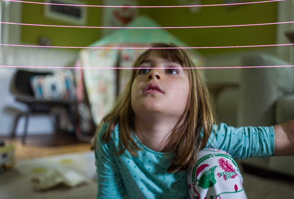

dangorange Posted September 24, 2015 Share #1 Posted September 24, 2015 Advertisement (gone after registration) Apologies that this (hopefully) is not an issue with the Q, but perhaps with the SD card I'm using which has not had any issues. But this is really weird... Yesterday I took around 75 photos mostly of my daughter over the course of the day. When I view them in the camera's LCD, everything looks fine. I just bought an SD card reader and used it for the first time. When I started viewing the photos, I noticed that only on the DNG files, these odd magenta bands started to populate most of the images. Some have several, some only one, but the DNG files are essentially ruined(I think) When I mean populate, the photos looked ok and then it was as if they were becoming corrupt while viewing in Bridge. I was hopping it was a bad transfer with the SD reader, so I connected using the Q directly to my computer and got the same thing. It's not every photo, but the majority, and again, ONLY the DNG files, jpgs are ok, but unfortunately I have the lowest resolution set for jpgs. The photos still look ok in the Q's display, I don't know what to think. I'm going to continue to research on line but thought I'd see if anyone might have insight, this is really a bummer:( Quote Link to post Share on other sites More sharing options...

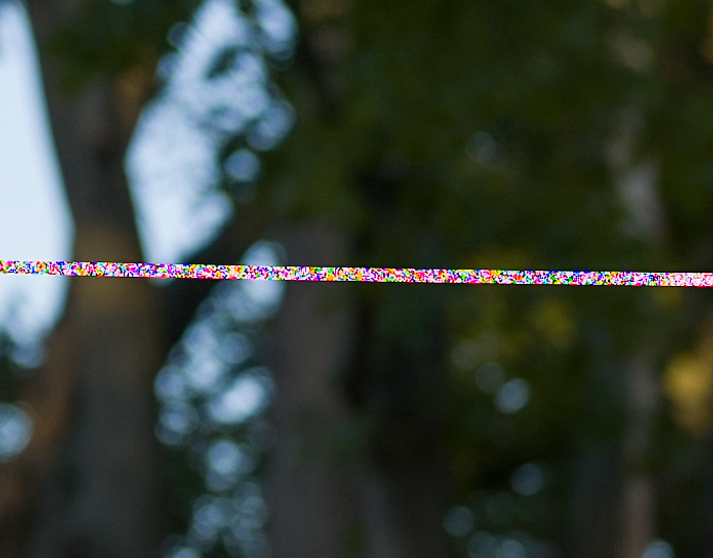

dangorange Posted September 24, 2015 Author Share #3 Posted September 24, 2015 Here's a crop at 200% looks like digital noise, now I'm worried about the sensor. It's very inconsistent. Quote Link to post Share on other sites More sharing options...
mjh Posted September 24, 2015 Share #4 Posted September 24, 2015 (edited) Here's a crop at 200% looks like digital noise, now I'm worried about the sensor. Indeed you should. I guess that either the sensor (or another electronic component) or the card are at fault. You could try a different card or saving full-resolution JPEGs. If the sensor is the culprit the issue should be apparent in full-resolution JPEGs as well, and look about the same. If it is the card then there may be artefacts in JPEGs, but these would look totally different. Edited September 24, 2015 by mjh Quote Link to post Share on other sites More sharing options...

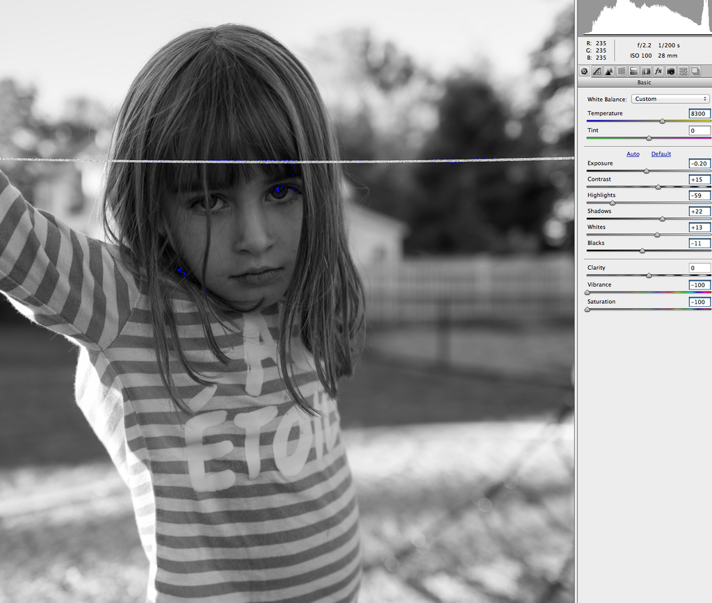

dangorange Posted September 24, 2015 Author Share #6 Posted September 24, 2015 (edited) I put a file up in my dropbox with the DNG issue, the jpeg and a screen grab showing what I see on my end. If anyone wants to check it out themselves. I talked to the store I bought the Q from and sent them some images as well. https://www.dropbox.com/sh/twlne6ny9u8skcc/AABkEqaTMVX6YgVevjToLJcta?dl=0 Another odd thing I found was blown blue areas, there's a screen grab in the the folder demonstrating this. Not only that, when I pull saturation all the way down while processing, the blue stays. Edited September 24, 2015 by dangorange Quote Link to post Share on other sites More sharing options...
mjh Posted September 24, 2015 Share #7 Posted September 24, 2015 Advertisement (gone after registration) Parts of the DNG file are garbage (a hex editor shows large blocks of FFFF) but the question is why. You should try another card – if the problem persists then it’s a camera issue. Quote Link to post Share on other sites More sharing options...

CharlesL Posted September 24, 2015 Share #11 Posted September 24, 2015 I downloaded your L10000359 package. The DNG when opened in Raw Therapee has the pink band. When the viewer program Fast Stone opens the DNG, it displays by default the embedded JPG - no problem. But FS can then be told to open the DNG, and the raw image has the pink band.(You can also tell the DNG from the embedded JPG by whether or not the camera has applied distortion correction, especially at the left edge of this shot.)I doubt that the in-camera JPG engine removes a pink band. Something corrupted the DNG after the camera made the JPG; the crux is in the history of the DNG from a moment after the camera used and stored it until...? Quote Link to post Share on other sites More sharing options...
mjh Posted September 24, 2015 Share #12 Posted September 24, 2015 I have checked with both Lightroom and Iridient Developer and both show the issue (also the hex editor as mentioned before), so those files are definitely damaged. Quote Link to post Share on other sites More sharing options...

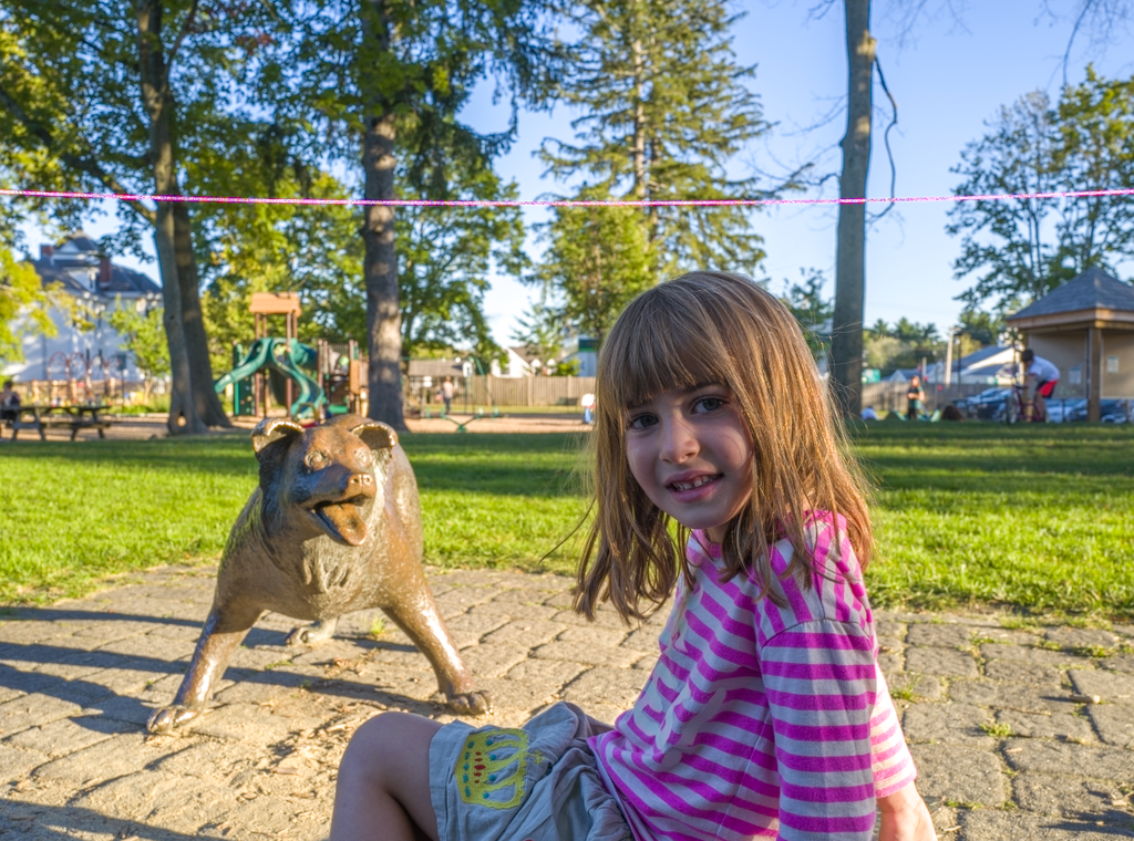

jaapv Posted September 25, 2015 Share #15 Posted September 25, 2015 But if it is indeed the reader + Bridge, however unlikely, Pico? A simple test is to lock the card before inserting - something that is a good idea in general- and see what happens to the file. Another thing is that these lines appear to be bent, which suggests that they are somehow related to the distortion correction, which would point at the camera software. 1 Quote Link to post Share on other sites More sharing options...
jaapv Posted September 25, 2015 Share #16 Posted September 25, 2015 Here's a crop at 200% looks like digital noise, now I'm worried about the sensor. It's very inconsistent. That does not really look like a sensor fault, more like a read/write error or otherwise corrupted data in the file. Quote Link to post Share on other sites More sharing options...
mjh Posted September 25, 2015 Share #17 Posted September 25, 2015 Another thing is that these lines appear to be bent, which suggests that they are somehow related to the distortion correction, which would point at the camera software. When the correction isn’t active those line are straight; with the correction active they are bent. The issue exists in either case. 1 Quote Link to post Share on other sites More sharing options...
