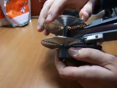

rpavich Posted August 15, 2015 Share #1 Posted August 15, 2015 Advertisement (gone after registration) Well...I decided to try my hand at developing at home. I got everything ready and thought it would go reasonably smooth but... The ONE thing that I didn't check out well enough was how to load the reel, but when I realized that I was committed inside my changing bag so I figured, the worst that could happen is that I'd ruin the film. Well, I did. I had a really hard time getting it ON the reel, and wasn't sure how tight it should be but after I was done developing, I looked up a YT video and oh boy....waaaaaayyyyy too tight. So I finished it and it's drying but it's really bad. It will become my practice film when it's dry. One question; do you like the steel reels or the "quick load" plastic ones? The quick load plastic ones (that ratchet) seem much easier for a noob like me. It was a good experience over all, it gave me an idea of what I'd need to do as far as the rest of the steps. One thing I'll mention also, my changing bag is only 16" x 17" and it seemed really cramped. My instinct is to buy a bigger one that's sort of a pop-tent design but I'm wondering if that's just a knee jerk reaction to my experience? Quote Link to post Share on other sites More sharing options...

Michael Hiles Posted August 15, 2015 Share #2 Posted August 15, 2015 I load reels in a dark cupboard – works fine. I have never been a fan of changing bags – they seem cramped to me. Keep your ruined film and practice, practice, practice. Steel or plastic both work fine. No one markets a product that just doesn’t work. You need to practice with whatever you have, and get comfortable and competent in the light. I worked for years with plastic Jobo reels and tanks that did not have a rachet system – the always reels must be dry, and the corners of the film have to be trimmed so there are no sharp, square corners to catch. But that is all by the way – just practice with your ruined film. And never, never, never etc. give up. You will get it fairly quickly. Quote Link to post Share on other sites More sharing options...

pico Posted August 15, 2015 Share #4 Posted August 15, 2015 I load reels in a dark cupboard – works fine. [...] Steel or plastic both work fine. No one markets a product that just doesn’t work. The cupboard or closet works. Before rebuilding the darkroom I would close the door upon a large heavy cotton cloth to assure darkness. I prefer stainless steel reels because they clean and dry easily, and the plastic reels do not work in a Senrac dryer. Quote Link to post Share on other sites More sharing options...
Mark Pope Posted August 15, 2015 Share #5 Posted August 15, 2015 I used to find that when I cut the film leader off, it was well worthwhile snipping off the right-angled corners at 45 degrees. It made loading much. much easier. 3 Quote Link to post Share on other sites More sharing options...
semi-ambivalent Posted August 16, 2015 Share #6 Posted August 16, 2015 Absolutely get a bigger changing bag. Then find a piece of what here in the States used to be called shirt cardboard (card stock?). Mine is 7 inches by 36 inches and I have a large bag from Freestyle. You can look it up to find its dimensions and adjust for whatever size bag you end up buying. Push the card into the bag so that it is forced to bow up in order to fit, front to back. Be careful not to let it crease, it should do fine. Loading will be much easier with the tented space. You've already invested in the reels you have; don't re-spend it. I prefer the steel ones because I can re-load them while they're still wet from the last film. And don't underestimate the value of struggle. s-a Quote Link to post Share on other sites More sharing options...
TomB_tx Posted August 17, 2015 Share #7 Posted August 17, 2015 Advertisement (gone after registration) Film stock today seems to be thinner and more flexible than back in the 60s & 70s, and I found it harder to secure the end in the center of my old Nikor reels. A friend had given me a cole of Hewes reels which have a pair of prongs in the center that hook the sprocket holes and make loading much easier. Also, "waste" a roll and practice loading first in the light, then in the changing bag. Once you get the feel of it, even with today's films, it is easy. Quote Link to post Share on other sites More sharing options...
fotohuis Posted August 17, 2015 Share #8 Posted August 17, 2015 It is normally a problem when the plastic reel is not completely dry. Suffering too long in a changing bag it is getting worse. I am using the Jobo system 15xx and 25xx. You can föhn them just before use to be sure they are really dry. They are made of Makrolon. Paterson is Nylon, they block quickly when just a little bit wet and the small ball bearings can get stuck by Calcium in the water and then the system is not working anymore. For the rest: Just practice. For 35mm film the problem is mainly at the end. For 120 roll film can be curly they popped off the reel. Also the material which the film has been made can be different: Tri-Acetate (normally used in 35mm) or Polyester (roll films) and their thickness resp. 125um, 100um. But never force a film on the reel because it will end badly. Quote Link to post Share on other sites More sharing options...

bocaburger Posted September 8, 2015 Share #16 Posted September 8, 2015 (edited) I have used the ratcheting plastic reels with good results provided it was dry as a bone. I had mixed results with standard stainless reels even with the little curving metal apron thingy, even with repeated practicing in the light, so I never attempted using them for exposed film. What I use to this day (not sure if they're still manufactured but probably available used) are the Kinderman reels. Those have a sharp prong in the center (or a clip in the case of the 120's) and a little tab on the outermost spiral. There is a plastic loading jig with an apron to guide the film, it has a rod that goes through the center of the reel. You then simply grab the little nub on the reel and turn it like a crank. Film loads in a few seconds, never once had a misload. I also have one of the loading jigs with a base that sits on the table (got it used and never saw another one like it). As for changing bags, I have a couple, but what I use is a Photoflex Changing Room. It's like a tent that springs open and sits on a countertop, has a zippered opening and sleeves like a changing bag but it doesn't collapse over your hands. Very nice to work in. Edited September 8, 2015 by bocaburger 1 Quote Link to post Share on other sites More sharing options...
rpavich Posted September 10, 2015 Author Share #17 Posted September 10, 2015 I have used the ratcheting plastic reels with good results provided it was dry as a bone. I had mixed results with standard stainless reels even with the little curving metal apron thingy, even with repeated practicing in the light, so I never attempted using them for exposed film. What I use to this day (not sure if they're still manufactured but probably available used) are the Kinderman reels. Those have a sharp prong in the center (or a clip in the case of the 120's) and a little tab on the outermost spiral. There is a plastic loading jig with an apron to guide the film, it has a rod that goes through the center of the reel. You then simply grab the little nub on the reel and turn it like a crank. Film loads in a few seconds, never once had a misload. I also have one of the loading jigs with a base that sits on the table (got it used and never saw another one like it). As for changing bags, I have a couple, but what I use is a Photoflex Changing Room. It's like a tent that springs open and sits on a countertop, has a zippered opening and sleeves like a changing bag but it doesn't collapse over your hands. Very nice to work in. Interesting! I never heard of this. I do use this changing bag now...it's so much better than my small changing bag was. Thanks for the info. Quote Link to post Share on other sites More sharing options...
tobey bilek Posted November 14, 2015 Share #18 Posted November 14, 2015 (edited) I have no trouble with my Nikkors from 1960 with T Max, Delta, or Kodak IR which is about as thin and flimsy as possible. I have a look alike Nikor that will not grab the end of any film. Center hole accepts my finger, real Nikons do not. Constructions looks same exactly. The trick is to start the film, go three wraps, push some into be sure film is loose and in channel, couple more wraps, push in. If film skips out, it will not push. Un wrap and try again. I put the reel on the bench with the outer wire wrap clockwise ending at 7:00. Notch to accept film is at 12:00. Push in end, load clockwise. Wrap. push. wrap push. If you try counterclockwise, it will not load period. Practice with ruined film in daylight. There are many knock off Nikons that are not worth zip. Brooks, Prinz, and a few others. Real Nikkors have no ID on them, so that makes buying used hard. Also one bent out of parallel will not load. Edited November 14, 2015 by tobey bilek Quote Link to post Share on other sites More sharing options...
