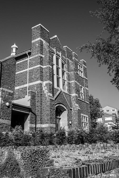

pgk Posted June 7, 2015 Share #24 Posted June 7, 2015 Here's a shot taken today with my 28mm v.2 lens at about f/11 on my M8. Not at all bad for an old and not too well thought of lens on a digital camera with issues (no UVIR filter either and obviously the lens is uncoded). Its pretty sharp, right into the (1.3 crop factor) corners and with a bit of PP both contrast and colour balance are reasonable enough. Considering its cost it will do nicely! Welcome, dear visitor! As registered member you'd see an image here… Simply register for free here – We are always happy to welcome new members! 1 Quote Link to post Share on other sites Simply register for free here – We are always happy to welcome new members! ' data-webShareUrl='https://www.l-camera-forum.com/topic/245582-elmarit-2828-versions/?do=findComment&comment=2829771'>More sharing options...
pgk Posted June 7, 2015 Share #25 Posted June 7, 2015 (edited) And a B&W from the same lens too. Nothing much to complain about performance wise in this shot. Welcome, dear visitor! As registered member you'd see an image here… Simply register for free here – We are always happy to welcome new members! Edited June 7, 2015 by pgk 2 Quote Link to post Share on other sites Simply register for free here – We are always happy to welcome new members! ' data-webShareUrl='https://www.l-camera-forum.com/topic/245582-elmarit-2828-versions/?do=findComment&comment=2829800'>More sharing options...
