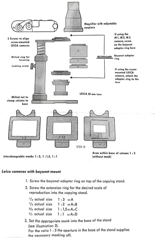

hellerkar Posted July 8, 2017 Share #24 Posted July 8, 2017 Resurrecting this thread, and with a similar question to "suchislife". I received with my Beoon a set of instructions, but in German unfortunately for me. If anyone knows where to obtain the English equivalent, I'd be appreciative. I realise the use is not rocket-science, but I'd still like to get some. Gary I have taken some pictures of the English language version of the BEOON instruction manual for your use and possibly for others on the forum who might be looking to read it. Welcome, dear visitor! As registered member you'd see an image here… Simply register for free here – We are always happy to welcome new members! 1 Quote Link to post Share on other sites Simply register for free here – We are always happy to welcome new members! ' data-webShareUrl='https://www.l-camera-forum.com/topic/230886-m8-and-beoon/?do=findComment&comment=3311106'>More sharing options...
hellerkar Posted July 8, 2017 Share #25 Posted July 8, 2017 I have taken some pictures of the English language version of the BEOON instruction manual for your use and possibly for others on the forum who might be looking to read it. I am sorry these photos are poor resolution....I was unable to put the scanned files up due to size limitations. Or perhaps the limitation of my intelligence......I would be happy to send along a nicely scanned copy to someone who would be able to post it here for community use and reference. It is too nice a day for me to keep sitting inside figuring out how to get this posted. Quote Link to post Share on other sites More sharing options...
a.noctilux Posted July 8, 2017 Share #26 Posted July 8, 2017 Hellerkar, Attached images are low res and file sizes only about 35KB each, 320x240pix. What are the original sizes of your images ? Quote Link to post Share on other sites More sharing options...
hellerkar Posted July 8, 2017 Share #27 Posted July 8, 2017 Advertisement (gone after registration) Hellerkar, Attached images are low res and file sizes only about 35KB each, 320x240pix. What are the original sizes of your images ? 4 images: Size: Dimensions: 1. 1.4 MB. 1992x2816 2. 471 KB. 2350x3066 3. 500KB. 2205x2925 4. 573KB. 1758x2711 Quote Link to post Share on other sites More sharing options...

brentb Posted July 12, 2017 Share #30 Posted July 12, 2017 (edited) Hellerkar has done me a great favour, and emailed me the BEOON manual scans I had been searching for, and asked that I resize and share them here. Please keep these for your own use, and do not redistribute. Unfortunately, the restrictions of this forum require them to be spread over multiple posts, as there is a 500kb limit, and I wanted to keep them as large as possible for clarity. Pages 3 and 4 will follow in next message. Welcome, dear visitor! As registered member you'd see an image here… Simply register for free here – We are always happy to welcome new members! Edited July 12, 2017 by brentb 2 Quote Link to post Share on other sites Simply register for free here – We are always happy to welcome new members! ' data-webShareUrl='https://www.l-camera-forum.com/topic/230886-m8-and-beoon/?do=findComment&comment=3313902'>More sharing options...
