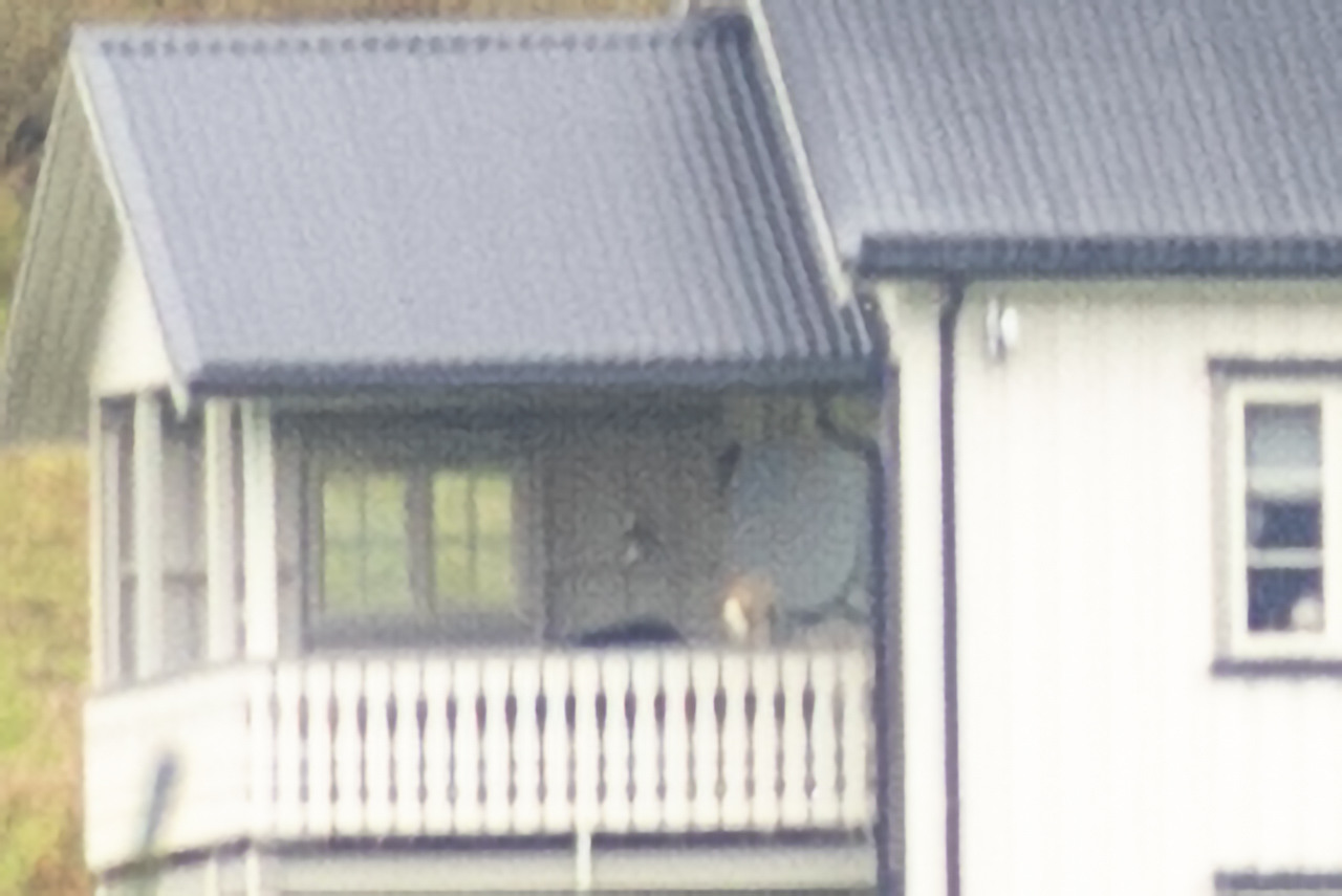

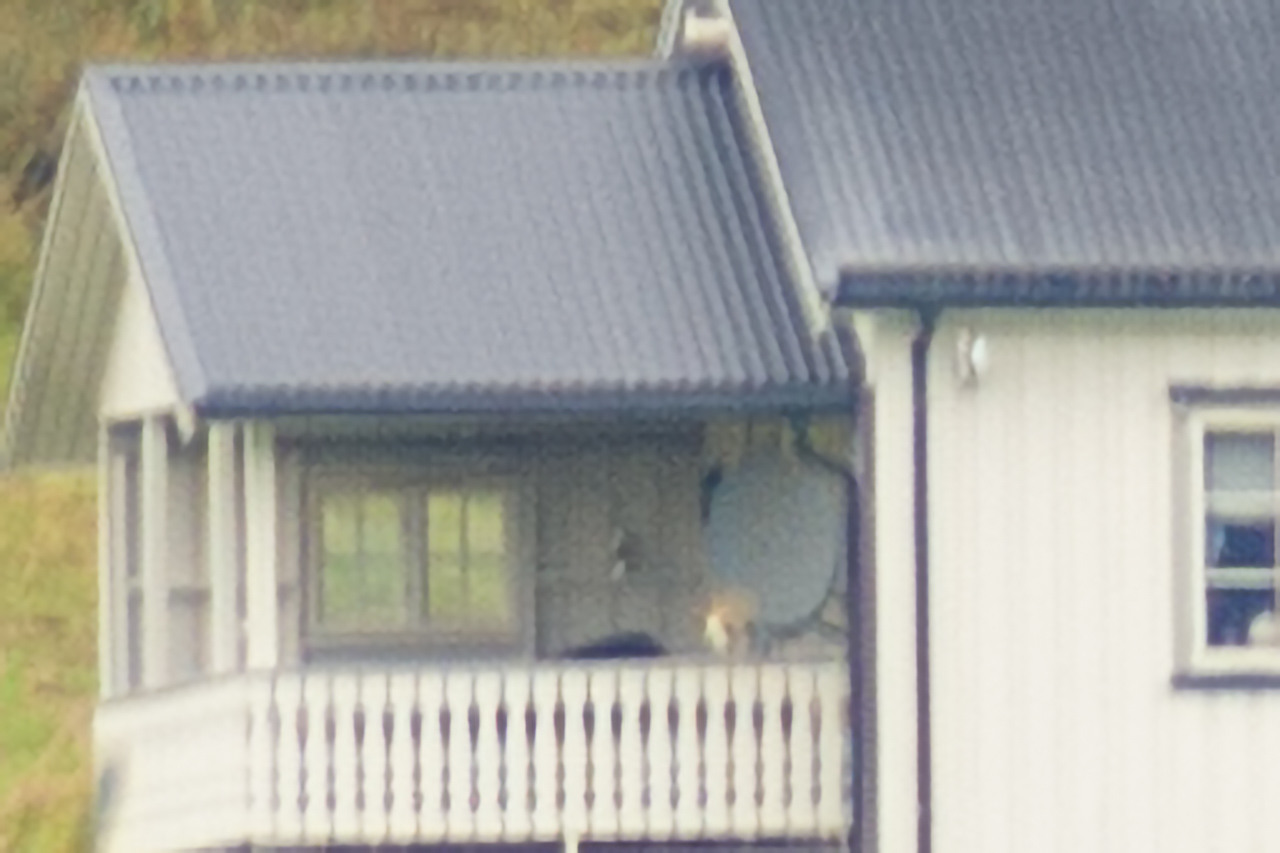

I got a 2X extender recently mainly to use it with my 80mm F/1.4 to get a tele not requiring much light.
The 2X Extender makes the 80mm F/1.4 into a 160 mm F/2.8 according to Leica's website (there is a list of lenses that the APO-extender works with on the website under the APO Extender).
This is not the APO-extender but an older one.
I tested it yesterday and you can see some examples here:
http://www.leica-camera-user.com/other/22834-cirkus-2x-extender-test-80mm-f.html
I find the result a bit milky and hard to get real sharp. I also did some tests with the 50mm F/2.0 which I will post a bit later.

Dear Thorston,
The 1980 2X Extender-R is not worth having. I bought one new and eventually Leitz replaced it for me. I still could not get decent results so sold it.
In 2004 I bought the 2X Apo-Extender-R and am very pleased with it. In the real world I cannot distinguish between it and a prime lens of equivalent focal length.
You might also consider the advice from Leica not to use an extender on lenses faster than f/2.
In your situation, wanting an f/2.8 160mm lens, why not for similar money buy the old classic Apo-Telyt-R 1:3.4/180?
Sincerely,
Justin

Dear Thorsten,
this is not the case. There are obviously some factors limiting the max aperture so practically you would get approximately a 4/160 only. One of them appears to be the diameter of the extender itself limiting the max apperture to 2. Try to close to f2 -> f4 with the extender and see if the results get better.
I use the 80Lux with the APO x2 (both with ROM), close it to f2 and am very pleased (especially if you don't want to carry additional tele lenses.
cheers

I tested the APO and this one and the difference was 1,000 € second-hand and as I couldn't see any difference in sharpness (which was the thing we tested for; with the 80mm you can't get any of them 100% sharp in the standard R8 viewfinder) I took the most economical. With an option to return it.
I'm scanning some concert shots (which was really what specifically bought if for) and it looks as if it just can't handle anything but light from behind. The slightest light into the lens and awfull stuff happens.
I also looked at the 180mm F/3.4 (350 €) and the light edition of the 180mm F/2.8 (390 €) but liked the idea of experimenting with the 2X more at that time.
I feel very tempted to get the 180mm F/2.8 as I'm for as little light as possible but suspect the F/3.4 is better, according to what I have read so far (problem is that I would mostly use a tele indoor; and if outdoor, half the year 100 ISO F/2.0 photography in Denmark is 1/60 - 1/125.

The samples are all F/4.0 as I know F/1.4 - F/2.8 might be troublesome.
What Leica says (about the APO-2X) is that it is for lenses F2 and up, but then lists the F/1.4 and in a way so that I get the idea I 'save' some stops because I have to jump the steps I anyway can't use with it (did that make sense?).
So that means that from F/2.0 the 80mm F/1.4 should be ok.
Anyway, "look, don't think" so I'll do some more tests. The trouble getting the 80mm in focus is well-known, with the 2X it seems an entire different game.
Thorsten

It definitely gives some qualities to the 50mm as a 100mm lens and the 'milky' look that the 80mm shots has is gone (which might be because the 80mm was supposed to be -1EV when photographed).
