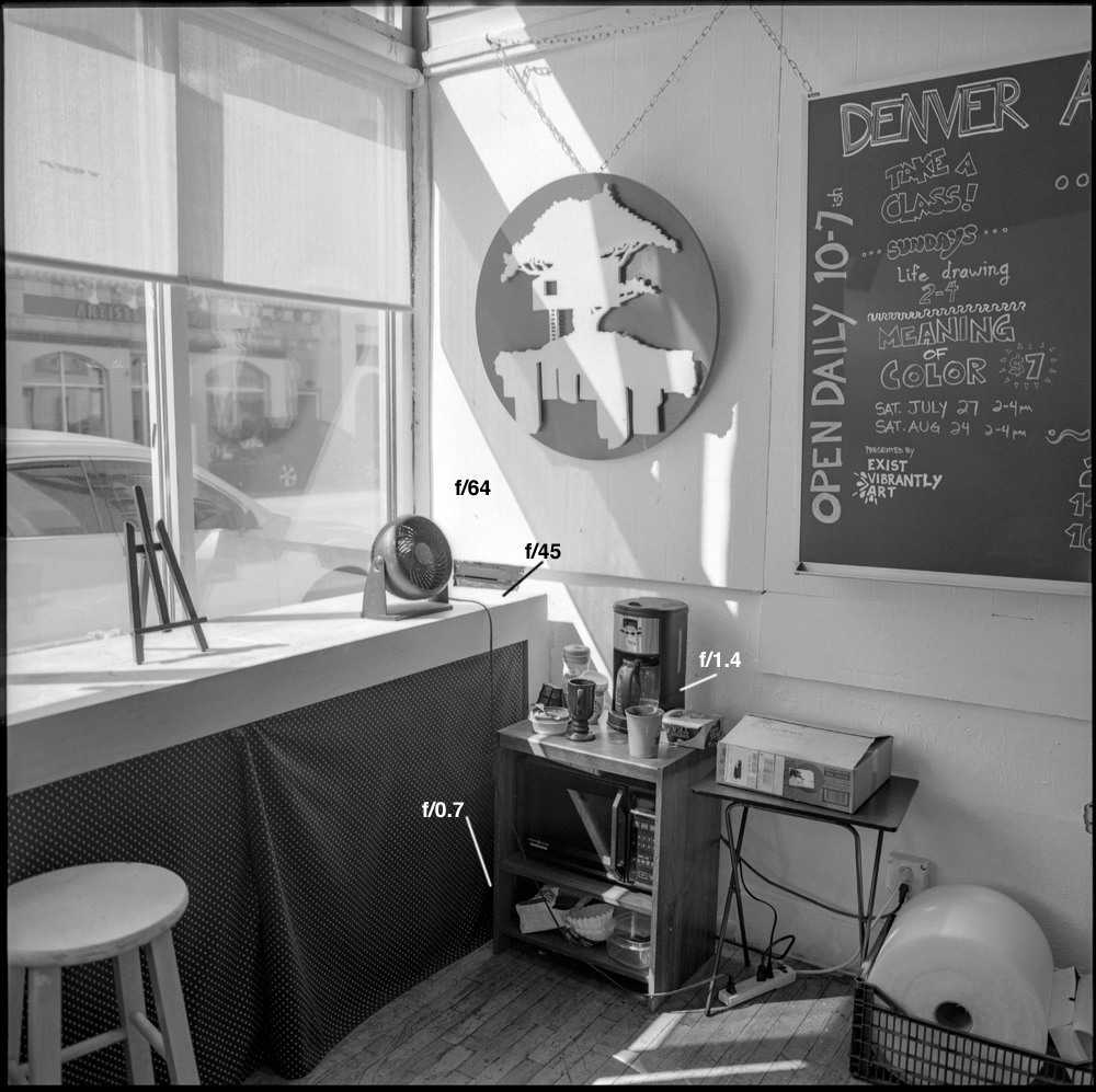

Popular Post adan Posted September 9, 2019 Popular Post Share #63244 Posted September 9, 2019 This is a sunlit image with the same technique as my "Telephone sculpture" indoor picture a few pages back. Mamiya 6, 50mm Sekor, TMax 400 at 400, Rodinal 1:50 with 90-second agitation intervals, 11.5 minutes at 20°C. No clipped shadows except for the black borders, highlights full of detail except for specular reflections. Rodinal at 1:50 (or 1:100) really does do what has been claimed for it for 70 years. Welcome, dear visitor! As registered member you'd see an image here… Simply register for free here – We are always happy to welcome new members! 16 4 Link to post Share on other sites Simply register for free here – We are always happy to welcome new members! ' data-webShareUrl='https://www.l-camera-forum.com/topic/205842-i-like-filmopen-thread/?do=findComment&comment=3816158'>More sharing options...
