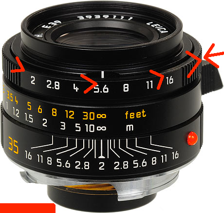

Hey everyone,
I just recently got hold of this beautiful 35 summicron ASPH although i have a slight issue...
The front ring where you clip the hood onto and screw additional filters into spins freely around, this doesn't not seem to be effecting any of the glass elements. I've read a few things of people saying they had the same problem and it's just something inside that needs tightening, screws or something?
I'm normally pretty competent when it comes to fixing things but this is something i don't feel comfortable doing this as i don't want to risk it.
Has anyone else had the same issue?
Thanks.
(i can include diagrams if need be)

Yeah... i think you're probably having the same issue although from the sounds of it i don't think yours is loose enough to spin fully around like mine. Im sure if you gave it enough time it would do the same. From what i can make out it's not threaded because you can turn it many times in each direction without it taking effect. As it's been the weekend i haven't really been able to call repairs and get a good understanding of it's issue but i'll be on the phone tomorrow. Maybe you should get yours checked out sooner before your lens hood is able to turn 360 degree around ha
