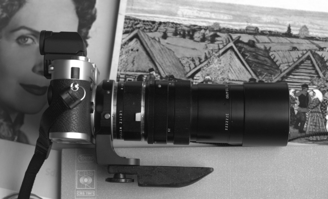

ianbiggar Posted March 15, 2018 Share #64 Posted March 15, 2018 Thanks mmradman. I’m not sure if “not compatible with” means it won’t work or won’t fit! In looking at the rear of the lens it appeared that the problem was the plastic baffle which, sure enough, stopped it fitting. Held on by three little screws. I consulted with Peter at CRR Luton, a lovely man, and although he gave up working on R Cameras some time ago could remember enough to talk me through what I might find and what might happen if I were to undo the three screws and see if the baffle would come out. So - three short (very short) screws later the baffle practically jumped out into my hand. A careful bit of measuring to make sure the front of the extender would not hit the rear element and bingo - it fits! Now whether it’s supposed to, whether it will work, whether the baffle needs to be in place I do not yet know but I got an image. Will look at later, run some more tests and report back. May be possible to find a different baffle to fit the three screw holes or get one 3D printed. Although matte black may have been just to prevent dust getting in?? Ian Quote Link to post Share on other sites More sharing options...

ianbiggar Posted March 16, 2018 Share #66 Posted March 16, 2018 Thanks for that - will let you know how things go. I recognise that just because it fits it doesn’t mean it will work! Ian Quote Link to post Share on other sites More sharing options...
