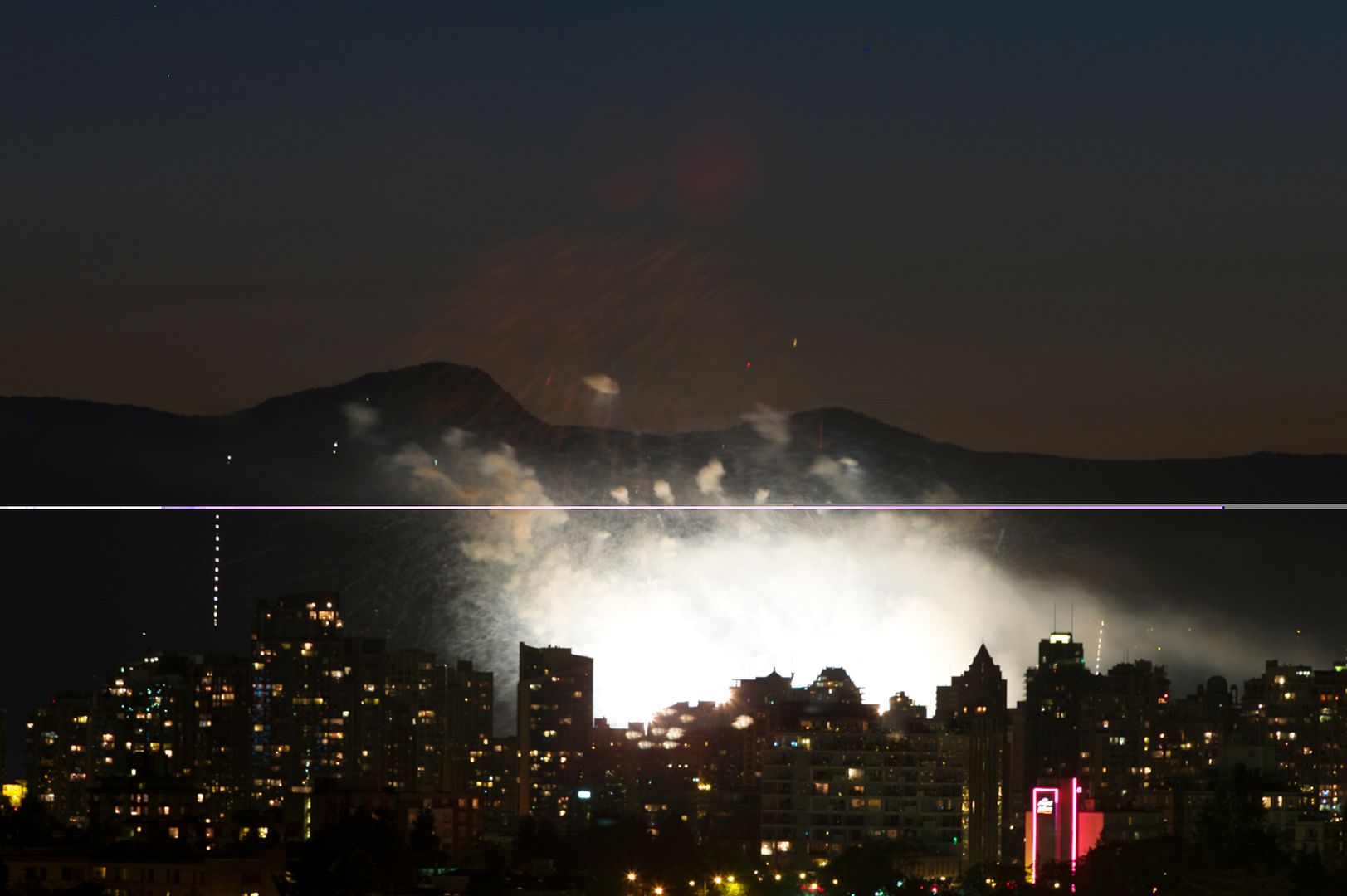

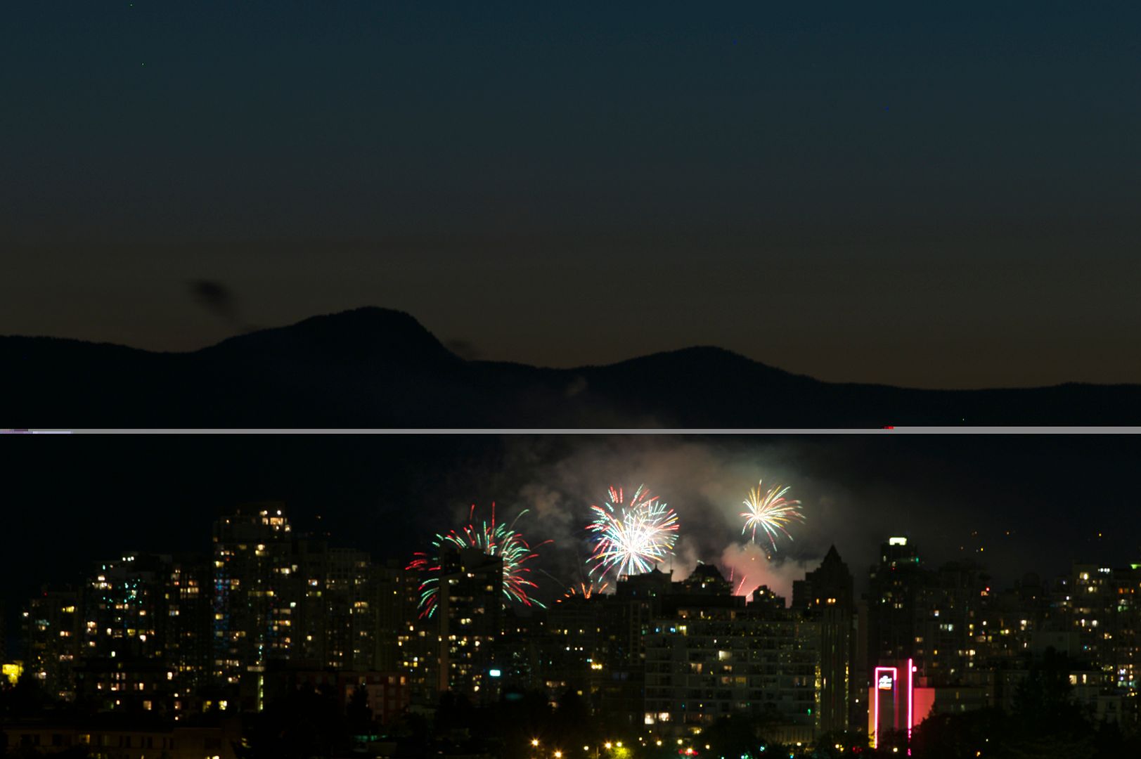

LVSBB6 Posted July 25, 2010 Share #1 Posted July 25, 2010 Advertisement (gone after registration) So I was excited to receive my DMR/R9 back from Leica NJ after a 2 months wait on sensor repair, but after a series of test shots and I found about every 1 of out 6 pictures have these problems after I uploaded and view on the computer. These are JPEG files and seem fine when viewed on the DMR LCD screen, but once you transferred to the computer its obviously not usable. I have tried using different SD cards and battery, but it still gave me same result. I'm quite disappointed as they claimed to have tested and inspected before returning to me. This never happened before to my DMR before I sent back for service. Does anyone know what the issue is? Link to post Share on other sites More sharing options...

andybarton Posted July 25, 2010 Share #3 Posted July 25, 2010 Have you tried shooting RAW? This looks like a failed sensor to me, but as Nicole says, it could be a dodgy card. Email the files to Leica CS in NJ and ask for a rapid response. Link to post Share on other sites More sharing options...
LVSBB6 Posted July 25, 2010 Author Share #4 Posted July 25, 2010 Hi. I believe that the normal cause for most DMR woes is dirty contacts. But if this has just come back from Leica, that should be unlikely. If you put the card back into the DMR and view the pictures, do they still look OK? If so, then the problem could be with your card-reader. Are you able to try a different card-reader? If not, then you might try cleaning the contacts on the card reader and its connections. The pictures appear to be okay when viewing on the DMR, but I have tried viewing the SD card on different computers and still have the same problem. Have you tried shooting RAW? This looks like a failed sensor to me, but as Nicole says, it could be a dodgy card. Email the files to Leica CS in NJ and ask for a rapid response. I tried shooting RAW and TIFF and the files seem to be fine. It only happens with JPEG files so far. Link to post Share on other sites More sharing options...

farnz Posted July 27, 2010 Share #12 Posted July 27, 2010 Sorry to hear about your problem - a camera that only works intermittently is worse than one that doesn't work at all. Point 1: It can't be a faulty sensor because you successfully checked the images on the DMR's LCD screen. If it was me I'd be going "Phew!":o Point 2: For the same reason your DMR's buffer must be okay because (I presume) the review image is written from the buffer to the video memory address field for the LCD. (Otherwise it would have to be written from the SD card to the video memory address field, which would prove the SD card writing process, but the time to write in and write out again suggests that this is unlikely.) Personally I would suspect the SD card writing process since you appear to have eliminated poor contacts. I note that photos 1 and 2 show 'just' a line at roughly the same location, which indicates that the problem rectifies itself whereas in photo 3 it doesn't rectify itself. This may indicate a thermal cut-out that resumes after something cools and returns to operating temperature. Since the photos are of fireworks it suggests that the sensor was exposed and on for a lengthy period, which could contribute to unusual thermal effects. Do you see the same problems when shooting during the day with faster shutter speeds? Incidentally, if you do have to return your DMR to Solms you might like to get them to sort out the hot pixels in the top left at the same time. Pete Link to post Share on other sites More sharing options...
LVSBB6 Posted July 28, 2010 Author Share #13 Posted July 28, 2010 You said you tried several sd cards and different computers. Did you try another card reader? Yes I have tried on difference card readers on my PC and Mac, same result. Sorry to hear about your problem - a camera that only works intermittently is worse than one that doesn't work at all. Point 1: It can't be a faulty sensor because you successfully checked the images on the DMR's LCD screen. If it was me I'd be going "Phew!":o Point 2: For the same reason your DMR's buffer must be okay because (I presume) the review image is written from the buffer to the video memory address field for the LCD. (Otherwise it would have to be written from the SD card to the video memory address field, which would prove the SD card writing process, but the time to write in and write out again suggests that this is unlikely.) Personally I would suspect the SD card writing process since you appear to have eliminated poor contacts. I note that photos 1 and 2 show 'just' a line at roughly the same location, which indicates that the problem rectifies itself whereas in photo 3 it doesn't rectify itself. This may indicate a thermal cut-out that resumes after something cools and returns to operating temperature. Since the photos are of fireworks it suggests that the sensor was exposed and on for a lengthy period, which could contribute to unusual thermal effects. Do you see the same problems when shooting during the day with faster shutter speeds? Incidentally, if you do have to return your DMR to Solms you might like to get them to sort out the hot pixels in the top left at the same time. Pete I have tried shooting in broad daylight with fast shutter in sequence, it still has the same problem and in most cases the pictures are the similar as photo 3 with large greyed-out area. My DMR is on its way back to Leica NJ to have this sort out, as well as the hot pxiel issue which it supposed to be fixed last time during repair, but apparently still hasn't completely resolved... Link to post Share on other sites More sharing options...
