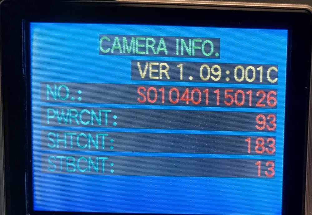

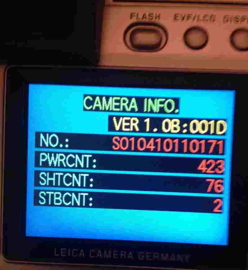

pitti Posted June 6, 2010 Share #1 Posted June 6, 2010 Advertisement (gone after registration) Hello, ok, here there are. At your own risk. For me it works fine. :-) 1) Make sure that you have insert a full battery in your D2! Put a sd-card into the slot and make some pictures. Turn the power "Off". 2) Set the mode dial to "Single picture". 3) Press "Flash" (the small button on the right top of the cam) and "Up" on the cross key simultan, hold them and turn "On" the power. 4) Press simultan "Flash", "Menu" and "Left". Now you are at the error code memory screen. 5) Press simultan "Flash", "Menu" and "Left" again and whoops here are the most interesting infos. The camera information is interpreted below: VER 1.0B : 001D -> Firmware version is 1.0B. NO.: S010XXXXXXXXXX -> A 12-digit number with a "S" prefix. (Motherboard serial number?) PWRCNT: 834 -> Power On Count, the number of times camera turned on. SHTCNT: 5873 -> Shutter Count, the number of times shutter fired. STBCNT: 80 -> Strobe Count, the number of times flash fired. 6) Turn "Off" the power. This procedure works also with the lumic lc1. Have fun :-) Regards Peter 3 Quote Link to post Share on other sites More sharing options...

dugby Posted June 8, 2010 Share #3 Posted June 8, 2010 Awesome - Thanks for that. There has been talk on this forum about two firmware levels. Now there is proof. My firmware is 1.0A Quote Link to post Share on other sites More sharing options...
elgenper Posted June 8, 2010 Share #4 Posted June 8, 2010 Awesome - Thanks for that. There has been talk on this forum about two firmware levels. Now there is proof. My firmware is 1.0A Even more confusion.... Mine is Ver 1.09:001C It had its sensor replaced about a year ago. Quote Link to post Share on other sites More sharing options...
jvan01 Posted June 8, 2010 Share #5 Posted June 8, 2010 Even more confusion.... Mine is Ver 1.09:001C It had its sensor replaced about a year ago. Mine is 1.09:001C as well. The camera was sent in for sensor replacement by the previous owner. Quote Link to post Share on other sites More sharing options...

ASpes Posted June 8, 2010 Share #7 Posted June 8, 2010 (edited) Advertisement (gone after registration) Thanks Pitti, after years this has surfaced at last. Really thanks. Mine shows ver. 1.0b:001d for the firmware. I bought this camera used in late 2006, if I'm not wrong, and AFAIK sensor has *not* been replaced. Actually I remember all the alarm about this issue came up a while after I got it. Btw, this info shows that I probably mixed up cards with one of the other D/2's I had, as the picture numbering shows a count of 4.885 while it displays just 3.715 with your method. Now, Pitti, any chance you can get this info for the Digilux 3 too? Tried this one, sort of as button layout is different, but could not get it to work. Thanks again. Edited June 8, 2010 by ASpes Quote Link to post Share on other sites More sharing options...

Pol-Alexandre Posted June 12, 2010 Share #13 Posted June 12, 2010 Many Thanks, Pitti ! Works good ! Very precise ! My Camera says : Ver 1.0B.001D Nr S02 04 09 15 0078 PWRCNT 2129 SHTCNT 4898 STBCNT 1543 These counters are active The number can be read as follows : S02=prefix Date 04 09 15 = 15 sept 2004 0078 is a sequence nr (infos match well with ME program) On my camera the sensor was replaced in Solms in May 2007 but apparentlly they did not reset the counters. I have downloaded the DMC-LC1 Service Manual- Interesting ! Quote Link to post Share on other sites More sharing options...
guzzipap Posted June 14, 2010 Share #14 Posted June 14, 2010 Wow, works great, V1.0B:001D Nr S02 04 07 18 0229 Pwrcnt 3299 Shtrcnt 12787 ! Stbcnt 1808 I don't know if the sensor has been replaced. Charles Quote Link to post Share on other sites More sharing options...
