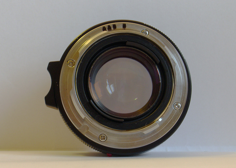

Proof of concept regarding self coding of lenses
/applications/core/interface/imageproxy/imageproxy.php?img=http://static.flickr.com/118/309102421_6683080fe1_o.jpg&key=ae55062a8eb94117b1b59c875a71d5fb82d8afbaa906ad500e63930403d99178">
With nothing more than a sharpie I was able to trick my M8 into thinking my Zeiss 21 was really a 50mm Leica lens. Of course this isnt for any practical purpose except to prove it's possible with little or no tools.
