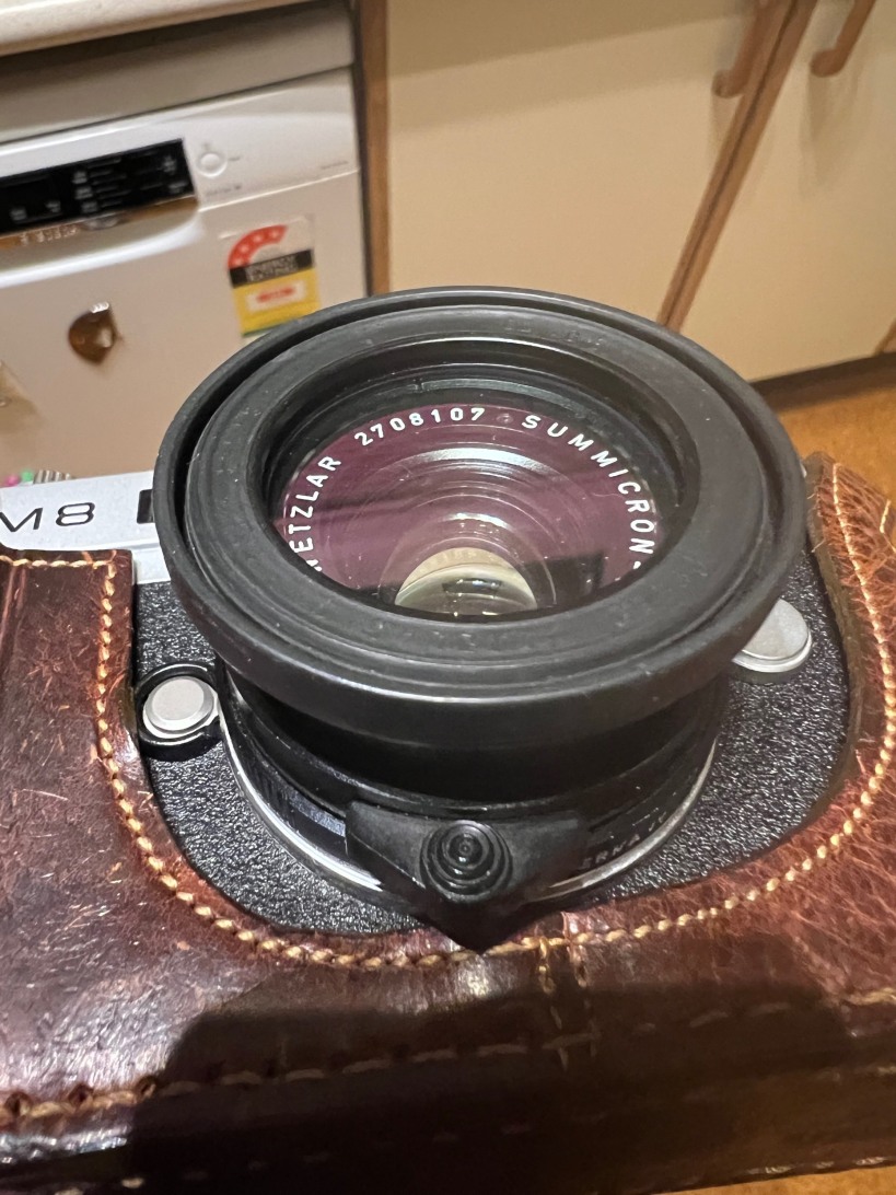

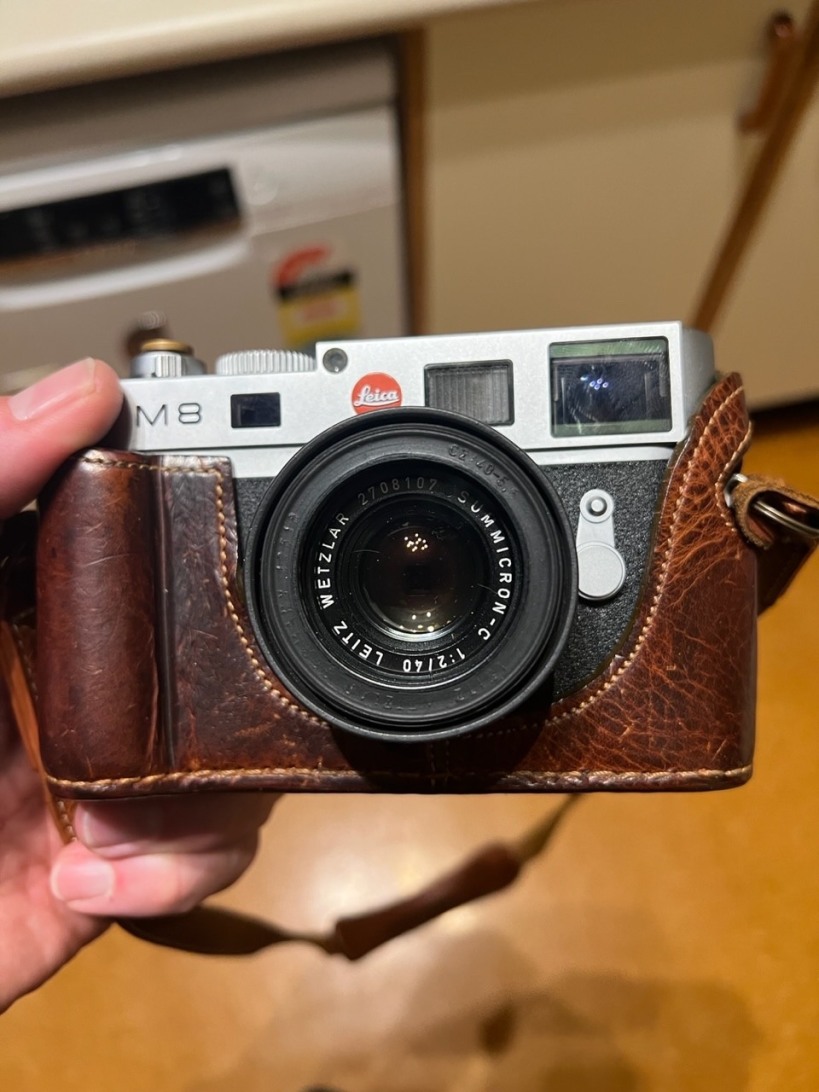

Naampje Posted January 11, 2017 Share #38 Posted January 11, 2017 Thanks Ict for your idea! I decided I would try to keep the hood intact and to work on the filter glass instead. I just took out the glass Leica filter and with a small sander, a 150 grid paper it took just a few minutes for it to 'click' into place. No need for rings or glue, just take the filter in your hand and slowly turn it while sanding the egdes. This way it stays nice and round and if you take just a bit of with a little pressure it stays perfectly in place. 1 Quote Link to post Share on other sites More sharing options...
Naampje Posted January 11, 2017 Share #39 Posted January 11, 2017 (edited) Some questions... Are there any disadvantages in using this filter permanently on the M8? I thought I noticed a little light loss.i The thinner IR filter supposedly improves the pictures in B/W, so I thought about keeping it of when shooting B/W. The only reason you put it on the M8 is in colour photography the magenta/purple colour and greens going yellowish because of IR contamination right? So no need I would say? Also, now with this IR cut filter installed, how does the M8 compare to other camera's out there? Is it still more sensitive to IR or is it now like other digital bodies? Edited January 11, 2017 by Naampje Quote Link to post Share on other sites More sharing options...
